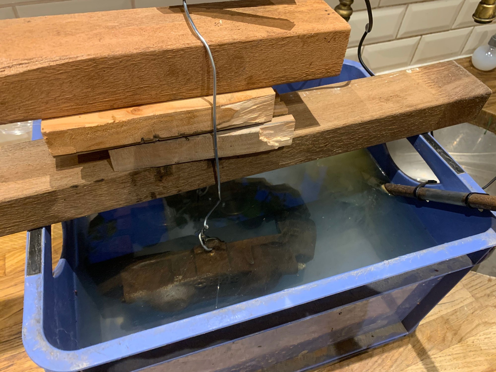

I'm planning to remove rust from my brake calipers using electrolysis prior to detailing them.
Anyone have experience with this? Is this a no-no on calipers ?

The calipers seem to have mostly surface rust. I'd like to paint them red or yellow ???
I am thinking a plastic vat with 3 gallons of water, 3 TBS of laundry soda, sacrificial steel, and a car battery charger.

Yep , I did some trailing arms using Bi carb soda , cant remember the amounts , but it worked well . you will have to move the sacrificial steel around to get "line of sight "on the pieces so it will take a while .
Kind of interesting to watch , as soon as you turn on the power ,lines of tiny bubbles come off the pieces , carrying all the corrosion .
Going out to the shed the next morning and the tub had a heavy rust scum on the surface .
