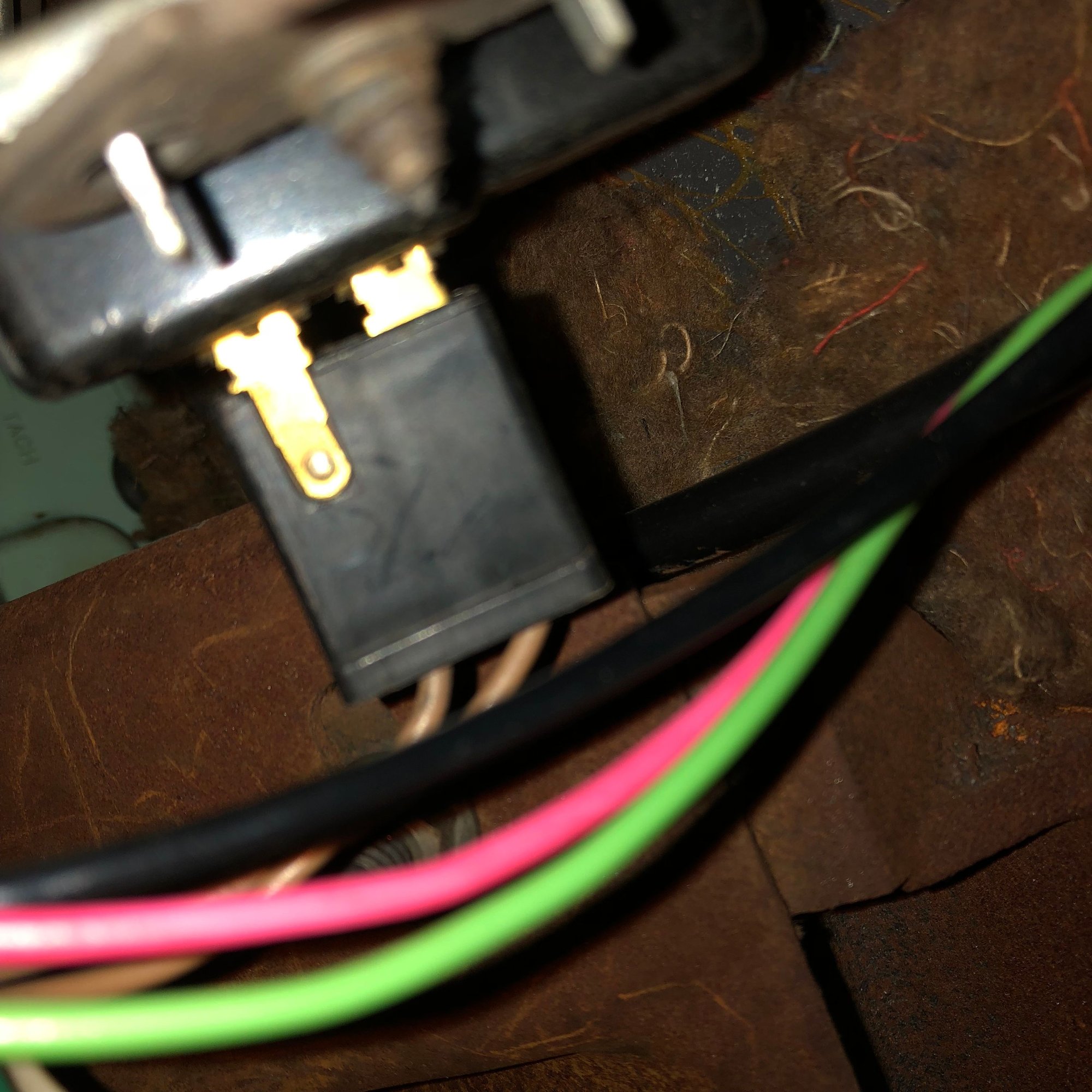

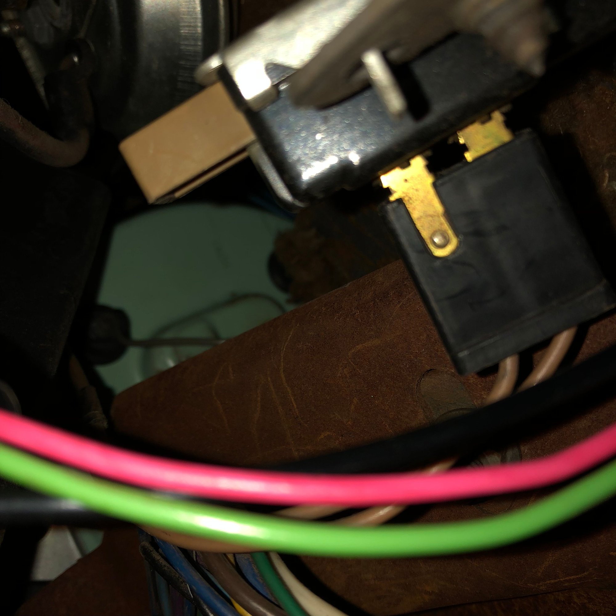

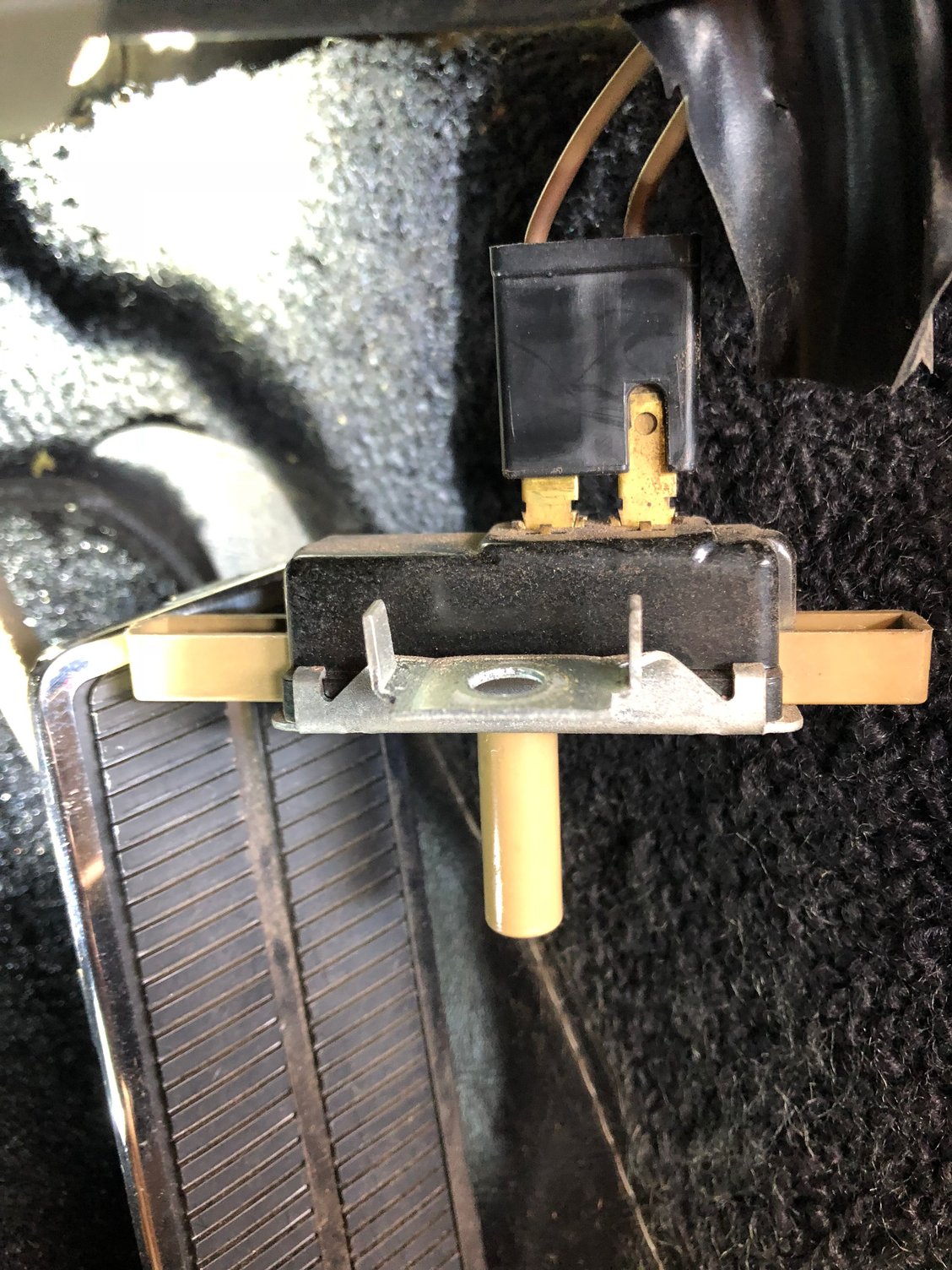

Here are a few pictures from my 73 for the cowl induction. I had to put a big *** rubber hose piece on the shaft so the switch would make at WOT. It ain’t no fun getting under the dash, some have removed the drivers seat.
Here’s the switch
I did the same thing, it was coming up short in making contact so had to enlarge the shaft to get proper contact.
