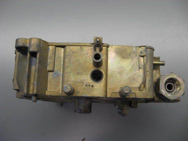

1971 carb with 7/8-20 inlet threads and a factory stock inlet fitting for stock 3/8" line:

Originally Posted by lars
You don't need an adapter. You just need the plain ol' stock fuel inlet fitting.
huh, the carb I ordered off of Ecklers came with a fitting for a 5/16” line so I think the carb I received might not have been from a corvette
