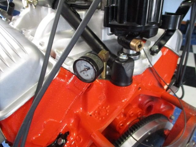

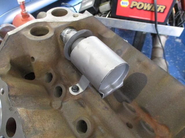

Big hole in the back is for the oil separator for the crankcase vent, used up through 1967.
It looks like this inside the lifter galley:
It looks like this externally:
I've only seen them on the 327 blocks.
