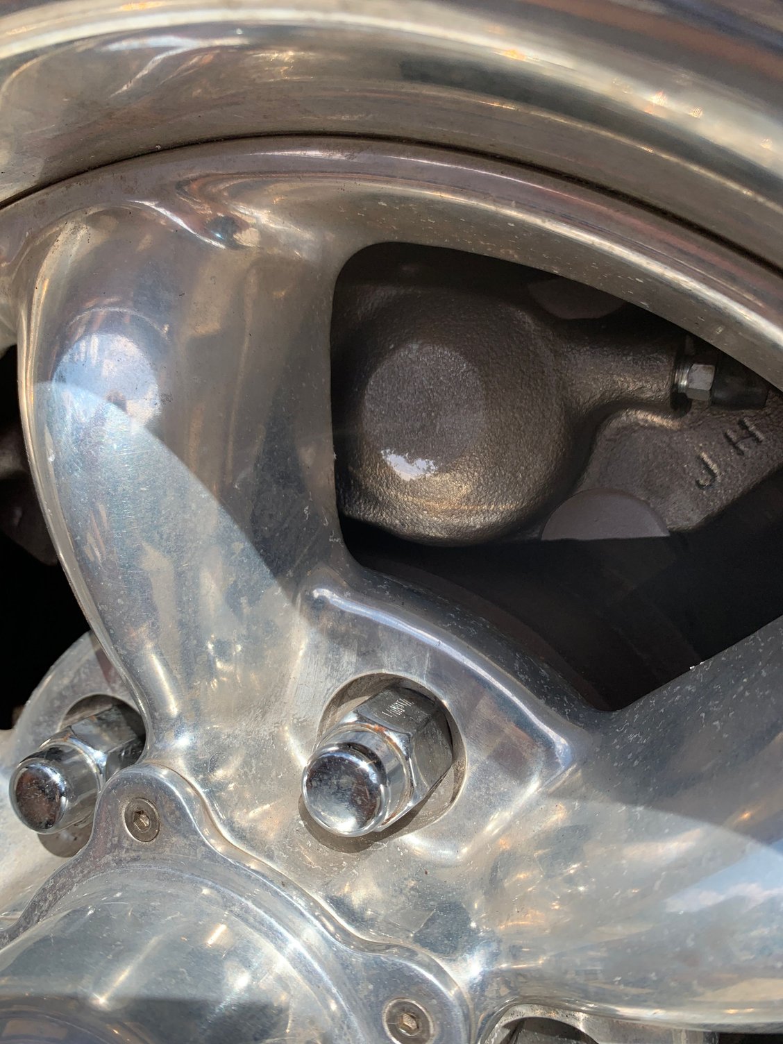

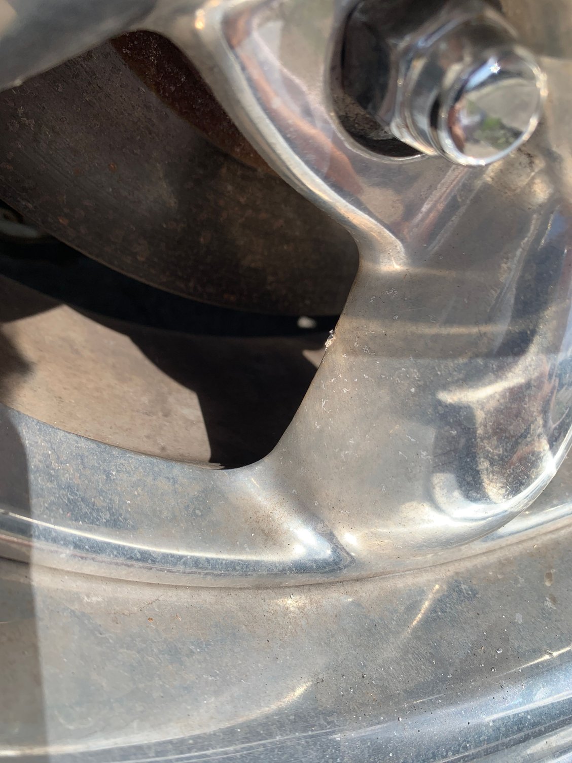

Please don’t sand them down..send some pics maybe that will give better isea whats going on
Caliper after rubbing with the wheel
Burs on the wheel from rubbing with the caliper

I bought the correct caliper and it’s a new casting so I wouldn’t mind shaving of 1/32 of metal just so my wheels will fit. I’ve seen other threads that spoke about the pirate jack racing MC and how it worked in their car but I’m kinda skeptical about it. My old MC still works but is very rusty. It also developed the same problem that the car currently has. The brakes are soft until the very end and I can go over 30mph or else the car won’t stop properly
