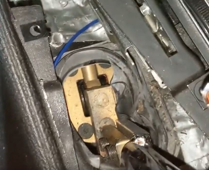

i bought a car that's had a lot of mods done to it, although with some strange choices
one of them being how the shifter is way too far forward, i got a video of what i mean
i did some measurements and the shifter is about 1.5 inches too far forward
because i couldn't find an easy way to get the rubber shift boot off i just sorta tore it...
and turns out there's already a shifter offset in here, but it's 1.5 inches?
So uh, is this entire shift turret too far forward? How do i relocate it further back? is this a common problem with tko500s in c3s? what do?
Also there's this sort of ring around the rubber shift boot with some bolts through it and duct tape on top. If i remove the duct tape and those bolts will it let me take off the shift boot and examine the turret more closely?

the rubber ring looks like the original shifter seal. There was a second shift boot that is screwed to the floor to help keep heat out. You should be able to remove it and see the top of the shifter.
Im in the process of getting my new to me, McLeod 5 speed which is a WC T5 type and the shifter itself can have different offsets for the applicatin. Your shifter looks like its welded so you may have to either have a bracket made to offset it to the rear or look and see if that shifter can be reoved and replaced with a longer offset.

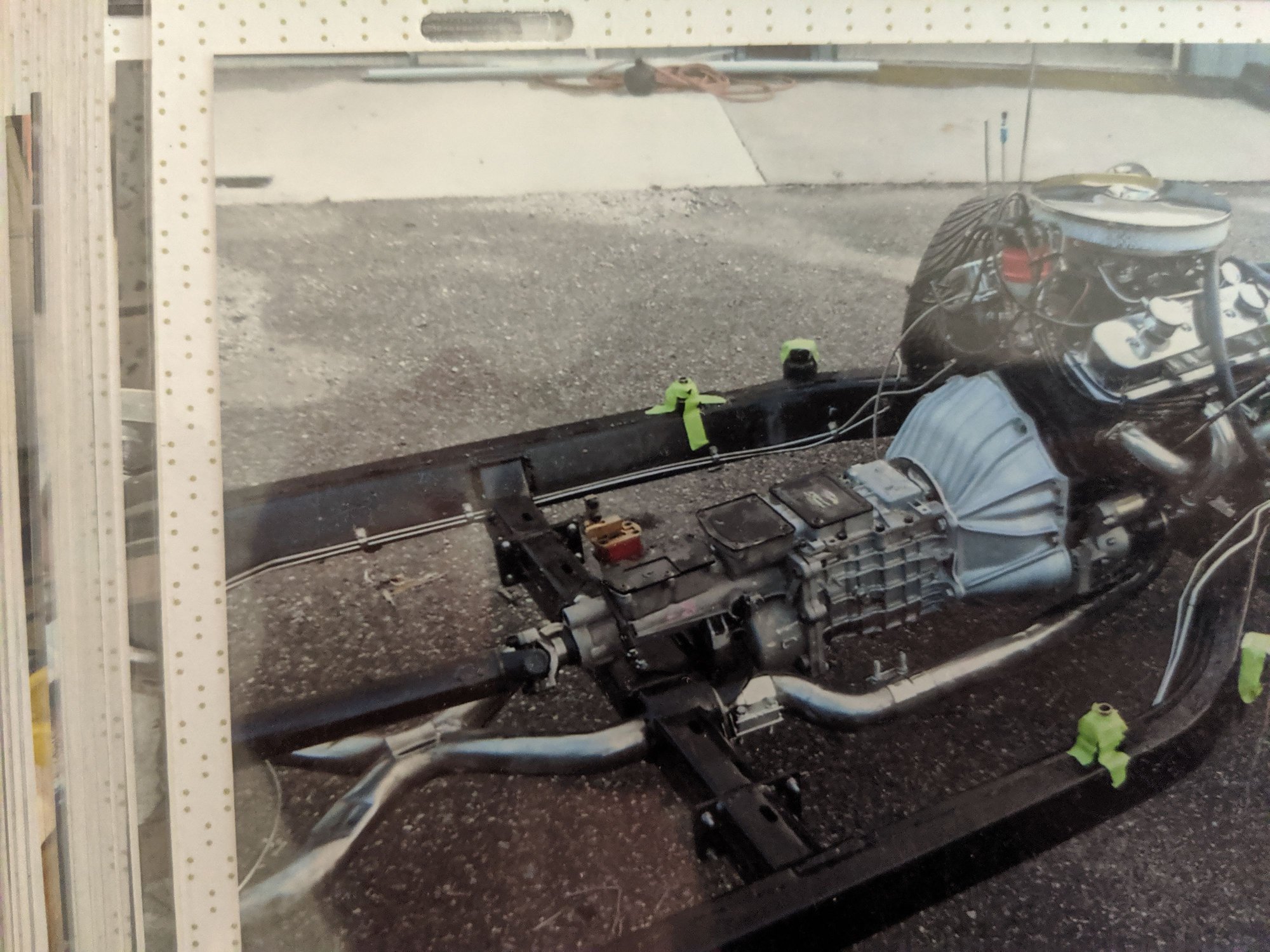

uh oh, nevermind
just checked the large photo album the previous owner gave me, documenting his restoration process
this is showing the tko shifter mounted, and it looks like it's as far back and left as it can possibly go
Thing is, this is supposed to be one of those american powertrain pro fit kits, so it should be precisely positioned from the beginning, you shouldn't need this kind of shifter offset.
now i'm wondering if, like, the entire center console is shifted too far back for some reason?
it'd explain some other weirdness, like how the parking brake lever isn't laying down properly, hmmm

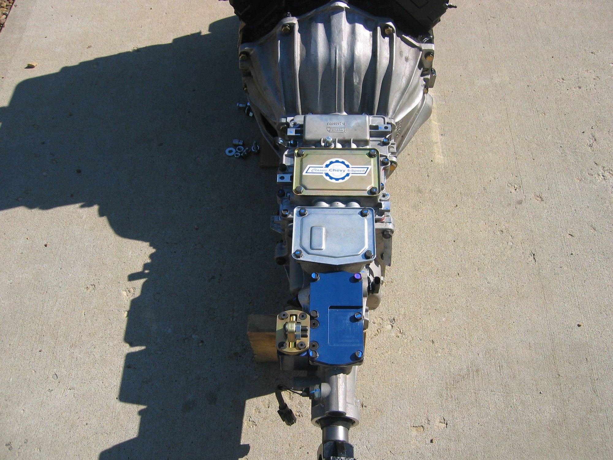

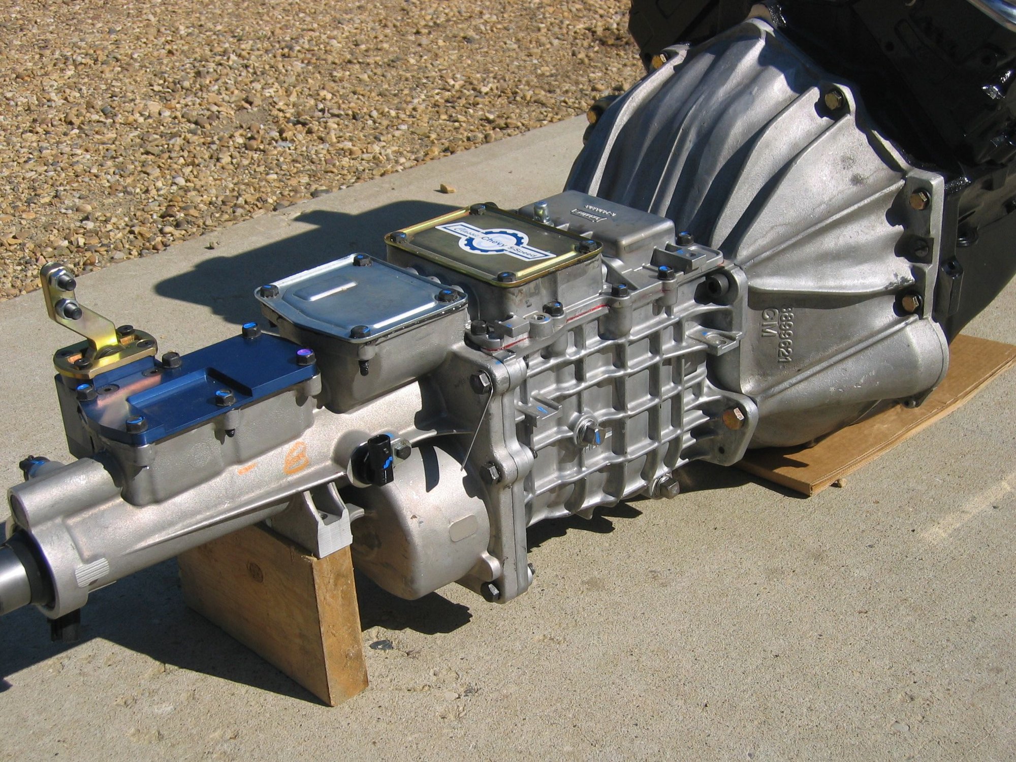

Here are a couple of pics I have of my 5 speed, the shifter positioning is perfect in my car. I hope these help you figure out if yours is correct.
