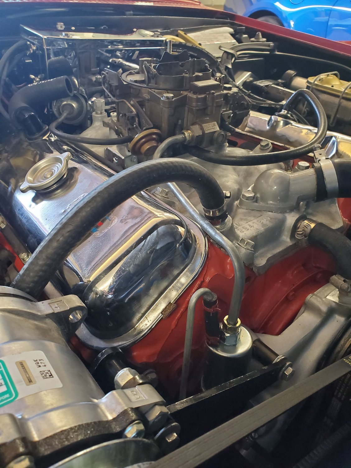

Originally Posted by lars
Yup.
The following is a partial list of issues that can cause that problem:
  • Plugged or restricted fuel tank strainer (aka, "sock") in the tank
  • Kinked or collapsed rubber line section between the tank and the frame line
  • Kinked or collapsed rubber line section betwen the frame line and the fuel pump
  • In-line fuel filter installed between tank and pump
  • Inadequate fuel pump capacity or faulty pump (low fuel pressure at WOT)
  • Incorrect fuel pump installed without vapor return
  • Plugged fuel filter
  • 2 filters installed between pump and carb (in-line filter with in-carb filter)
  • Low-flow inlet seat installed in carb
  • Low float level
  • Incorrect secondary rods
  • Incorrect secondary airvalve spring tension
  • Incorrect choke pulloff bleed rate
Lars
well i have a inline fuel filter and a in carb filter. Isnt that stock?
The carb filter has a check ball in it.

No. You run one or the other, but not both. If you have the in-line filter, remove the in-carb unit. It could be causing enough restriction and pressure drop to cause the problem you describe,

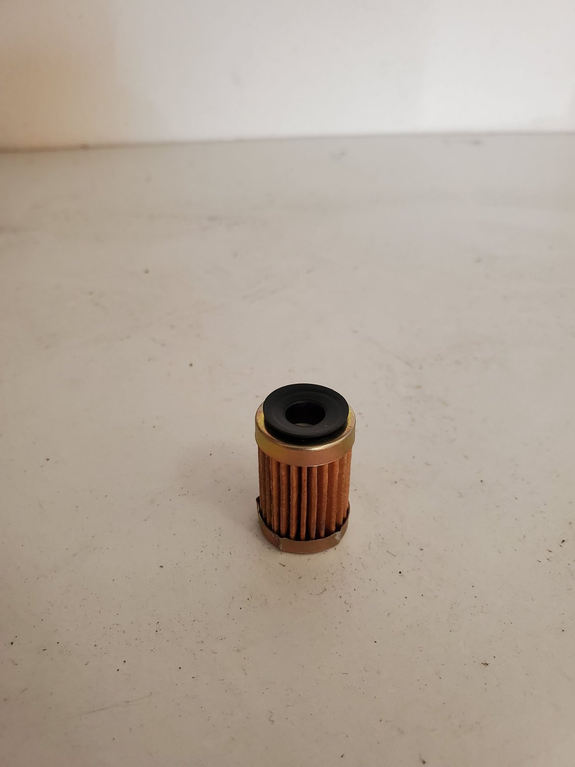

well I have the check ball filter in the carb to stop it from siphoning back through the fuel pump..
Oh well, out it comes
Ill temove it when I disassemble the carb to prep for shipping

In stock factory configuration did GM remove the carb filter on the L36 because of the factory inline filter or did it come from the factory with both? I remember a few years back having a problem with those Napa anti-drain back check ball filters on my 69 427 L36. Under full throttle it would start to run out of fuel at the top of second gear until I changed to a carb filter without the check ball. I always thought it came from the factory with both filters....
I also think the design and materials on that Napa filter were changed awhile back to be less restrictive as the older ones and new ones differ in appearance.
yes.. I orginally had the regular carb filter (no check ball)
recently removed that filter and installed the napa brand check ball filter. Didn't notice a problem until recently becauce I was breaking in a new rear gear and wasn't getting on the engine. I started noticing the issue recently when i was in 2nd gear and at wot full load. The engine fell flat on its face....no power

Well you were right about the check ball napa filter in the QJ inlet housing. It was restricting flow at wot.
Thank you for your help
Heres the culprit.
I'll be sending the qj out to you this week.
Mike
