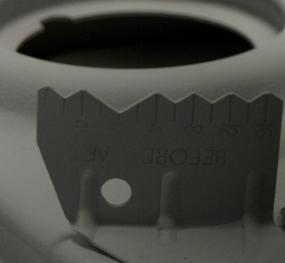

Also.. I have the stock timing pointer which is difficult to read. Is the 0 degree mark the second pointer from the bottom?

Are the pistons stock? These were 10.25 to 1 and on the ragged edge of pump gas with a stock cam.......if you are worried, dial 36 in and leave it......I had original pistons in mine and it did not ping on 93 octane.
Here is a pic of the tab:
Jebby
