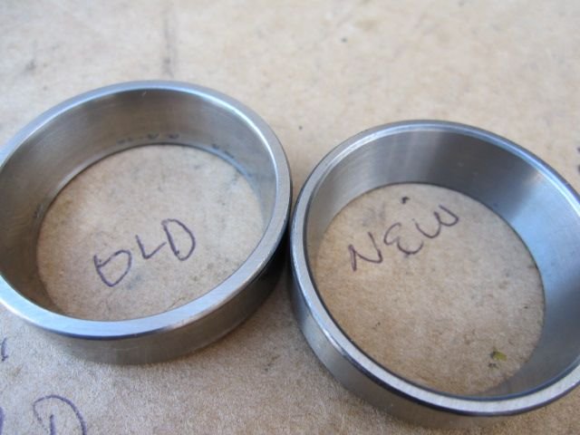

How do you know if the bearings are bad? The car has 27k miles. They don't make any noise. They seem like they roll smooth. They had plenty of grease when I took them apart. The car has been driven around 1000 miles in the last decade or so.
Why are you wanting to replace the bearings if they run smoothly? I would replace the seal, re-grease the bearings and put it back together. If you clean and inspect the outer races of the bearings carefully their appearance will give you a good indication whether they should be replaced. There are lots of pictures online of what good or bad bearings look like. If the original bearings have not become contaminated by water or dust etc and the milage is genuine they should have many more miles of life in them. JMPO. The critical thing is when you reassemble the hubs that you get the bearing preload correct, there was an update on this procedure from what was listed originally but I can't find that document at the moment
Taper roller bearing outer races.
Although this old bearing is showing some signs of wear I wouldn't call it knackered JMPO
