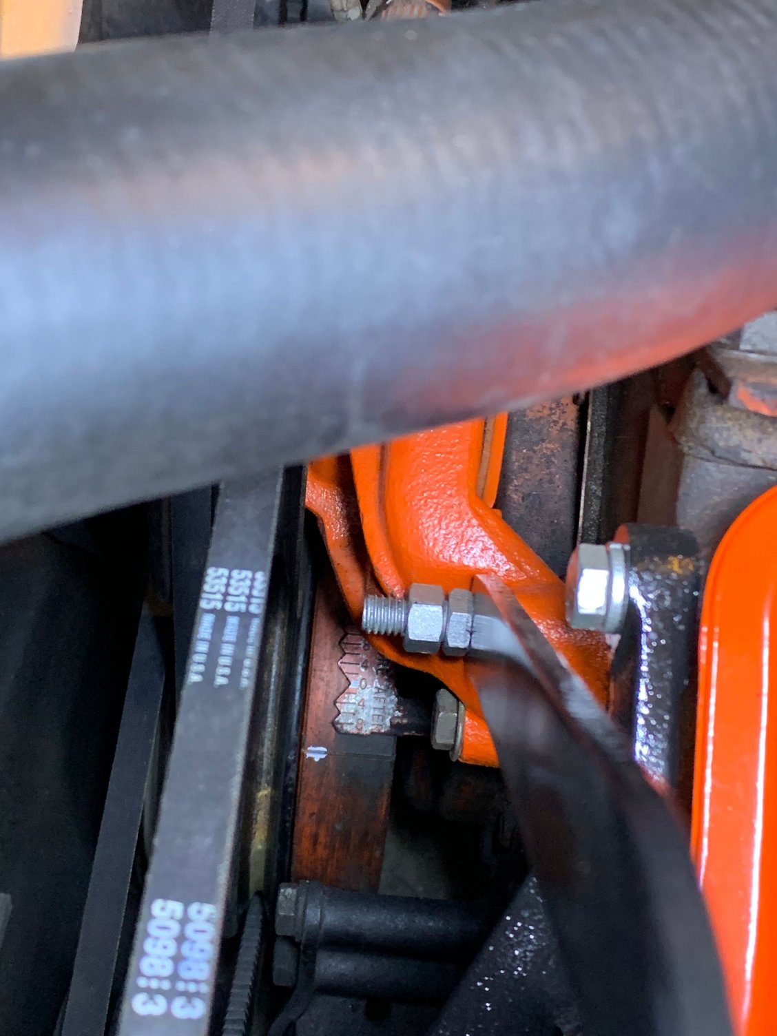

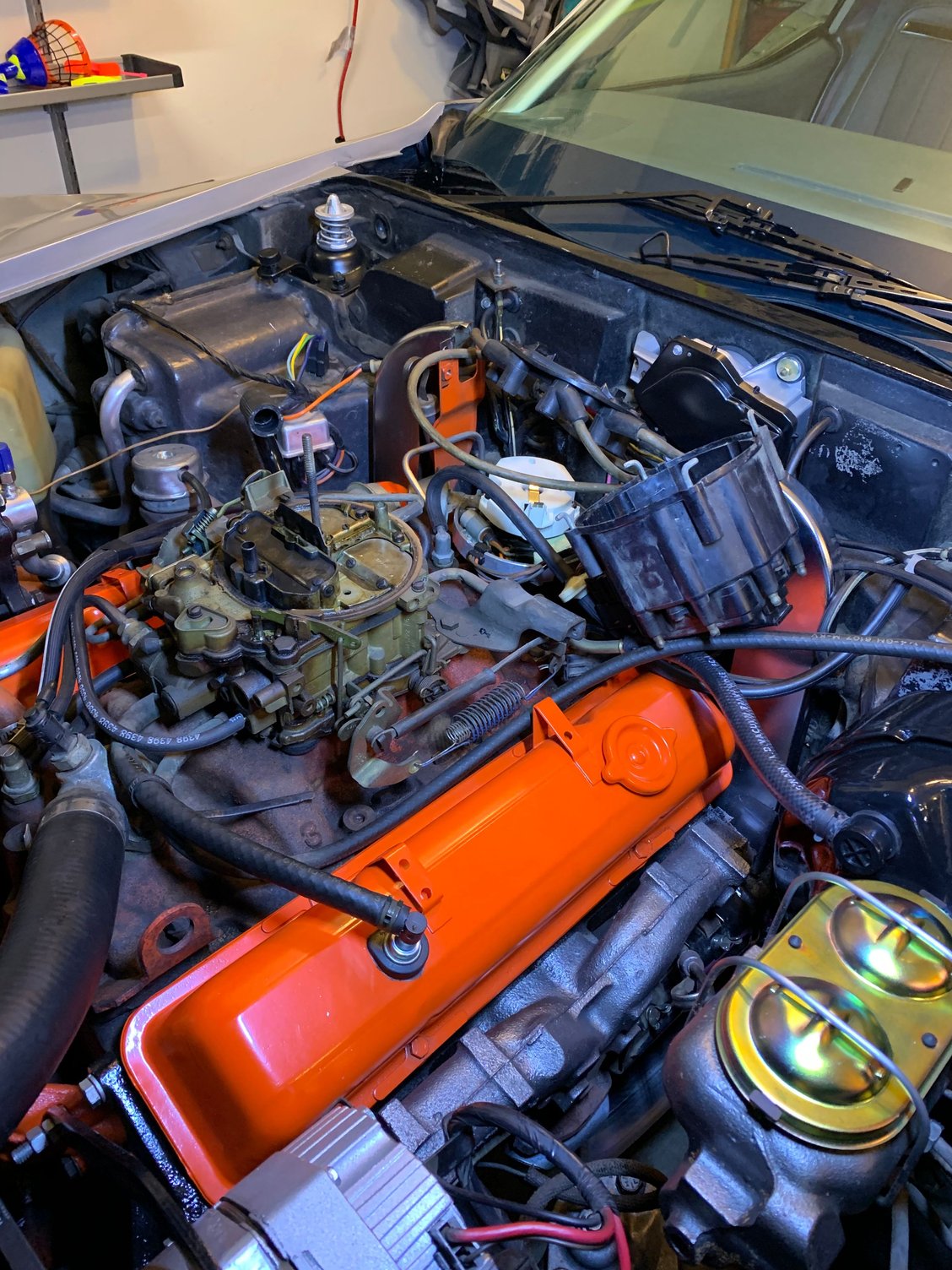

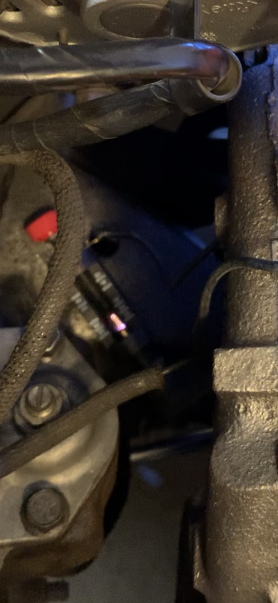

I have spark, verified tdc with paper towel plug in #1, it shot out and I stopped cranking, balancer shown in second picture so about 12 degrees after is where it stopped and third picture shows position of rotor pointing at #5 cylinder, so should just reposition rotor to about halfway between 1 and 8 correct?
Spark
Old Feb 28, 2020 | 08:24 PM
