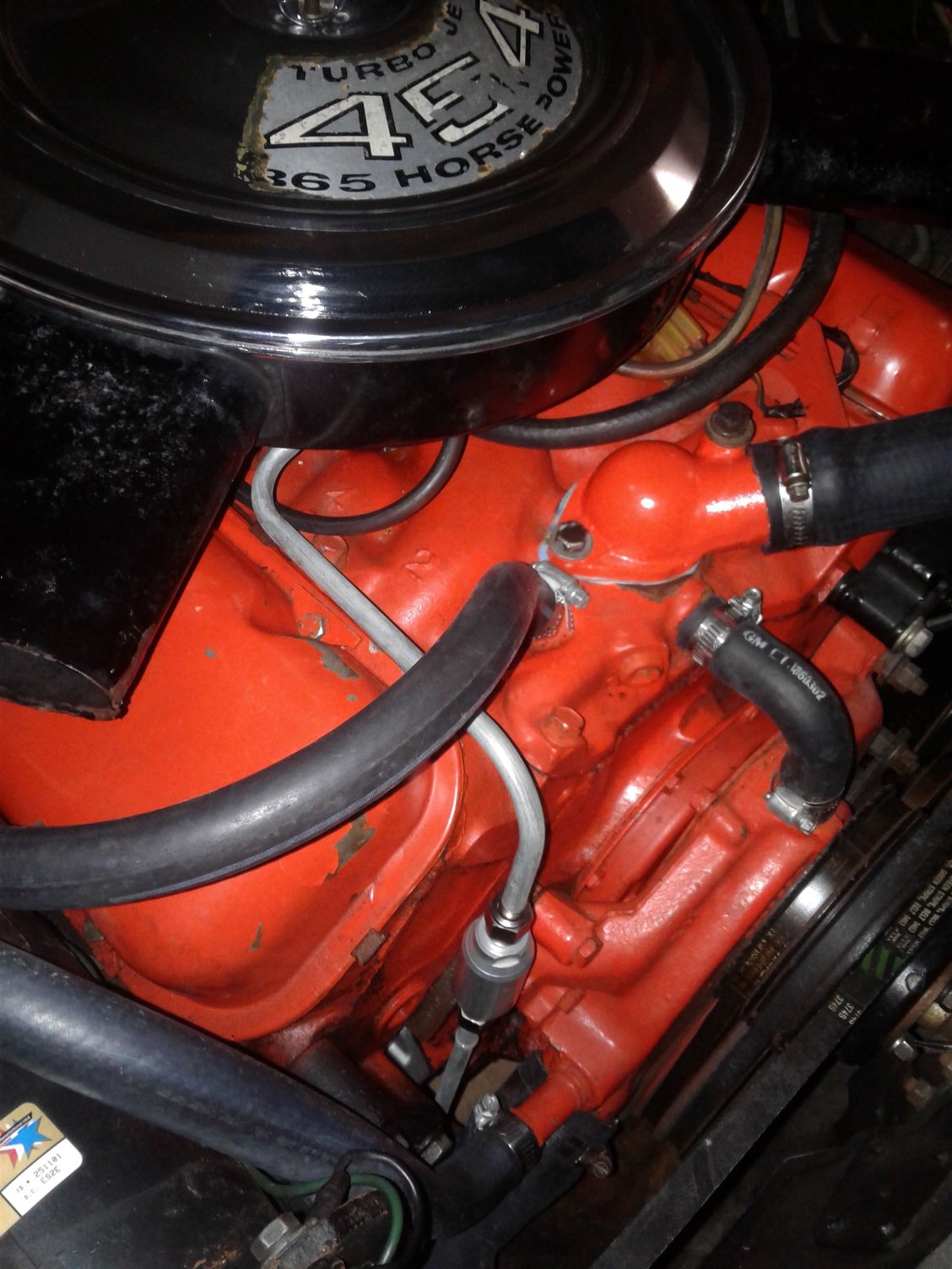

You can get the flare to -6 AN fitting if you look for the fuel pump.....then just run a small log filter:
https://www.summitracing.com/parts/sum-230102
I do most of my pump to carb lines this way......I just did this 340 Demon a few weeks ago:
And these hand cutters are awesome for -6 and -8 braided line......cuts it nice and clean. https://www.mcmaster.com/3563a71
You will have to learn how to make braided AN fittings....but it is not hard......actually it is quite fun
