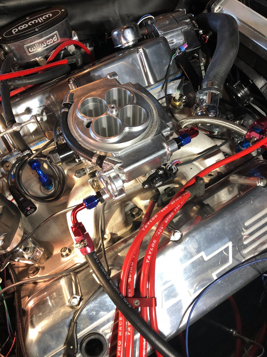

I made the switch.
I went with the Sniper, Gas Tank, and the whole Hyperspark ignition. It works really well!
I will say that the more radical you cam is, you will want to eventually get it professionally tuned. That helped me a ton. And I picked up about 40hp (but lost some fuel economy).
The great part is that there is no more hard starting cold or hot (no vapor lock), the response is unreal, You get a ton of information from the little hand held (I also pumped it to my Dakota Digital gauges), and it is very consistent.
Cons are that you do lose some control. For a car with no computers in it, now you have one adjusting things. Being a software guy myself, I weighed that because I felt like I was giving up some control. Also the original feel of the gas pedal was SUPER touchy. Get one of these throttle arm extension because without it the throttle is way too stiff and touchy.
https://www.efisystempro.com/sniper/...ter-lever-1952
Overall I love it.
Here is the dyno run after I had it tuned (485hp and 514ft-lbs at the rear wheels)
