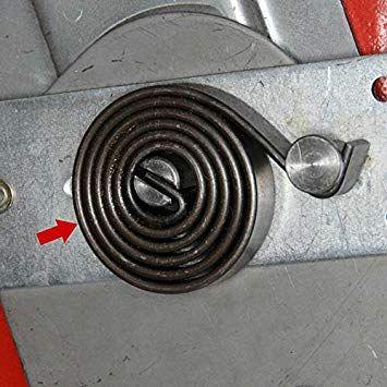

When you did the work, did you replace the assist coil spring? (was the old one still there?) That spring takes a lot of weight off the motor to help the window go up. Other than that, most common issues are old caked lube, worn runners, electrical connection weak (frayed wire in the door?), etc.
