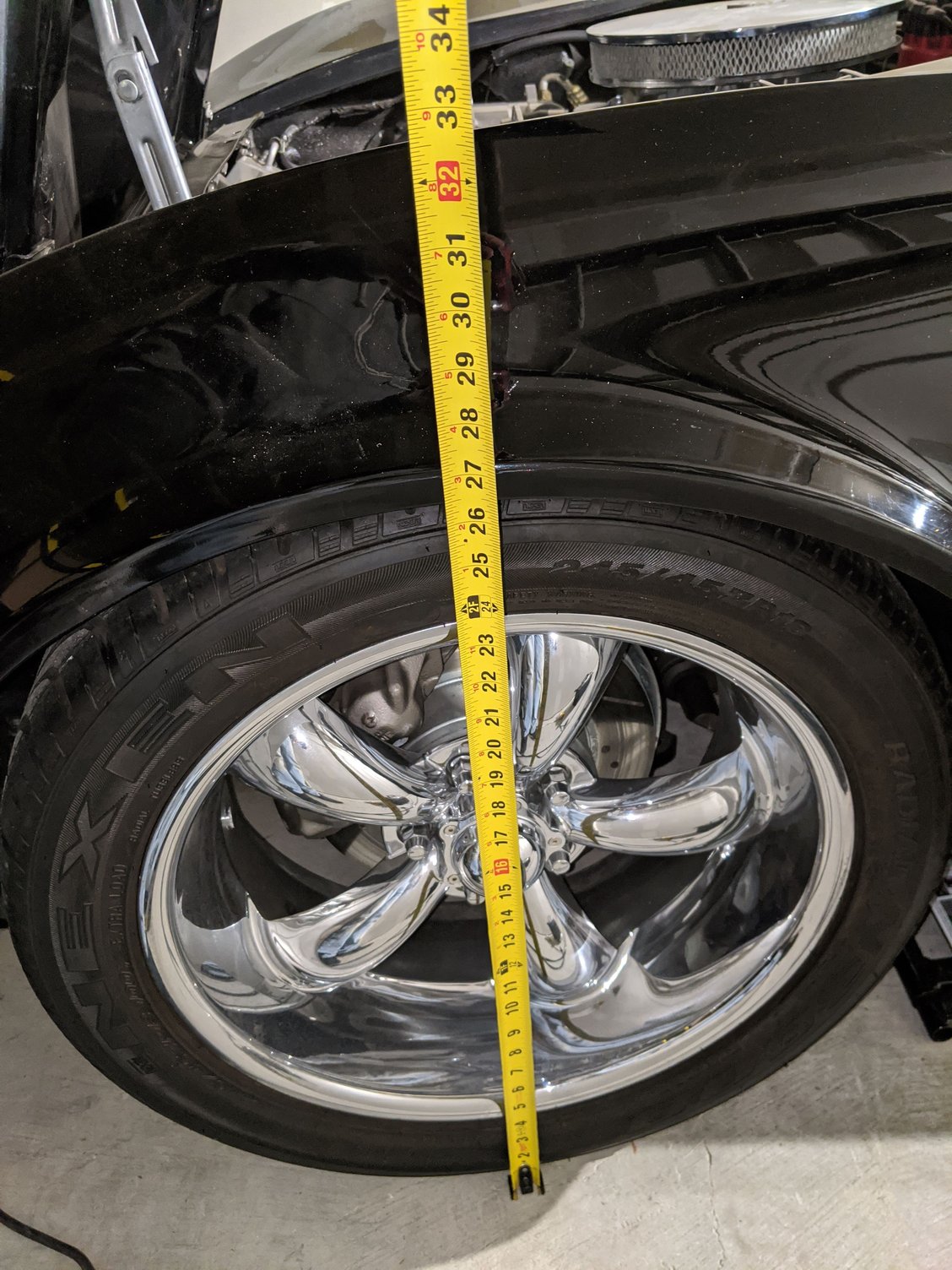

looks like I've been thrown in this discussion too. purchased a restomod from a fellow and he put on a a trw 602-103 spring, 340#
also has bilsteins front and rear but i haven't checked exactly what models
tires are 245/45/18 front and 255/45/18 rear
i noticed the 4" higher rear when trying to get this thing on quickjacks, the front sits at about 26.5 and the rear at 30.5, so i need to drop the rear by 4 inches to match the front
i got some 10.5" extended c4 bolts i haven't installed yet, but my plan is to install them, get the nuts to 9" and check the ride height. IF i can get to 28" in the rear i'll be happy with that, and cut off the rest of the bolt
front height
rear height
With 18" wheels you have a lot more room to work with longer bolts. I'd still throw that TRW spring in the bin and get a low-arch spring from Van Steel, but you may be able to get the result you want without putting the tires in danger from being cut by the spring/bolt ends.

i'll be keeping the bolts within the rim diameter, but there's less tire deformation when you have way less sidewall than the 15s, so i'm less concerned about it.
i mean, a low arch spring sounds great but from what i hear the trw spring works well aside from this one issue, and it's $489 i can spend on other things in the car, heh
there's also the matter of my front being shockingly low, 26.5 when other folks are like 27.5 or 28. Normally i'm all for low but past a certain point rough roads get really impractical. I may need to get better front springs (i don't know exactly what springs the PO used)

On the rear it is a one to ratio. 1 inch longer bolt gives you one inch drop. Just make sure the end of the spring stays within the rim. The sidewalls move an amazing amount in cornering and can cause a blowout if the spring is too close. I have seen the sidewalls move over 2 inches sideways in a a video!
On the front that is so low the PO must have cut the springs.
