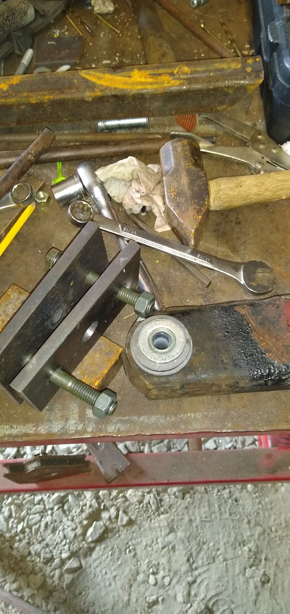

I am just beginning the change out of the strut rod and trailing arm bushings. After I received the arm bushings and of course they came in several pieces. It didn't take me to long to figure out that I could use a vise and proceed on. I didn't start scratching my head until I came to the sleeve and its plate. I thought about just aligning the plate up with the bushing when I installed the arm but knowing that all you Gurus on C3's were here, I did a little research and realize it would have been a bad move to just install them and move on. I did some browsing only to find out most of the tools that would do the job was out of stock or discontinued. But dang! there it was, a picture of one. It took me about an hour and had a working tool for the job and I have to admit it is much better tool than the $45 dollar one without shipping that was listed. Total cost, $1.67 for two grade 5 bolts and nuts at TS and a little digging in my back yard treasure. It worked like a champ, and waiting for the strut bushings and will be back on the road. Thought I would post it to help someone else out that maybe scratching their head.

Made my own a few years ago. Very similar to what you have done. Good on ya!
