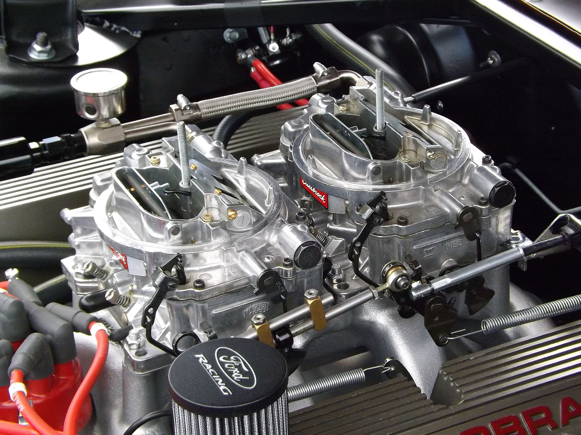

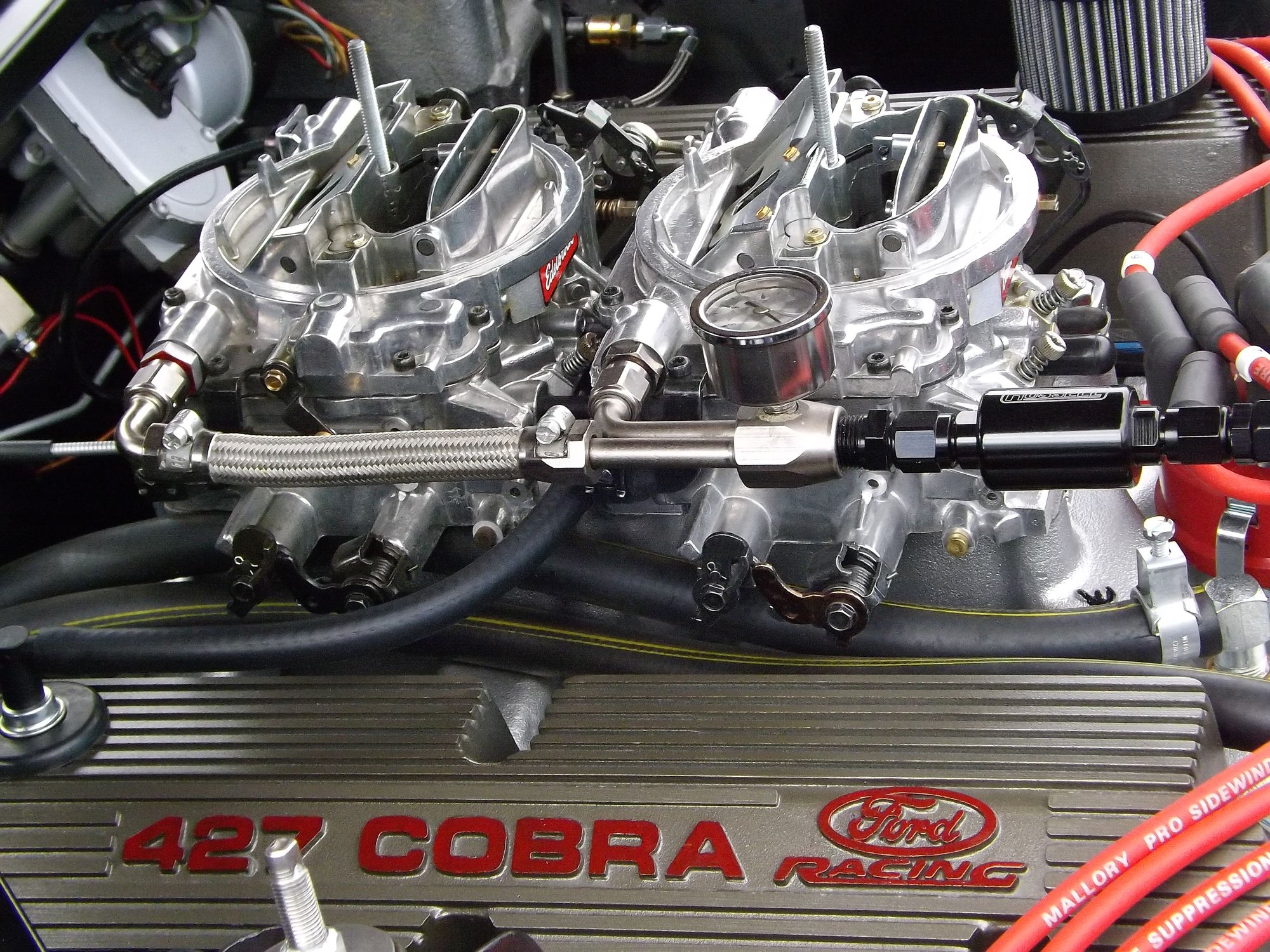

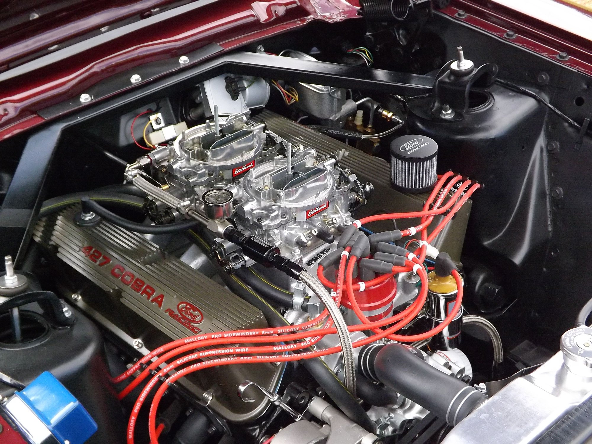

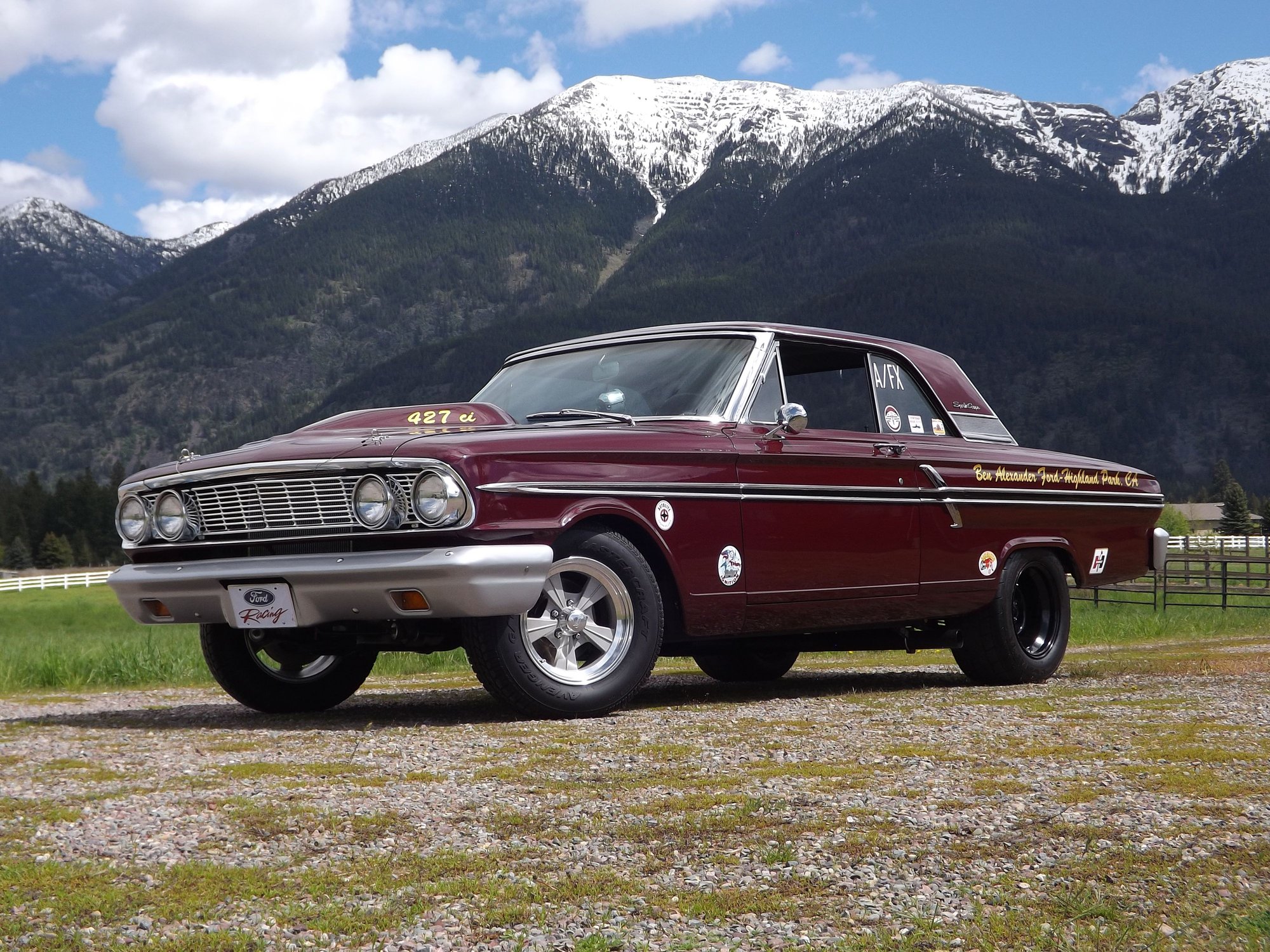

Here's the setup on my '64 Ford Fairlane 427 small block stroker. I've done quit a bit of carb tuning to get it right. The best guide I've found is the carb tuning guide that you can download from Edelbrock's web site. It addresses dual carb setups with big cams, too, which mine has. I start with the rear carb, which is the primary, and work right to left, rear to front, until I have the highest idle, then back each screw off an eighth turn. I find it runs cleaner and smoother once warmed up if it is a little lean. One of the trickier things to tune is when the secondary air doors open under acceleration. They can really flood your manifold if they open too soon. I've changed out those crappy single springs for dual springs seance these photo's were taken.

really good looking engine would like to have it put it in a vette just to **** people off ,I'm like that and have not been a brand loyalist for a lot of years. I truly think hand down the best SB ever made with all the potential is the ford Cleveland. I'm almost tempted to build 1 I like the engine so much and still put it in a vette.
neighbor across the street from me had a 4 bolt clevland block I could have bought may still have it. Not a spark plug guy out of site I like them . On chevy I run them down the back then down under the headers. Sbc has always been a belly button engine everyone has one. With just one 4 barrel on them they look even more belly button if that's possible.

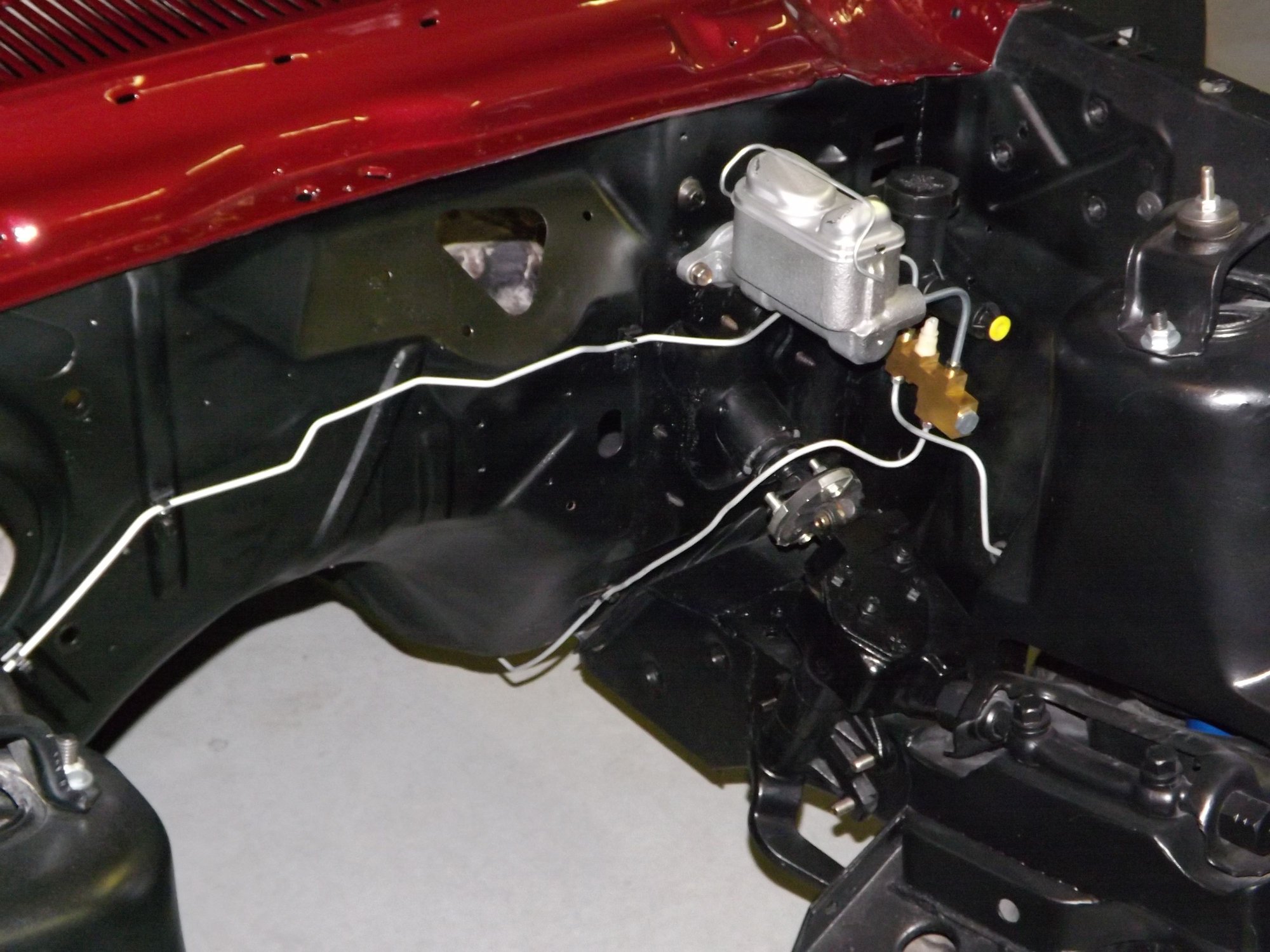

I agree, Little Mouse, the cleve is a great medium block size engine and I considered it for my Fairlane, but it would have taken too much engine compartment modification to fit. I had enough cutting and shaving of the shock towers to get the Windsor in there. The severely modified 289 headers is another horror story. Then there's the weight and cost of building a decent Cleveland as well. Dollar for dollar, the Windsor stroker can't be beat. That's why Ford Racing still produces them in stroker create engines all the way up to 460 cubic inches!
Shock tower modifications.

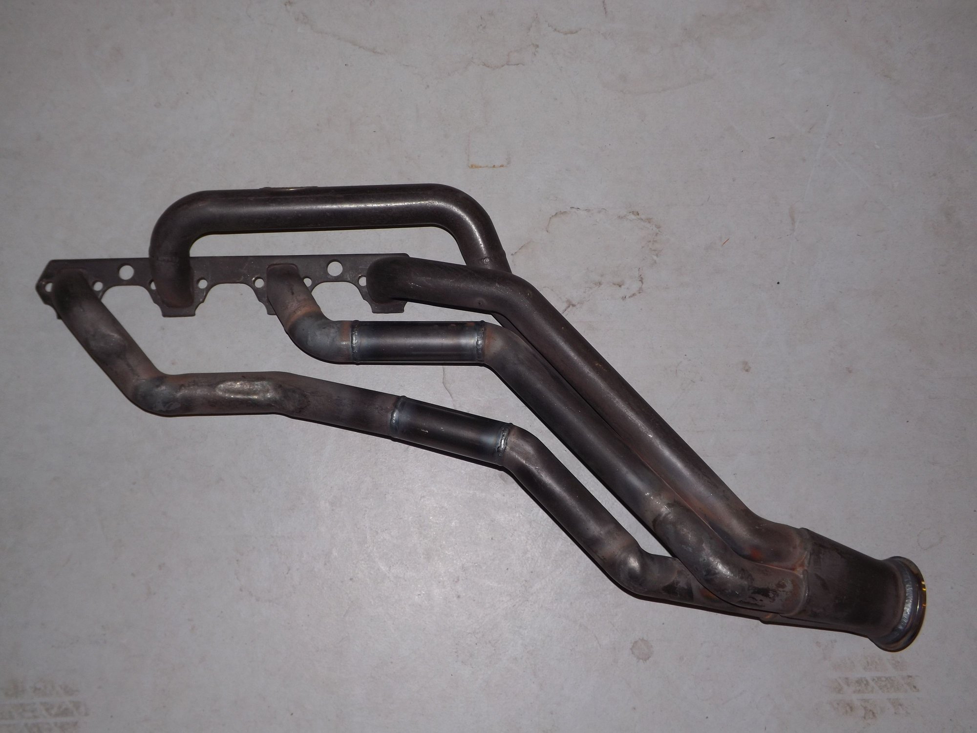

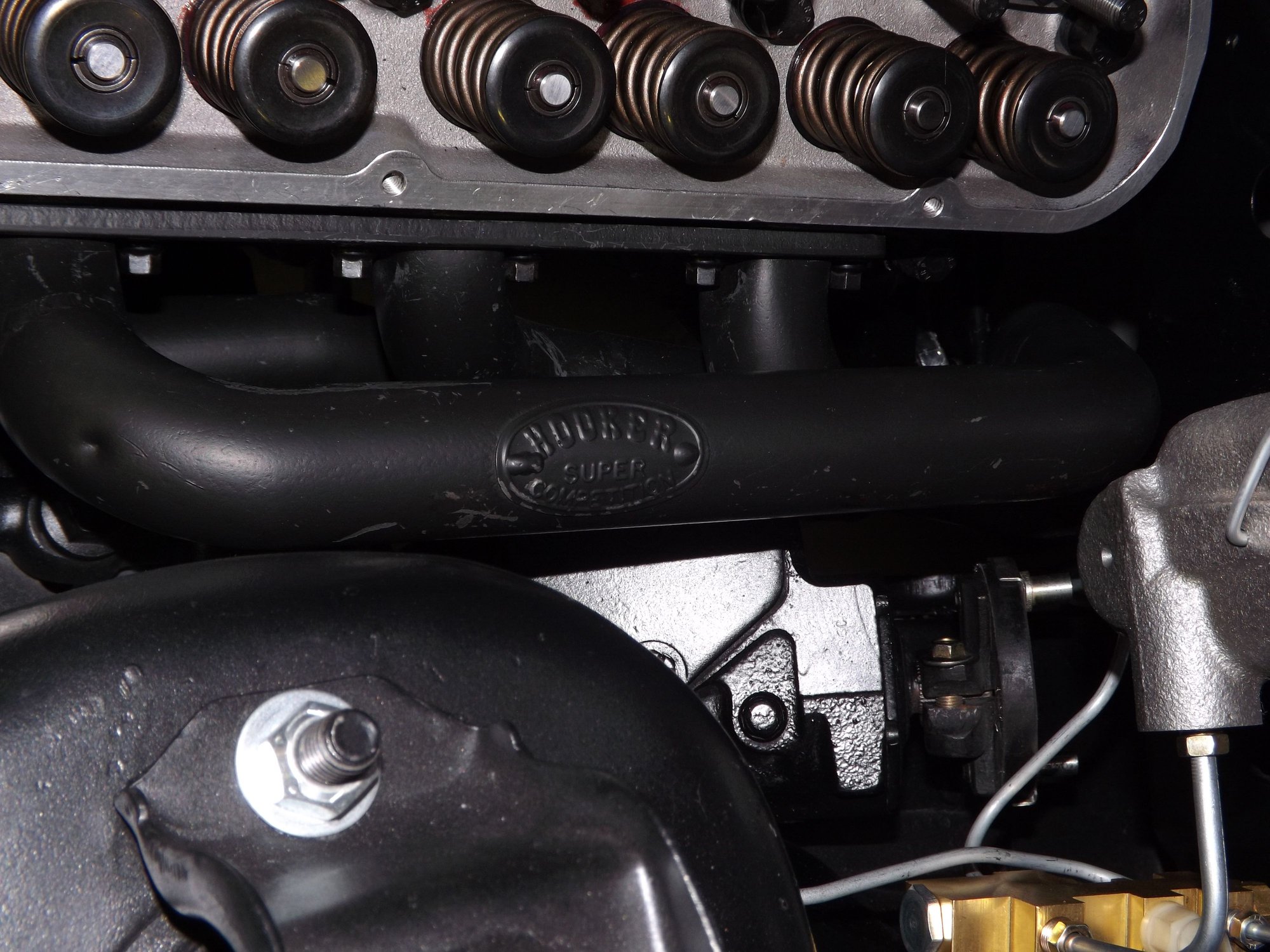

Nice new set of $450 Super Comps hacked all to hell.
But they fit, barely!
