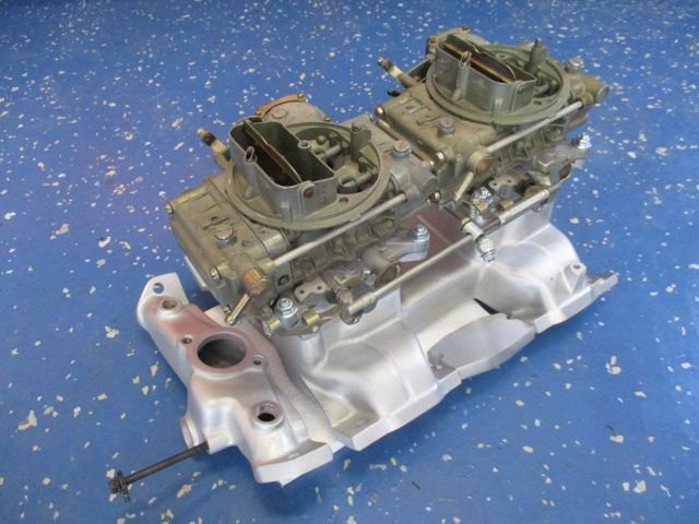

Here's a dual quad setup I have for a Pontiac - I have tested it, and it runs just great with the Holley idle mixture screws in their "normal" positions. Air/fuel mixture at idle can be nailed down easily right at 14.6:1 in the normal adjustment range, and no throttle plate drilling or other mods are required to the stock-configured carbs (these are the Holley 390's, limiting total airflow to a street-friendly 780 cfm). This setup is done with 1:1 linkage, and actually works just great:

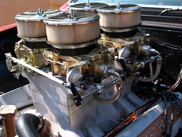

hexedecajet
Old Mar 26, 2020 | 07:02 AM
Jebbysan's Avatar
Jebbysan
Dr. Detroit
Joined: Mar 2012
Posts: 10,097
Likes: 4,027
From: New Braunfels Texas
hexedecajet
Quad-lude?
Jebby
