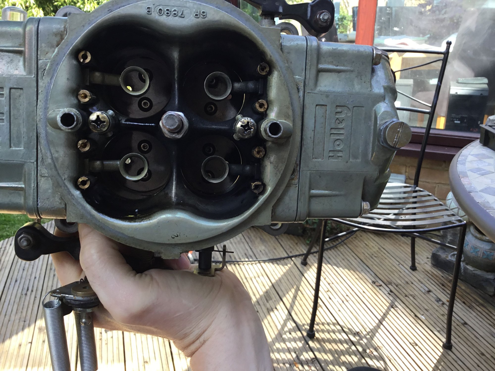

As you can see the secondary butterflies were open slightly which I have now corrected.

Originally Posted by knodty
I believe that is your issue right there.......that is a lot of controlled leak. And it appears the secondaries are open a smidge but could be just from the way you are holding it as the secondary linkage is resting on your hand.
Sucks that you are across the pond as I have an HP plate on the wall I could send you.

The power valves open at idle will add no fuel to the idle, they add fuel through the main circuit so only after the main circuit is flowing will they add fuel.
With a 9" idle vacuum and a 3.5" power valve your power valves are not open at idle.
I would look for a vacuum leak and I agree that 4 - 3/16" holes, one in each throttle plate is a lot.
Jebby
Appreciate the offer 😀. The secondary’s were open that smidge but it was the stop on the base plate that was holding it open not my hand. It was just difficult to hold the carb in one hand and the iPad in the other hand and click the shutter, you should of seen the face I was pulling to get that picture. 🤪
The timing is good.....may need a little more depending on what cylinder head you are running but you are in the ballpark. Your initial should be a touch higher at 16-18.
Most likely, this is your cam:
https://www.summitracing.com/parts/cca-11-213-3
This is not terribly big for a 460 inch BBC........you should have more than 7 inches vacuum at idle. I have the small block version of that cam in my 406 and it pulls 10-11 inches.
I feel this is where the problem lies.......I feel you have a vacuum leak somewhere.
Also....could you post a pic of the holes in the plates? 3/16" is huge.....and this in itself could be the issue. If they are actually .1875 in diameter.....you need to solder them up. Four .1875 holes is a LOT of air to pass at idle.....I have built plenty of setups that had that much cam and ran standard plates with no issues.
I just do not feel that that cam needs holes in the plates.......factory L-88's had more cam in them stock and they idled with no holes in the plates......if you had a solid roller with, say, 260 @ .050...then yes....that would work.
Easy thing to do would be to buy a new throttle plate and try it......or solder them up.....soldering them up is easy and free...the cost of a gasket to remove the throttle plate.
Another thing......very few carbs have two power valves in them anymore and they are usually for boat applications.....or road course where you are modulating more than 1/2 throttle to WOT in and out.....which is rare. If it was mine I would block the rear one off and add 8 jet sizes. One less thing to fail....and not needed once the engine is on the cam and accelerating.
Jebby
I think I will try soldering the holes up. The carb did come like that with the holes in the plates and it was advertised as a race carb. That is what I think my cam is roughly. I bought it about about 15 years ago and i can’t remember the specs exactly. I thought it had about .540 in lift and duration was in low or close to 300. I got it to match the Rev range of the heads and intake. I’m using edelbrock performer rpm heads and intake. It has been dynoed at over 400lbft torque and 430 bhp. It redlines at 6650rpm and builds power right through the Rev range.

The carb has some mods that somewhat tell a story about its use, not sure if you made the changes or the PO,
the bowl vents have been cut short, the bracket on the throttle lever looks to be for a OD trans (TV cable), the rather large holes drilled in the throttle plates.
Have you looked up the list number chart and verified the air bleeds and jets for the carb?
Neal
Neal
I bought the carb new. Holes were already in the butterflies and I cut the bowl vents shorter to clear the top of my air filter. Despite having a high rise hood but with the Edelbrock performer rpm intake there is not a lot of room under the hood to fit it all in. Which is why I used a torker2 manifold for so long, until I bite the bullit and bought the high rise hood.

drilling holes is old school thinking...for carbs that never had iab etc.
If you log onto speedtalk.com and post in the engine tech section a guy by the name of jmarkaudio can striaghten you up...or send it to him. It will be perfect the first time the guy is a holley wiz.
So many are quick to tel you to put a smaller PV in, change jets when it has nothing to do wiht that. PV opens when your engine dips to that vacuum level. So it wont enrich til you see 2.5 inches not sure thats the answer. Sometimes going higher or just leaving it stock is the answer. I get about 7ish inches at 1100 rpm idle, no smaller than a 5.5
The two that were fitted were 6.5hg I just changed them to 3.5hg as that was what was suggested by other videos I have watched. When I get the gasket set delivered I will swap back the 6.5hg PV’s. Already soldered up the holes in all the butterflies.
Ive set the primary and secondary butterflies to show about 25 thou of the transfer slot is this correct as I have 4 corner idle screws?

Yes all 4 throttle blades compared to the transfer slot need to be set very close to the same, 20 to 25 thou is good.
