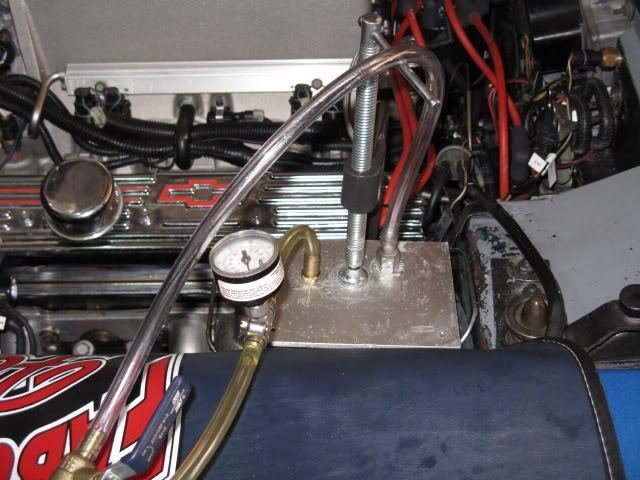

I used an aluminum plate about 1/4" thick. I notched the underside so that both the forward cavity and the aft cavity of the master cylinder get pressurized. You can see mine in this picture below. You really only need one hole, I made the second one to experiment and now have it plugged.
Get a couple of air compressor fittings, some tygon tubing, a pressure gauge, a piece of rubber to place between the plate and the master cylinder (I used inner tube rubber), and large c-clamp.
Those garden sprayers are cheap. I made it because I didn't want to wait and now I've had it over a decade. Works like a dream. You'll love it.
I've used on my other cars and friend's cars (Toyota, Nissans, Mustangs.... even on the plastic type reservoirs--just have to be careful, I have different inner tube rubber cutouts in the storage box -- for/from the different reservors that I have helped bleed).

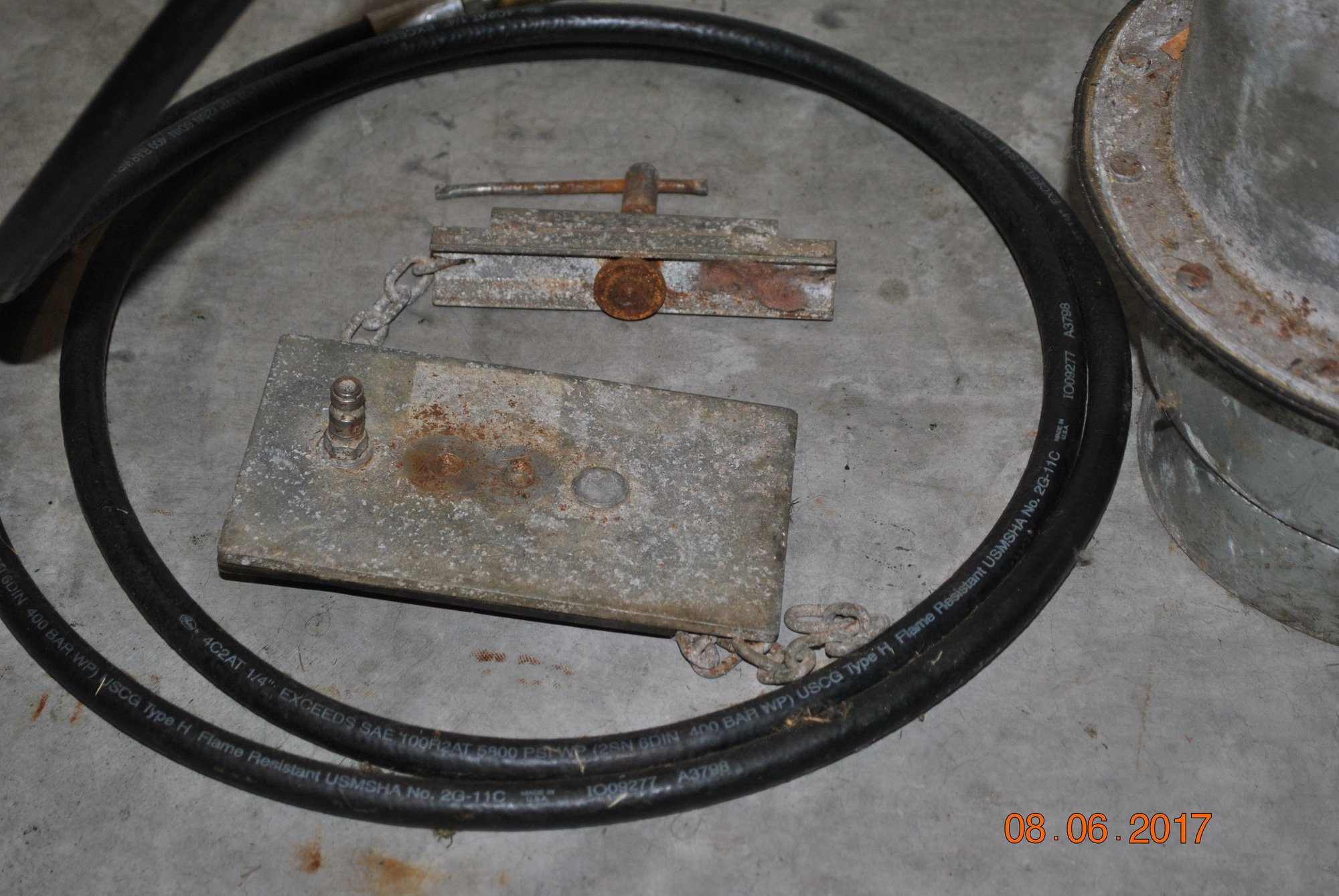

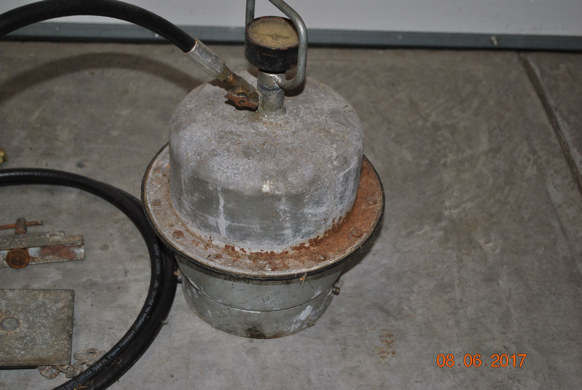

The old fashioned, Plews "bleeder ball", circa 1985......
I know that these items look a little "shop worn", but as stated, they're well over 30 years old.....
