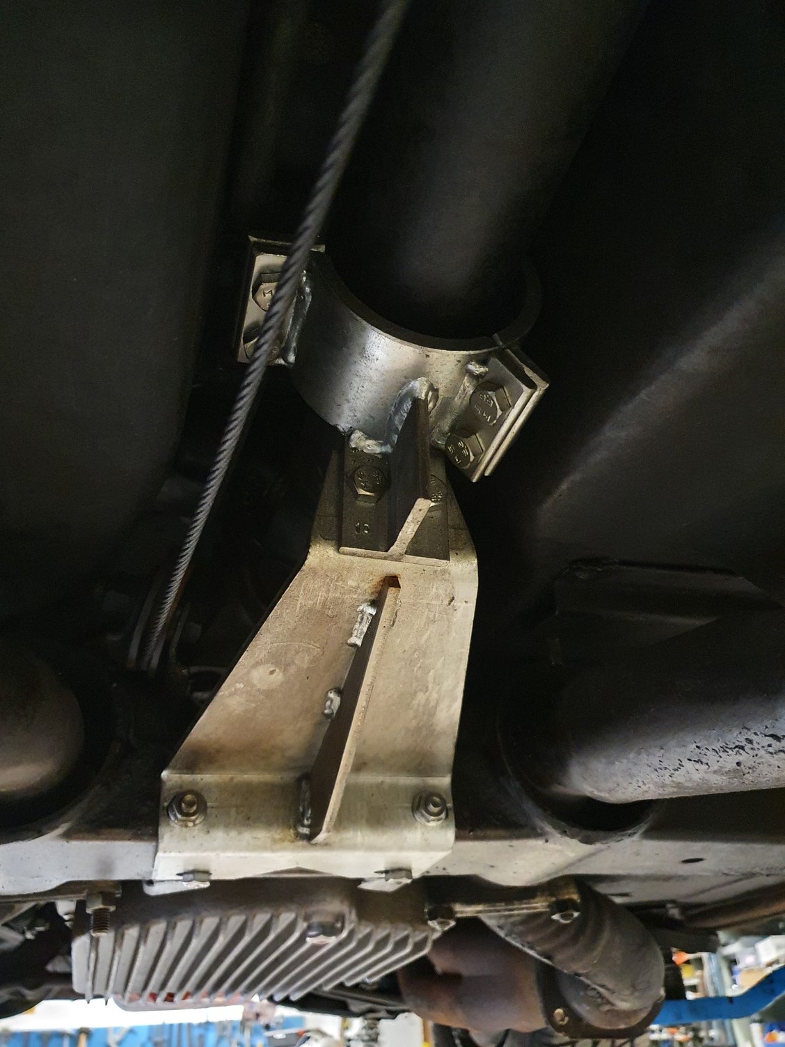

This is how my safety loop looks like, if someone needs inspiration 😀

Looks substantial and fits in the tight tunnel area available, what's the material?

Fabrication looks really nice! I have one question, may be dumb, but gonna ask anyways. Enlighten me what it is for? I have an idea that it is made for keeping the driveshaft from dropping and tearing everything up and I assume it is for racing? Inquiring mind would like to know?

That is 100% correct 😃

I dont know exact What material it is, but it is some sort of galvanized Steel.

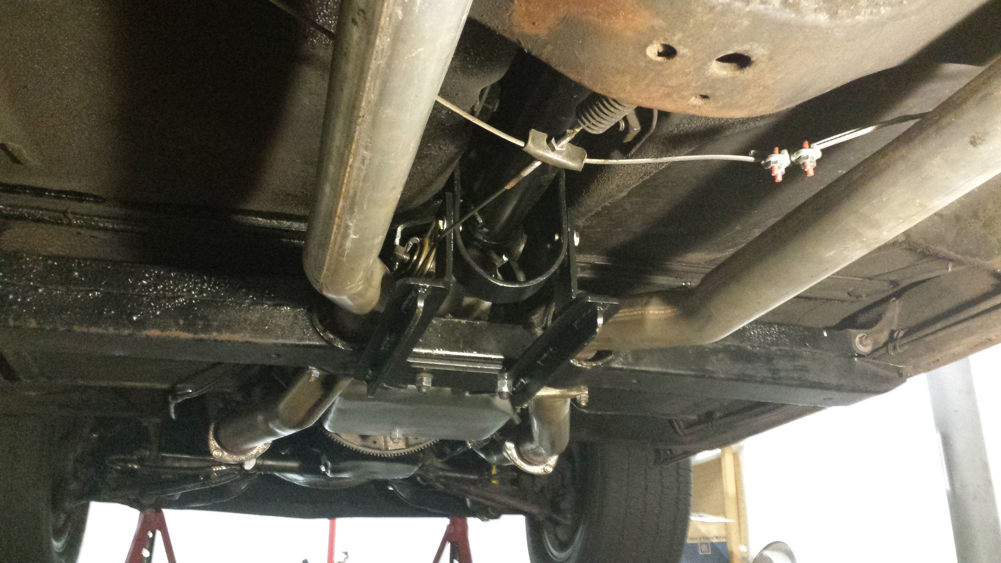

Summit racing sells this loop for cars with a floor pan. I just changed how it was mounted . My custom exhaust pass under the cross member for full length 3 inch exhaust

The clearance looks really tight. How do you keep the shaft from not touching the loop? Even with solid engine and trans mounts there's some movement.

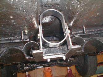

In short as others have mentioned it’s part of the rules. Most specifically the IHRA/NHRA rules where any car with slicks running faster than 14.0 has to have one and any car faster than 13.0 on any kinda tire has to have a loop.
Granted many tracks are pretty lenient on this rule given how fast many newer street cars are today right off the lot but that’s the rule and it protects you and the guy in the lane next to you.
This is the Dragvette loop. It is centered in the car, but the drive shaft isn't, so there is only about 1/4 inch clearance on the right side. I have solid motor mounts and a rubber trans mount and the shaft has never contacted the loop.
