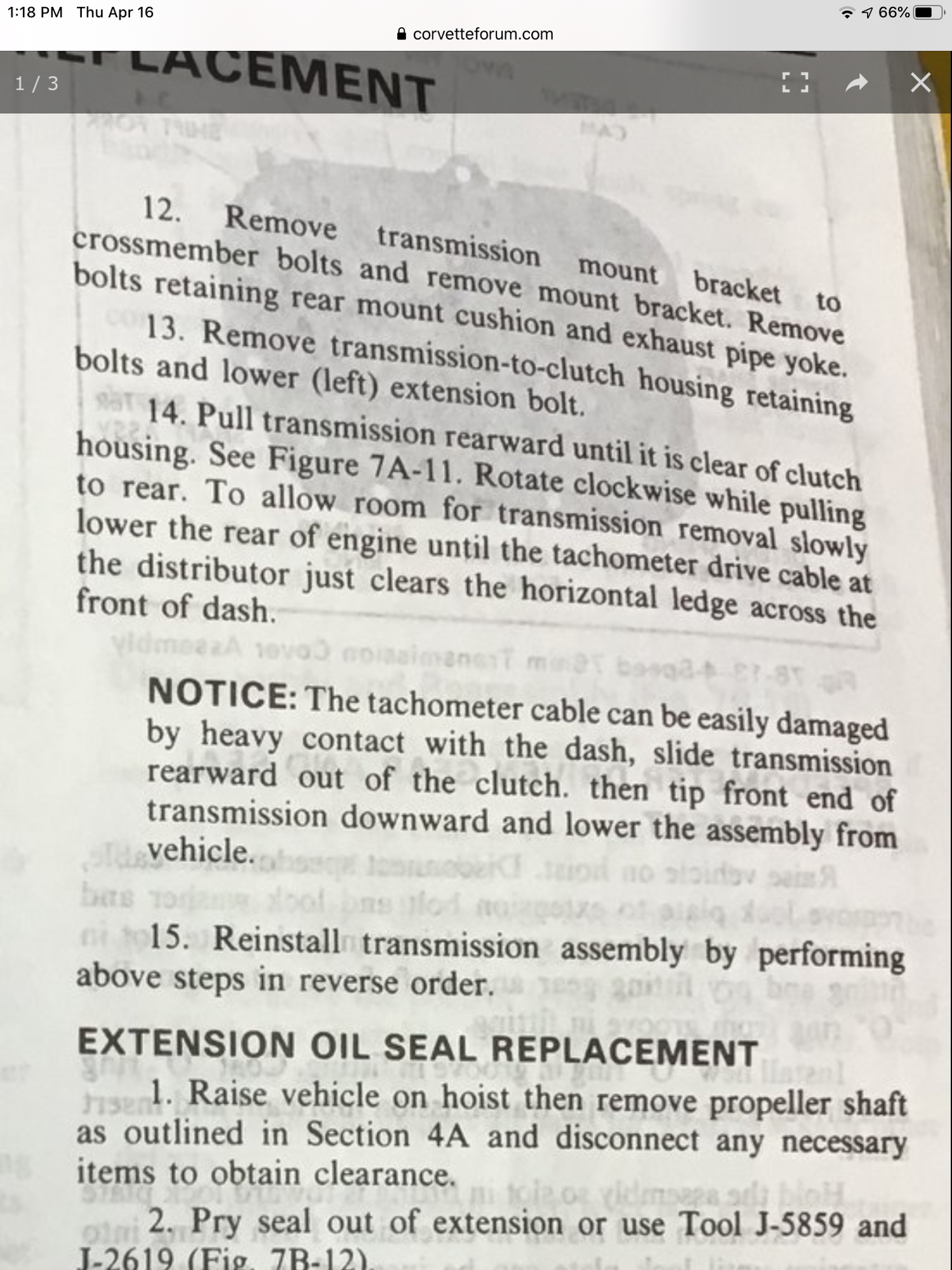

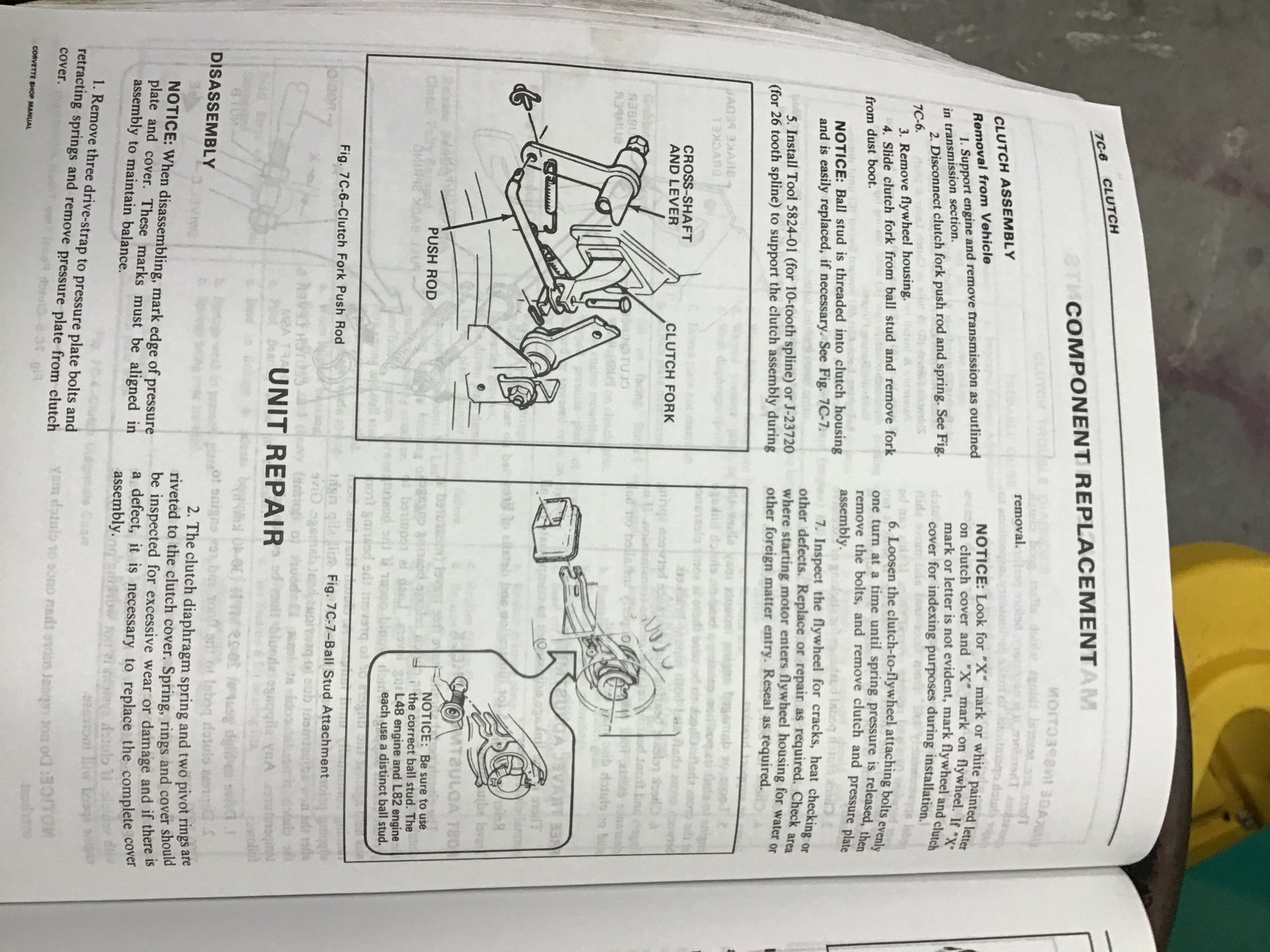

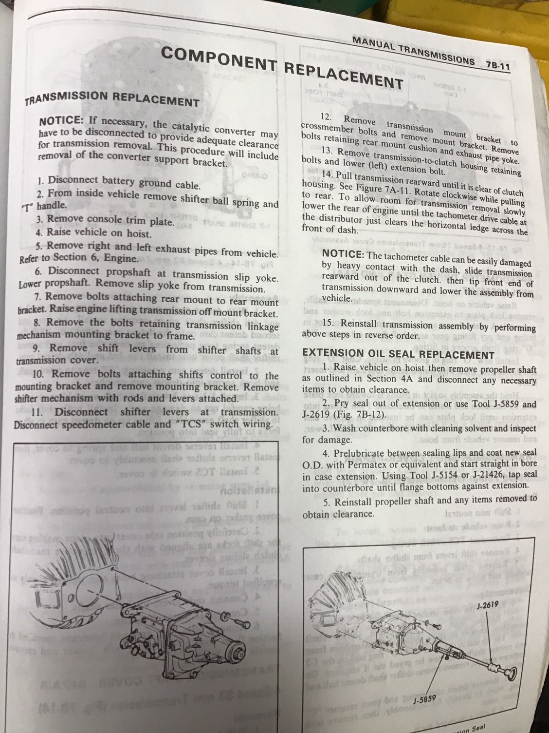

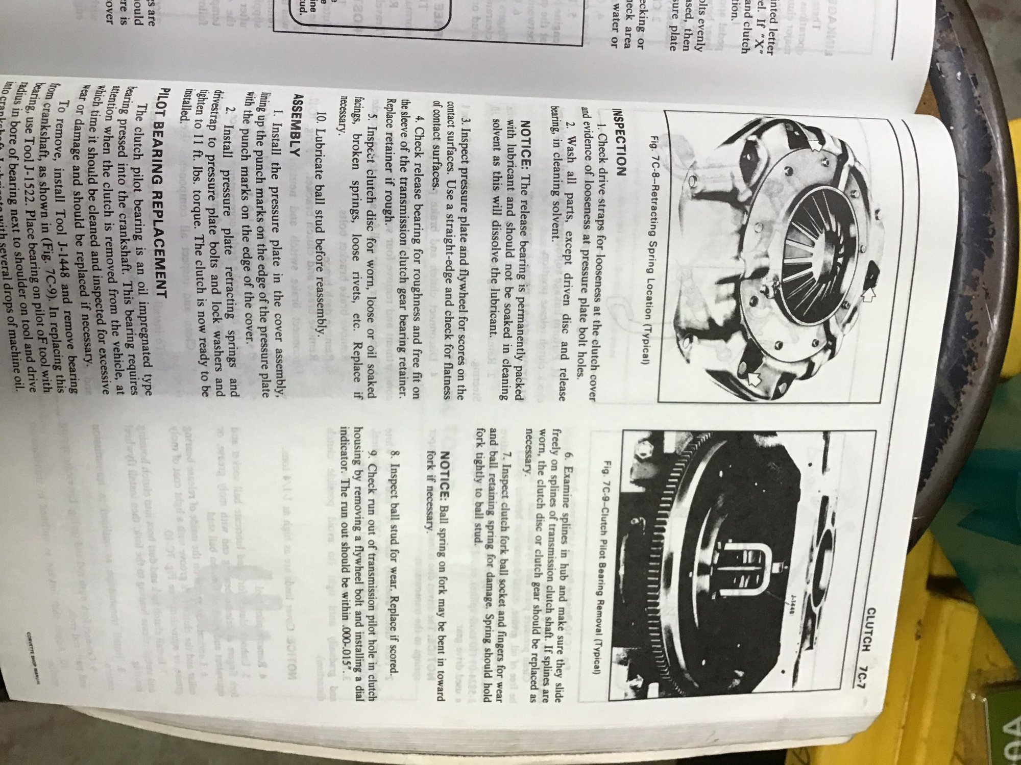

Here is from service manual 79..sound easy
To 79 Corvette clutch replacement...

Pretty sure we don’t have a tach cable either...weird its in he service manual..i do remember some stating to remove distributor cap to lower engine more? To remove transmission
