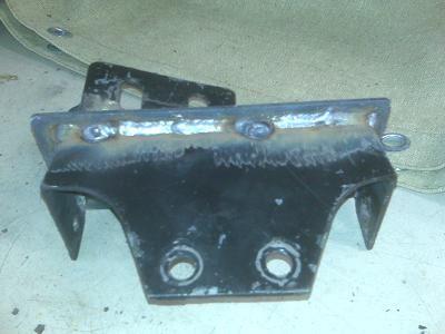

The other 2 mods are the rear mount and shifter. Here's a pic of my rear mount, which was made from
the cars original trans mount. Cut the nose off, welded a plate across the front and had the cut piece welded back on at the
correct angel, because my T5 is mounted straight with a stock bell, not the tilted camaro bell.

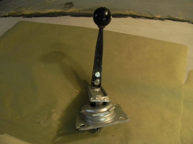

My shifter is a ford T5 shifter, since this pic was taken it now has a dummy vette stick. I went with the ford because its straight, where the
stick attaches to. On the chevy its angled. Top mounting plate of the ford shifter needs to be trimmed. You can see it comes up
through the gate a few inches to the left to look correct. Nothing more than a plate with a hole in it with a tab on the side to attach the stick.
