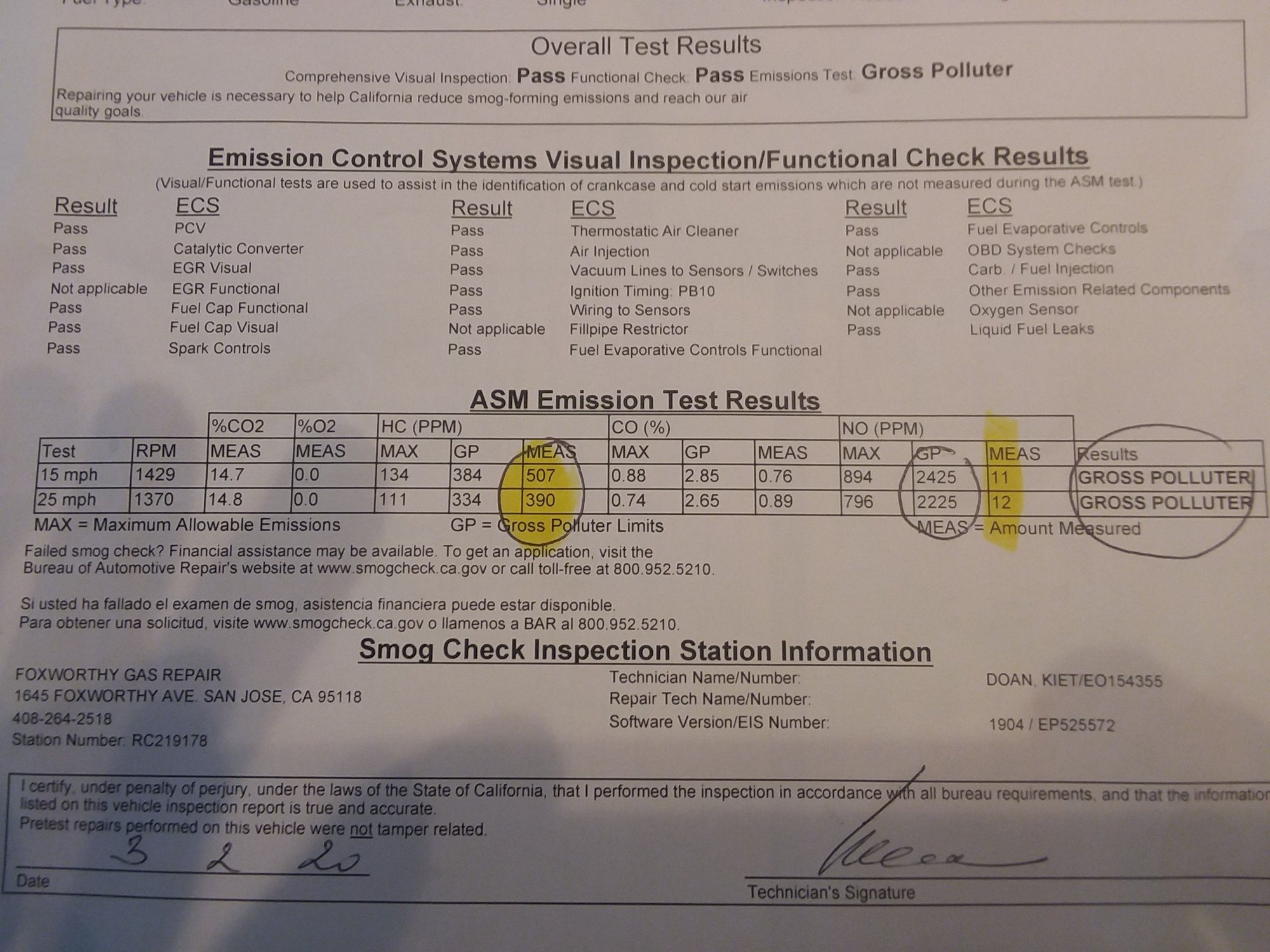

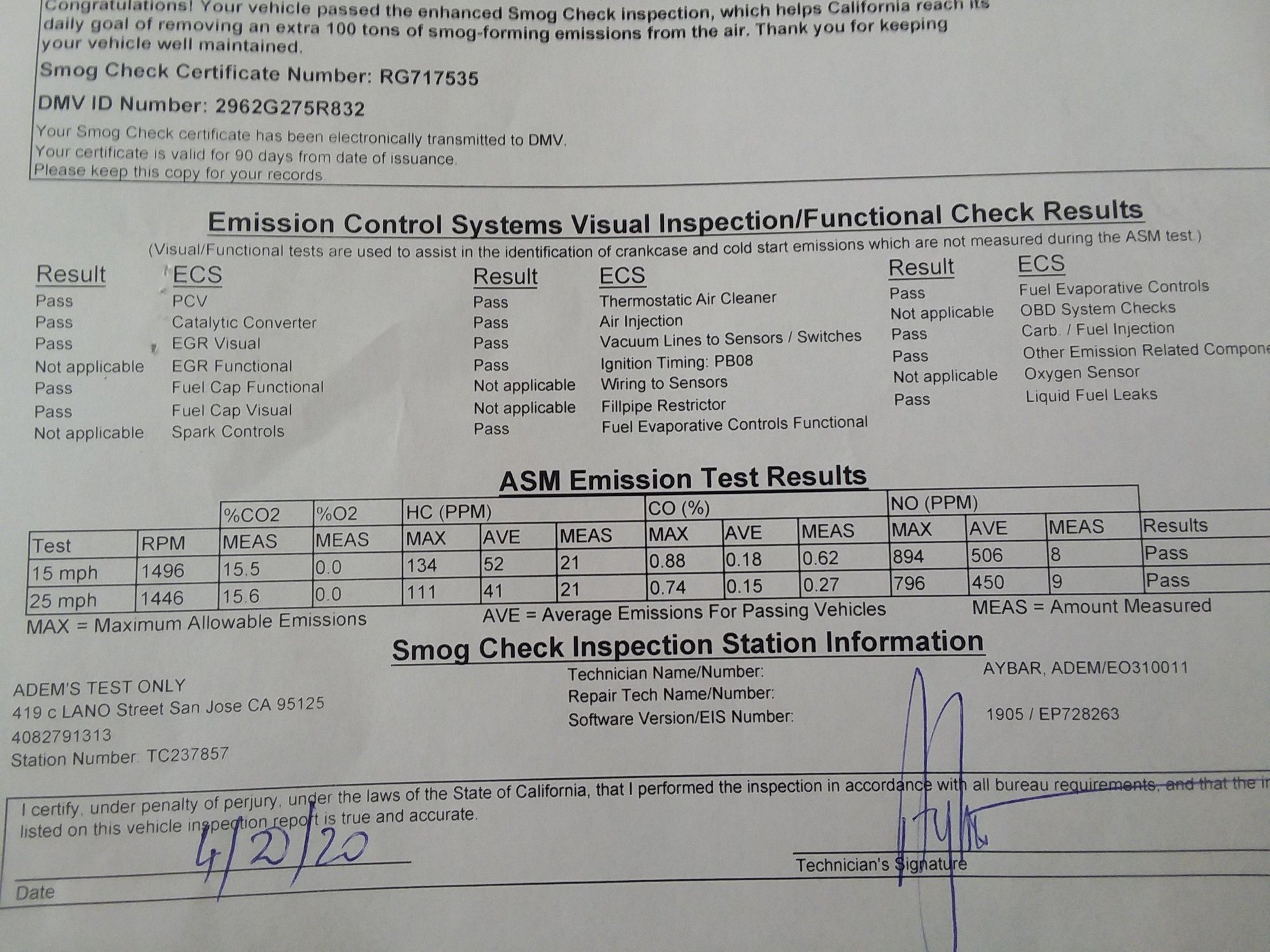

Here are the printouts. For clarification, ignore the circles on the before, the tech did that as we were discussing the results. It made sense at the time but out of context doesn't anymore.
Before:
And After:

Wow, that's a massive improvement on the HC. Makes sense as a misfire will pass raw fuel (hydrocarbons) out the exhaust.
