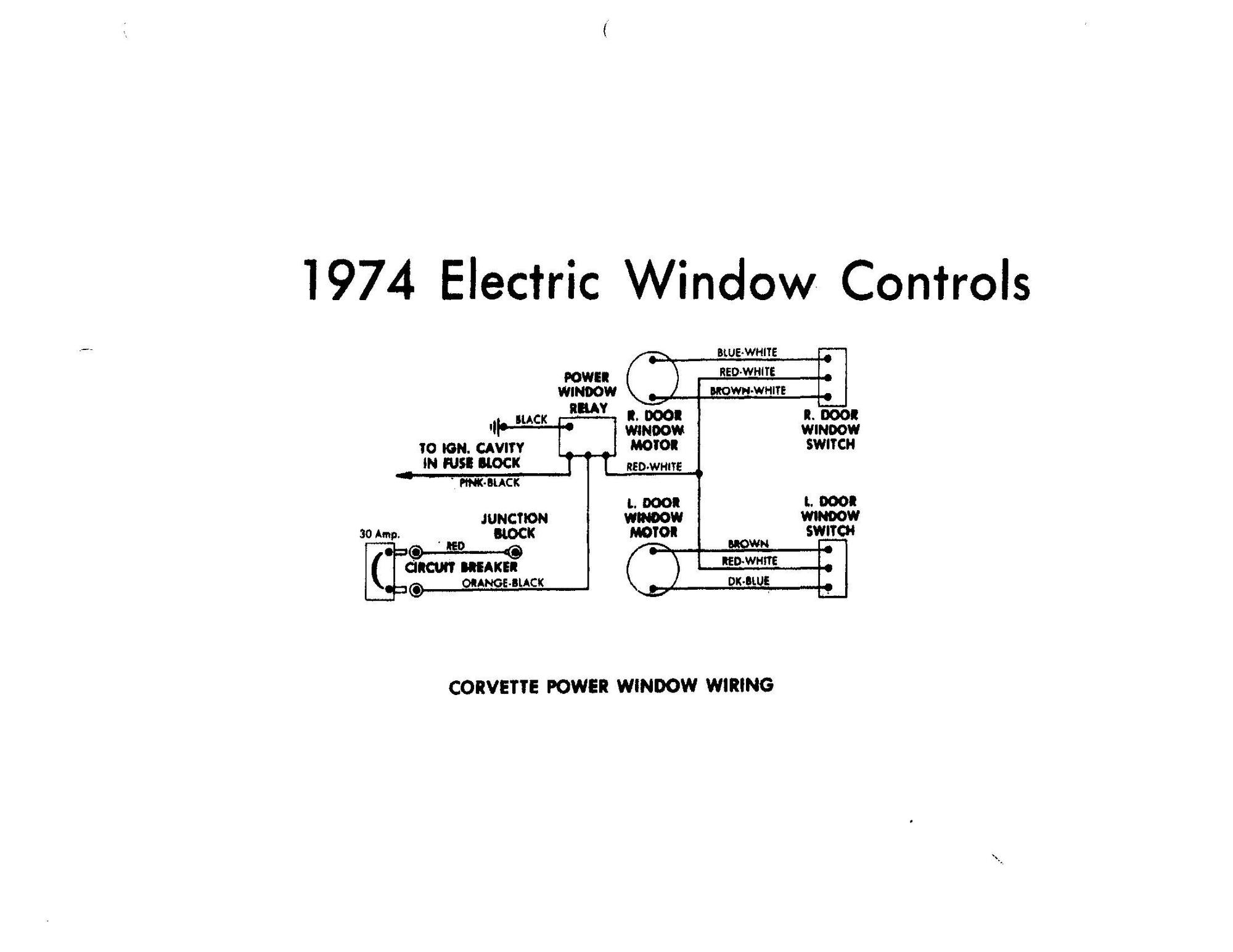

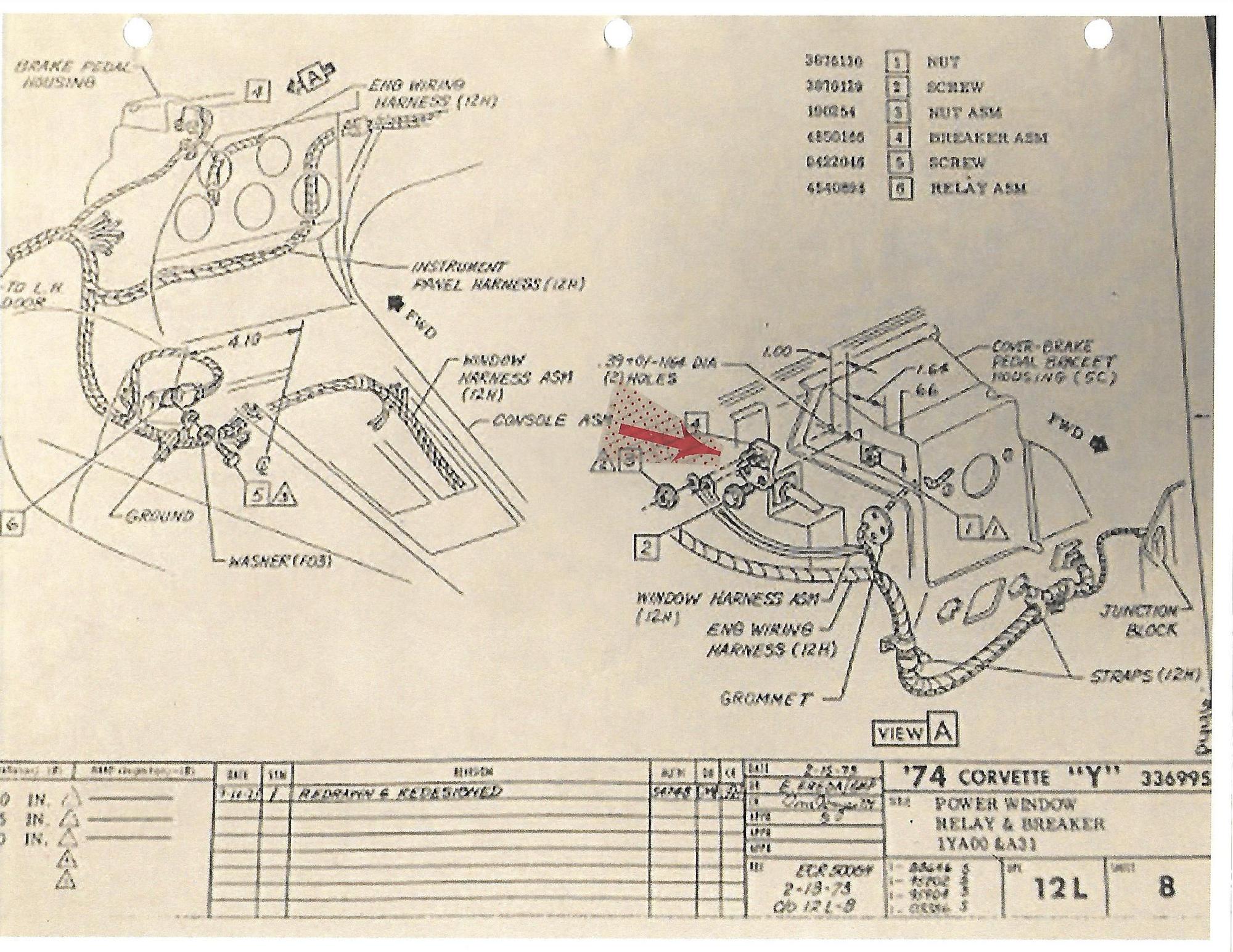

So a little update. I found the problem for the windows and the heater. I was watching a video on you tube and they had shown a relay that was hidden under the tachometer cluster screwed to the floor. It was missing on mine. I put one in and boom it worked. The same thin goes with the heater. There is a relay on the engine wall where the wires connect, I pulled the connectors off and bypassed the power and bingo bango the heater worked. Like I said before the harness is in really bad shape so I will be ordering a new one. I have a couple of of wires cut off the harness that I believe feeds the windshield washer motor and I believe that it all has to be connected to complete the connection. You can correct me if I'm wrong.

Old May 9, 2020 | 05:16 PM

Do you have a circuit breaker mounted on the firewall next to the power booster?
