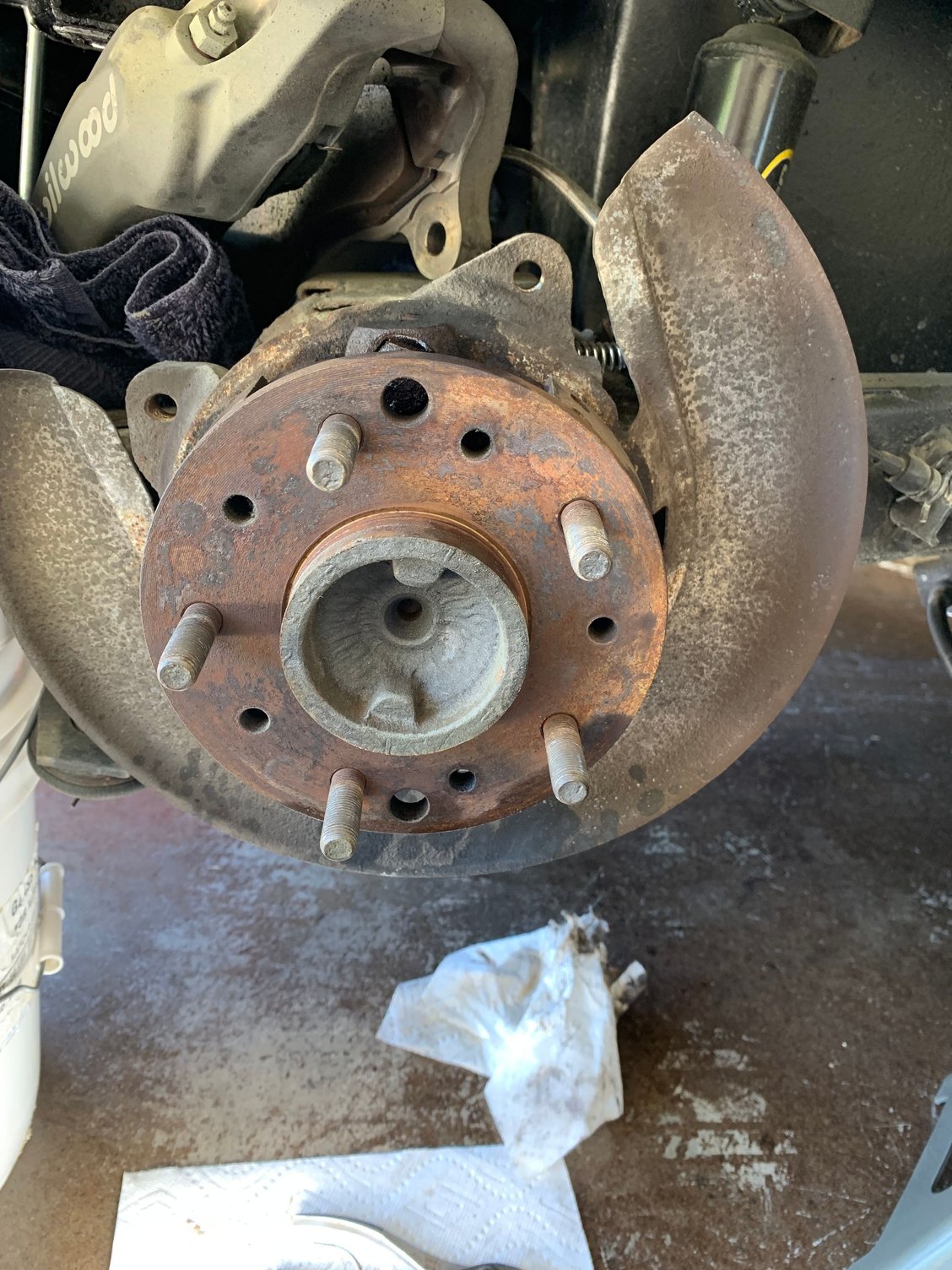

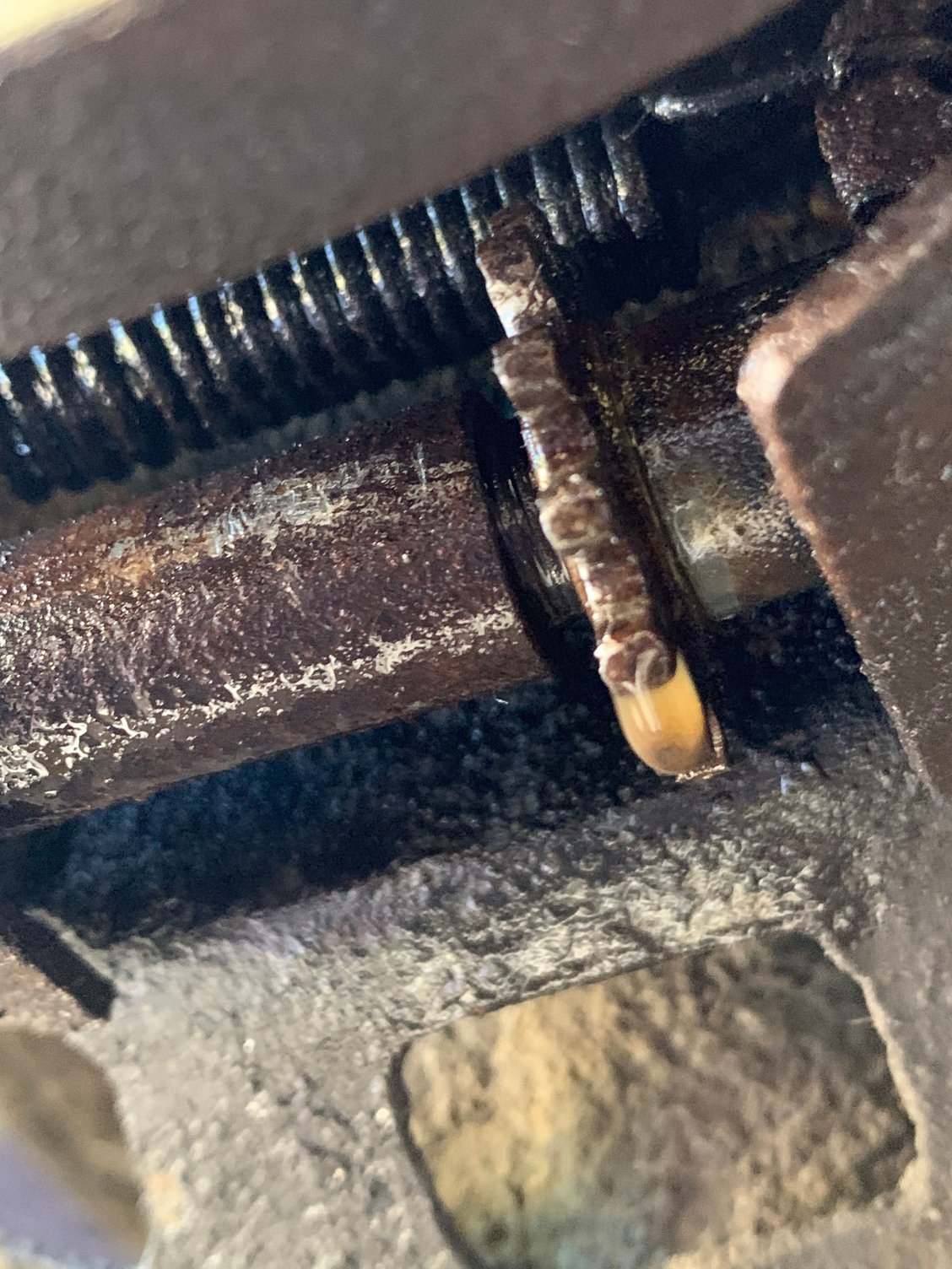

The Adjustment star on my passenger side E brakes is rusted tight.
I do not think it is going to break free.
How much of a job is it to take this apart ?
I see a bolt on the top and a spring on the bottom that I can get to.
Thanks.

Can the bottom edge of the shoes be spread apart and the star wheel assembly be pulled out?
YES ! I did it spread them and pulled it out.
thank you !

They are all the same for 65-82. If you plan on cleaning it up and reusing it make sure it is clean and use never seize on it. If you go new they usually come in too long so listen carefully for the shoes hitting the rotor hat.
