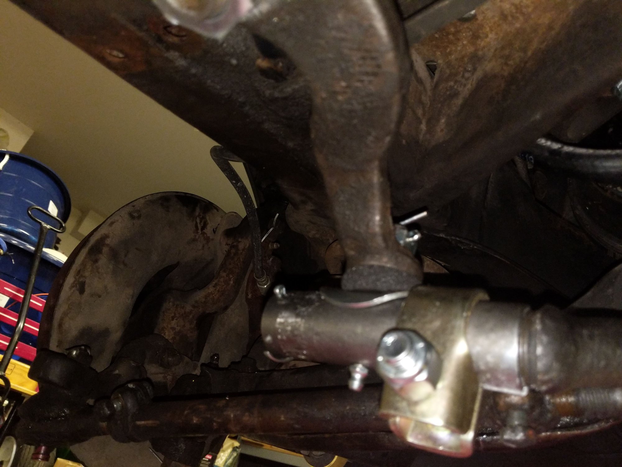

I've searched every Borgeson conversion article and forum thread I can find, but having no luck finding my certain issue. I got the entire thing installed, and when I went to connect the pitman arm to the drag link (which was an absolute bear), the pitman arm was about 3/4 in. from the bolt on the drag link. The drag link is about 1 turn away from being bottomed on the drag bar, but there is no way I can muscle it around, and there was two of us taking turns....it was tight.
So, connected by turning the wheels slightly to the left to make the pitman and bolt line up, and this is of course with the wheel centered....no big deal because I straightened it at the tie rod. So here I am, wheel centered, tires straight (as I can do in the garage), and when I turn the wheel right, I get exactly 1.5 turns right, and the wheel stops. When I turn the wheel left, I get 1.1 turns left, and the back of the steering knuckle comes in contact with a bump stop on the lower a-frame. I don't understand where I went wrong......HELP :-)
P.S., I have a black on black 78 Corvette for sale after this with a new Borgeson box
Notice the vice grip marks from cranking that drag link on.....It was incredibly tight, but no surprise judging how hard the old one was to take off....It appeared the threads had been buggered up by a previous PSCV replacement.
Believe I have the pitman on the correct direction

I know I centered the box before I installed it, but it's possible during the "in and out" of screwing with trying to line up the rag joint that I could have knocked it to one side or the other....Does it appear I have the pitman in the right direction? It seems like I do from the other pictures I can find, but want to be sure....It's facing the front of the car, and the curve is as depicted.
