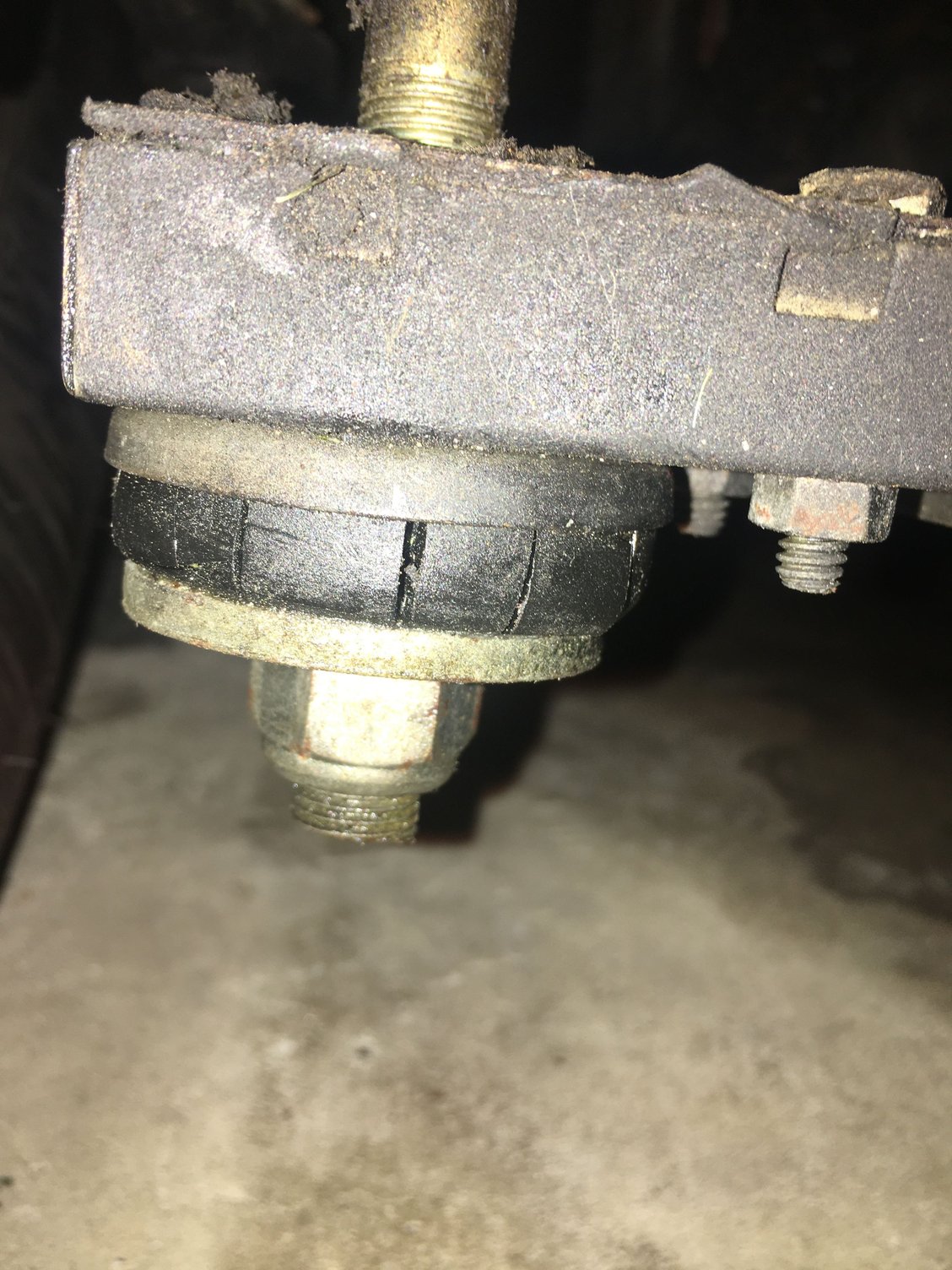

Have a dual mount rear VBP composite spring and it looks like the bolt bushings are shot esp the top ones. What is the best set to use and can stock ones be used with the VPB spring? Saw on one thread which I can’t find again that poly bushings weren’t recommended

Do the stock ones look like what you currently have?

yea kinda I haven’t taken them out yet and they are missing a bunch of The material see pic I posted
the ones on the front VBP mono leaf spring look to be the same and are in better condition but still crumbling I don’t think they are poly As they feel more like rubber but I don’t understand why they have those slits in them as it seems that’s why they failed
her are pics of front one top and bottom bushing

I think you can use the stock ones, are those really slits or cracks?

looks like oem ones fit.. I used poly USA made energy, work fiine ..any idea if those were USA made ?
that second pic is the top of the spring bolt? or control arm?
dont know they were on the car When I got it
yes the last two pics were the top and bottom of front Leaf spring Outer mount
not sure whether to get rubber or poly it’s a sidepipe car and there was suggestion of heat problems with the rear, I’m just driving it on the street
i think they are slits look too perfect And evenly spaced to be cracks
