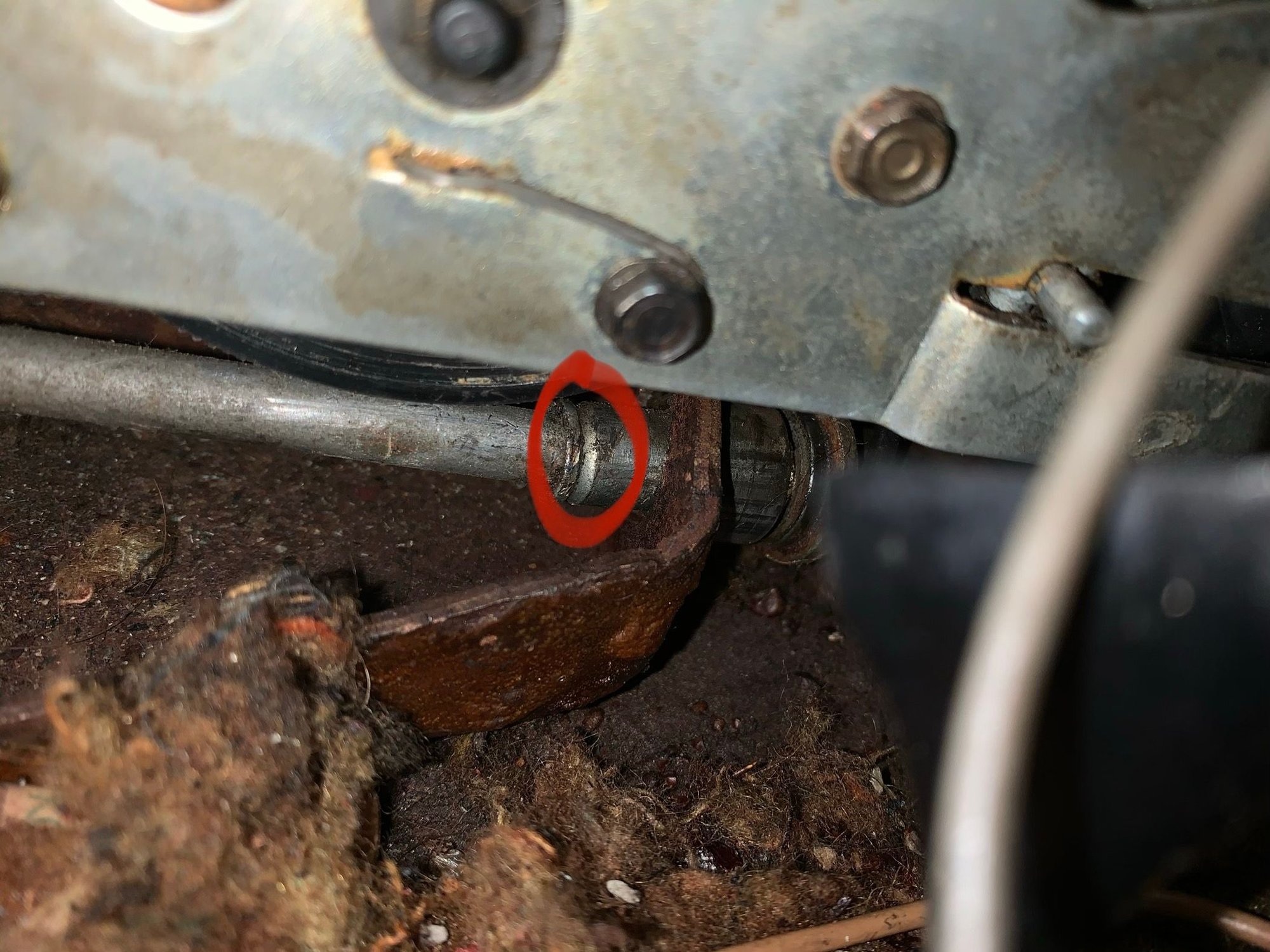

Update! Figured out the problem, which was up top in the shifter console. The shifter cable was not secured and managed to fell through the opening, which made it unable to correctly shift. If I’m not mistaken, I’m missing an “E” clip as shown in the picture? The purpose of the clip would be to prevent the shifter cable from falling back through that opening again.
Good catch. The e-clip doesn't go where you circled in red. It goes in the next groove just to the right of your circle. Pull the cable housing until the e-clip groove is on the same side of the bracket as your red circle. Measure the groove for the right e-clip. The shift cable I just removed from my '73 required a 3/8" e-clip but the new cable requires a 1/2" clip.
