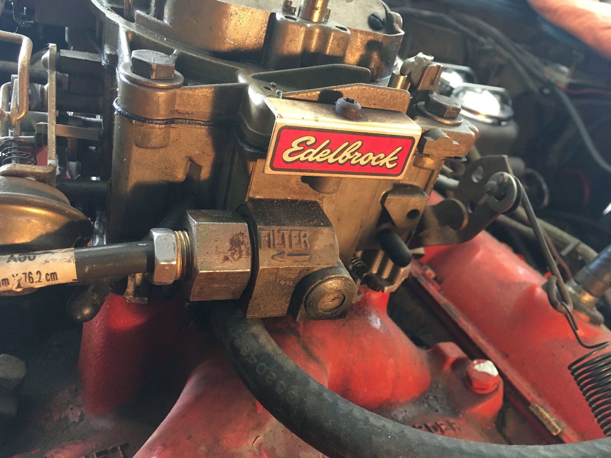

What fuel filter plus spring does this use?
The tubing connector is longer than the one on the Holly (6210) it replaced so all I have in there now is the short 'stone' with spring from a Rochester.
It doesn't appear to stack up long enuf.
Thanks in advance fellas!

I suppose if you called Edelbrock with the carb number they could tell you.

Those are nice carbs. Pretty sure it uses same parts as Rochester QJ.
Maybe Lars will chime in.

It uses the Quadrajet filter and spring because it is a Quad with a Edelbrock label.
Read this to determine which filter you need the 1926 style or 1927 style
https://edelbrock-instructions-v1.s3...brock/1926.pdf
https://www.edelbrock.com/fuel-filte...-jet-1926.html
https://www.edelbrock.com/fuel-filte...-jet-1927.html

short filter is wix 33051 https://www.wixfilters.com/Lookup/Pa...spx?Part=60813 (for ebrock carbs 1901 & 1902)
https://quadrajetparts.com/short-pap...alve-p-79.html
long filter is wix 33052 https://www.wixfilters.com/Lookup/Pa...spx?Part=60949 (for ebrock carbs 1903, 1904, 1905, 1906 & 1910)
https://quadrajetparts.com/quadrajet...-c-128_54.html
Wix quality and either are about Two bucks each at RA

The so-called "Edelbrock" carb is a Q-Jet. It uses stock Q-Jet parts and components.
The filter is available from NAPA under part number 3051.
The spring is available from NAPA under part number NOE 7321078 or from Carbs Unlimited under part number CUFSS

Thanks fellas. Just the kind of information I was looking for.
Parts store in my end of town has an extensive Wix inventory. Perfect!
