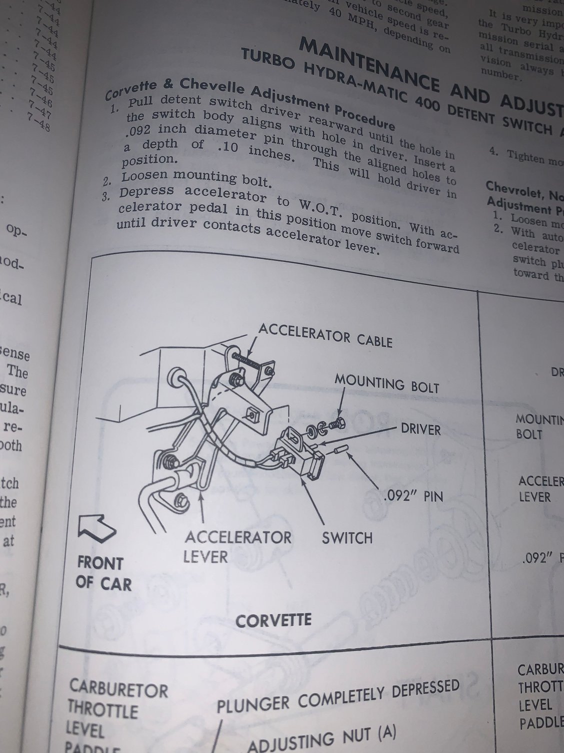

From most of the posts I have read on here, the short side of the accelerator pedal is pointing towards the passenger side. However, my service manual shows the short side pointing towards the drivers side. It almost appears as if the lever in the manual has a different orientation than the one I ordered from zip. Also, any tips on installing the accelerator cable would be very much appreciated! That one bolt that secures the accelerator cable way up there is really tricky to get!

I would look at how your existing one is bent at the cable attachment and orient the new one to match that part and ignore the short clamping arm. I think the bend is more important to the cable angle and wear.
I would have it so it is bent so that it is parallel with the fire wall like the pic

There is only one way where it lines up with the hole coming through the firewall but I can’t remember which way it was but should be obvious when you look.

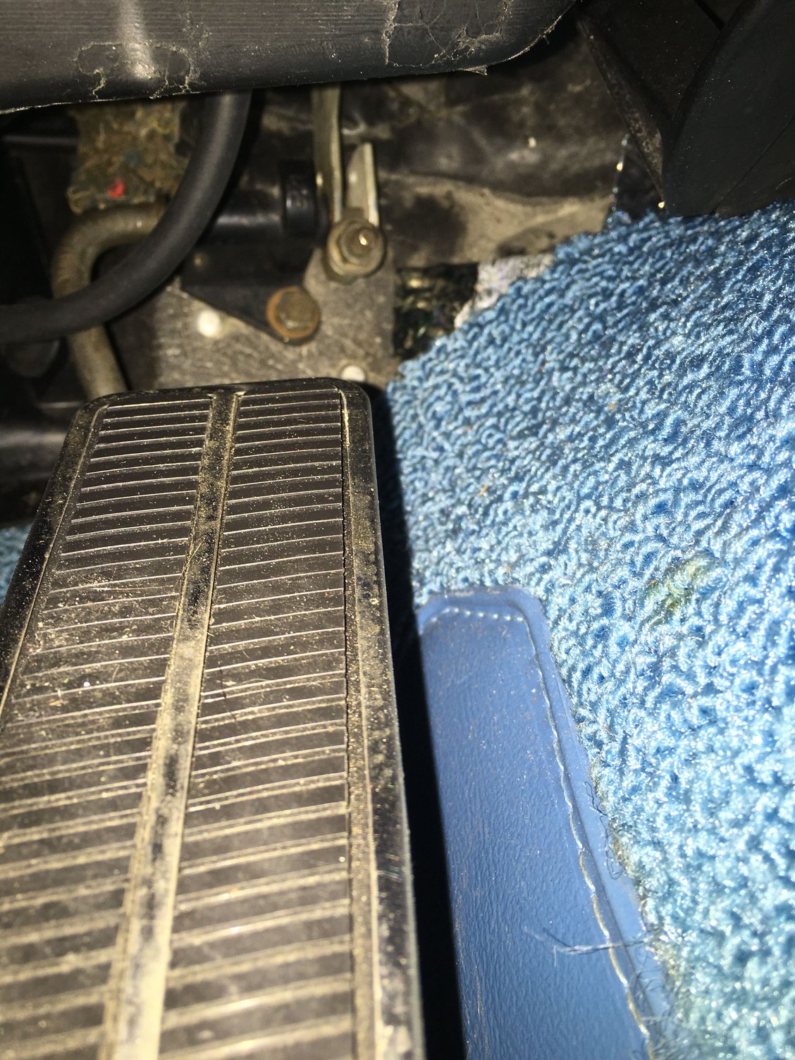

Here’s a pic of my early 69

Solved! Ending up going with the orientation where the top of the accelerator lever is parallel with the firewall. Figured that was the most important thing. Thanks for all your help!
