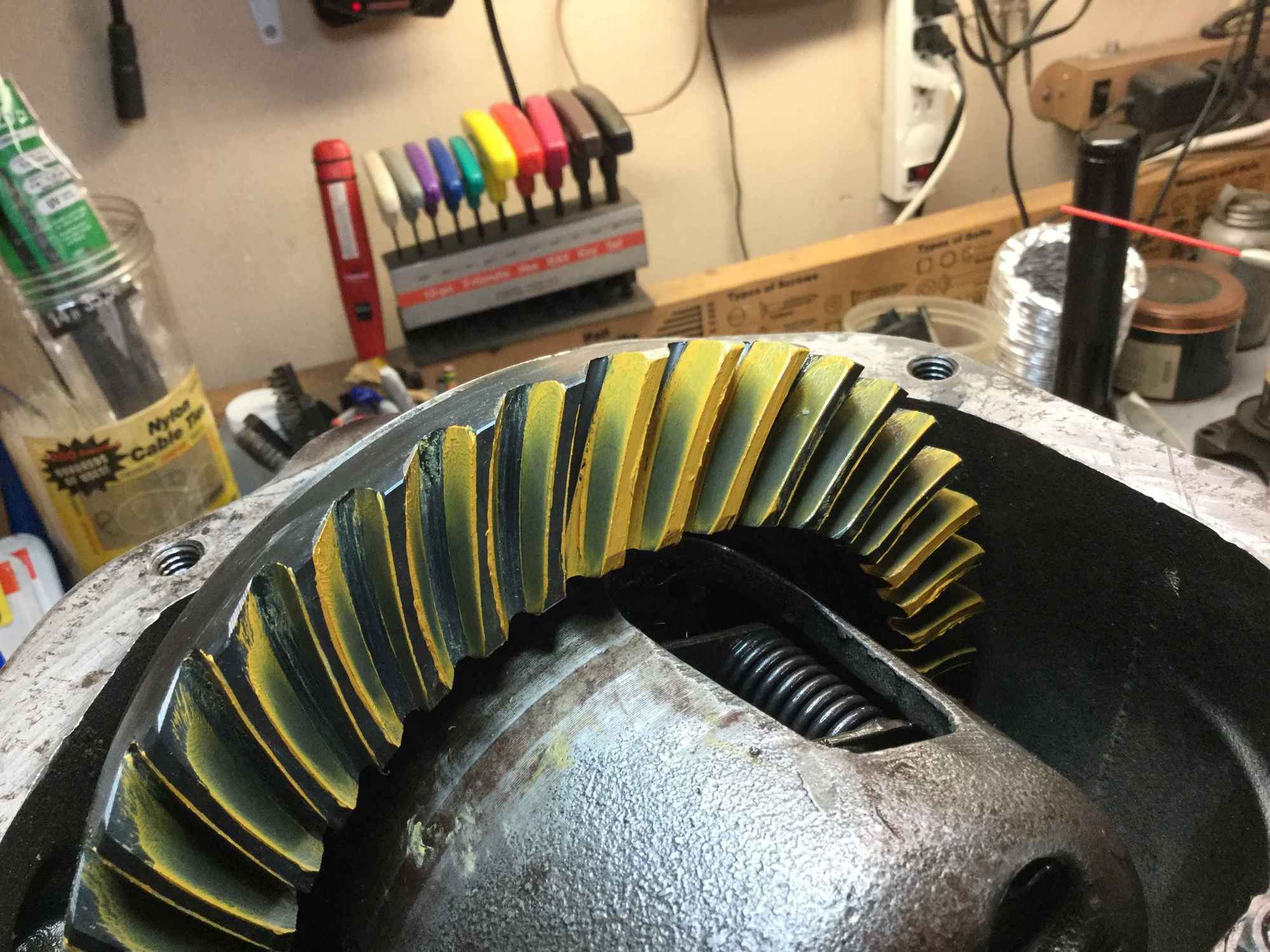

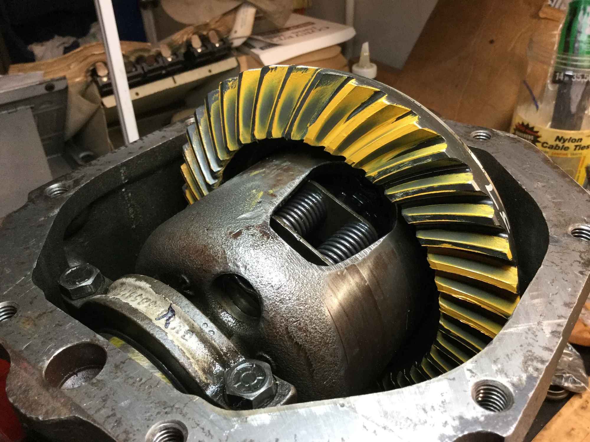

I finally decided to ditch the 4.56 gears that came in my 1968 convertible after 16 years. I've gotten a lot of help from several posts on this forum and, of course Gary (GTR1999) who has tolerated my long list of questions. I've switched back to a set of US Gear 3.73s (the car originally had a 3.70) and have gotten the pinion depth set spot on and have the checked the backlash at 10 spots with readings from .008" to .009" . I've run the gear pattern with load on the pinion, using a rag as several others have suggested, and would like some feedback on the pattern. I ran the pattern at three different locations and all are very similar.

With my Jeeps I was thrilled with that pattern!

Pattern looks really good on drive and coast sides. It shouldn't "sing" to you.

Pattern looks good. The drive and coast are equal in length. Set up looks to be typical US Gear.
The lash is looser then I set with new gears, I would get that pattern with 5-7 lash and it will open up about 001 once broken in. The paperwork that comes with the new gears now has a paragraph explaining to expect some gear noise and this usually shows up in deceleration in the 45-55 mph range, it is very common to hear it with these gears now -more so then several years ago but they are still good and should not cause an issue.
Once the final preload and lash is set do a last pattern run and it should not change.
I would polish and radius the case better then I see but that is your call. Use socket heads in the caps for a little extra strength.
