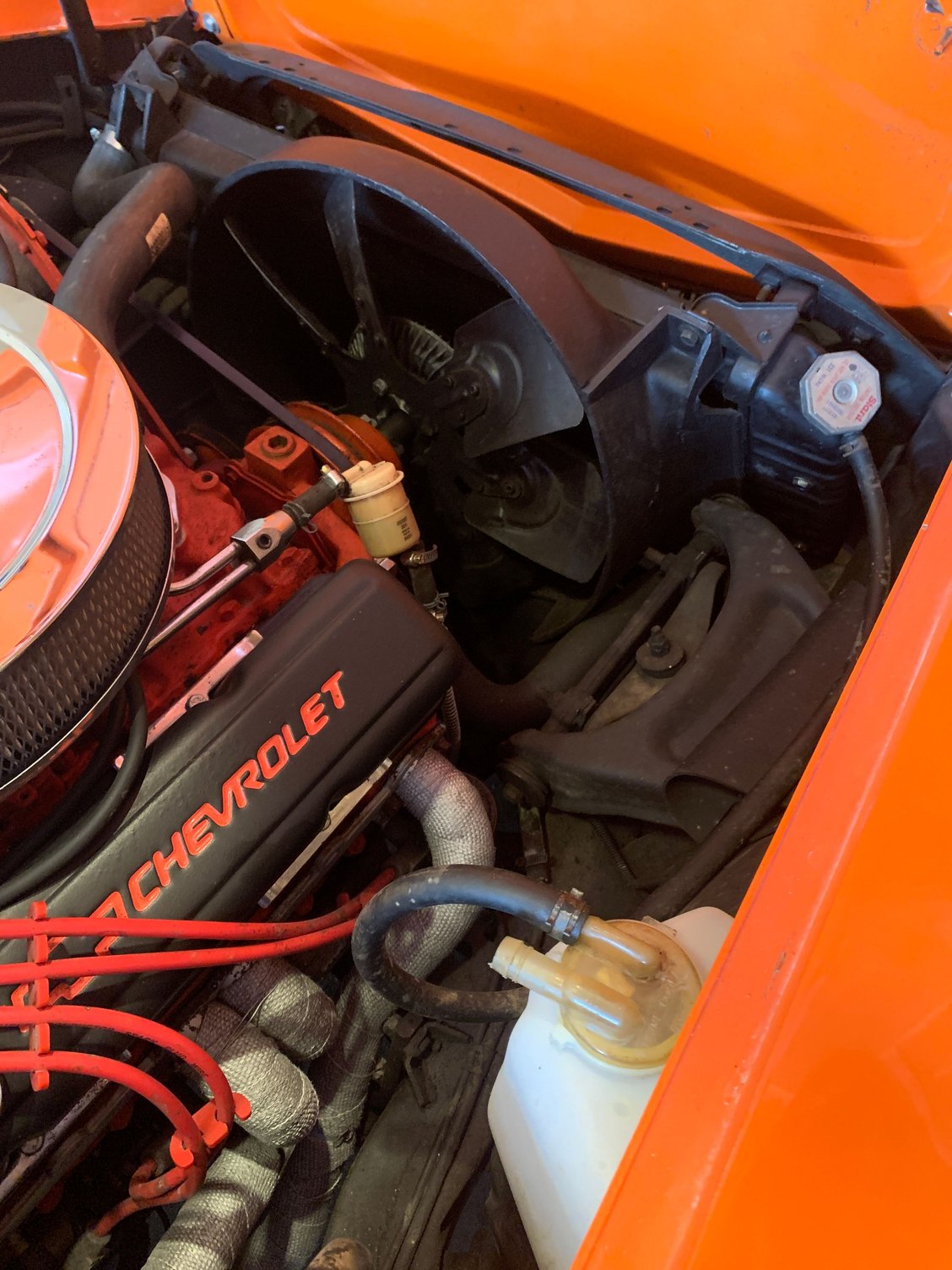

So I just bought this 77 Corvette yesterday. The previous owner is a great guy was very upfront with a lot of the issues with it. His biggest issue has been the cooling system from my understanding. Car drives great. (Drove it 90 minutes of the highway to get it home.) the previous owner said the cooling system way “unhooked”. Looking at it, (picture attached) there is no overflow hose going to the expansion tank. There is a hose that connects the tank to the radiator, however the tank is almost empty. The previous owner says he has been driving the vehicle like this for years and has never had any issues with overheating. What would be the proper way to attack these? Additionally where does the overflow hose attach to?

The tanks caps nipples should face forward then you can shorten that hose a bit to the Rad Cap, away from the header.
On the other nipple I installed a short piece of clear hose and aimed it at the ground, down a ways. That second nipple is just for the unlikely event the Rez ever overflows it will not burst. I use the clear hose so I can tell at a glance if green antifreeze has been there. Never has in 12 yrs.
And you want to keep the Rez about half full. Or half empty depending on attitude.
And last but likely not least. When the P.O. said "unhooked", he was referring to the fact that there are no heater hoses. This might be a 'red flag" that the core was leaking on the carpet. So, you will have to pressure test the core to see if there is a leak and then decide to replace or ignore.

Does it overheat? Measure with an infrared thermometer (don't trust the gauges). You are missing the foam that goes around the radiator to force air through it.

It looks like there is a hose running from below your rad cap to the top of the plastic tank on the passenger side inner fender. The other connection on that cap is for a larger diameter overflow hose directed downward toward the ground.
Your heater hoses are definitely missing, same as on my 77. I have never missed it. You are probably missing all the seals around the radiator and seals between the shroud and the radiator. All these are critical in forcing air through the rad rather than around. it. There should also be a black plastic air dam mounted under the front of the car to direct air up to the rad. The pic below is my 77. You can see some of what I'm talking about.

I don't believe the O.P. can use the foam rubber at the top of the Rad. Looks like when the P.O. was removing the A/C compressor & hardware, the condenser was removed along with all the foam seals. Is there a aluminum plate that would fit over that Rad gap and force the air through?
Heads UP
I see what you mean looking at his pic. Not sure why his is different than mine. My car is a 77 which originally had AC. I removed the compressor, condenser and evaporator. The light colored seal at the top of my radiator fills in the gap where the stock L48 outside air intake was.
I took a look at my car and his radiator support looks different than mine. That's what creates the big gap in front of his radiator. This really opens up a can of worms.

I agree. I too have a "77. (But with A/C condenser left in place, not working) His photo of the Rad support does not look like mine either.
If I had to guess, I would say maybe the Rad support was swapped out with another yr. Some model yrs seemed prone to rusting out at the bottom more than others. I believe the support is just bolted in anyway.
IDK

It looks like you guys are right in that I am missing the seals, and there is not anything on the bottom to force air up through the radiator.

The core support does look like the one in my 77 (Late model)
The upper radiator mounts look to be missing the rubber cushions, the radiator looks to be sitting against the metal mount and the radiator is a bit far from the support.
I used pipe insulation and built a cover for the top of the radiator to hide the gap, once the radiator mount cushions are in place the gap is a lot smaller and there is a large piece of foam included with the radiator seal kit that will fill the gap.
