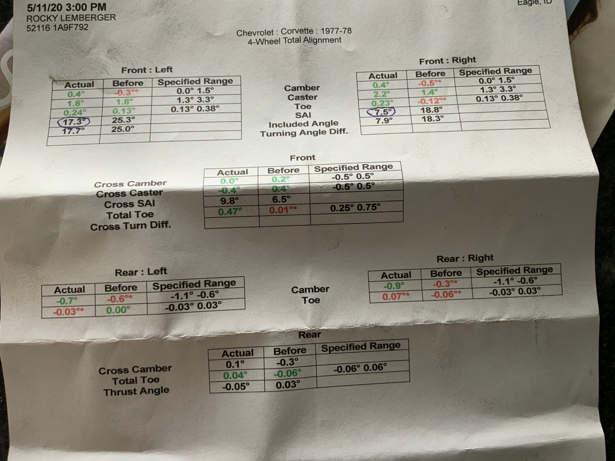

I took my 78 in to get a four wheel alignment and the kid that worked at the shop worked on it for quite a while but could not get it right. He thought the bushings on the rear controls arms Or trailing arms were causing trouble. I was told that our locale Les Schwab there is a alignment tech that knows older cars so I took it there today. He worked on it for 2.5 hours and said it all looks good but it still pulls to the right. He said he even swapped the wheels from side to side to see if it was the tires. He said the SAI looks off but that is not something he can adjust. Any ideas?

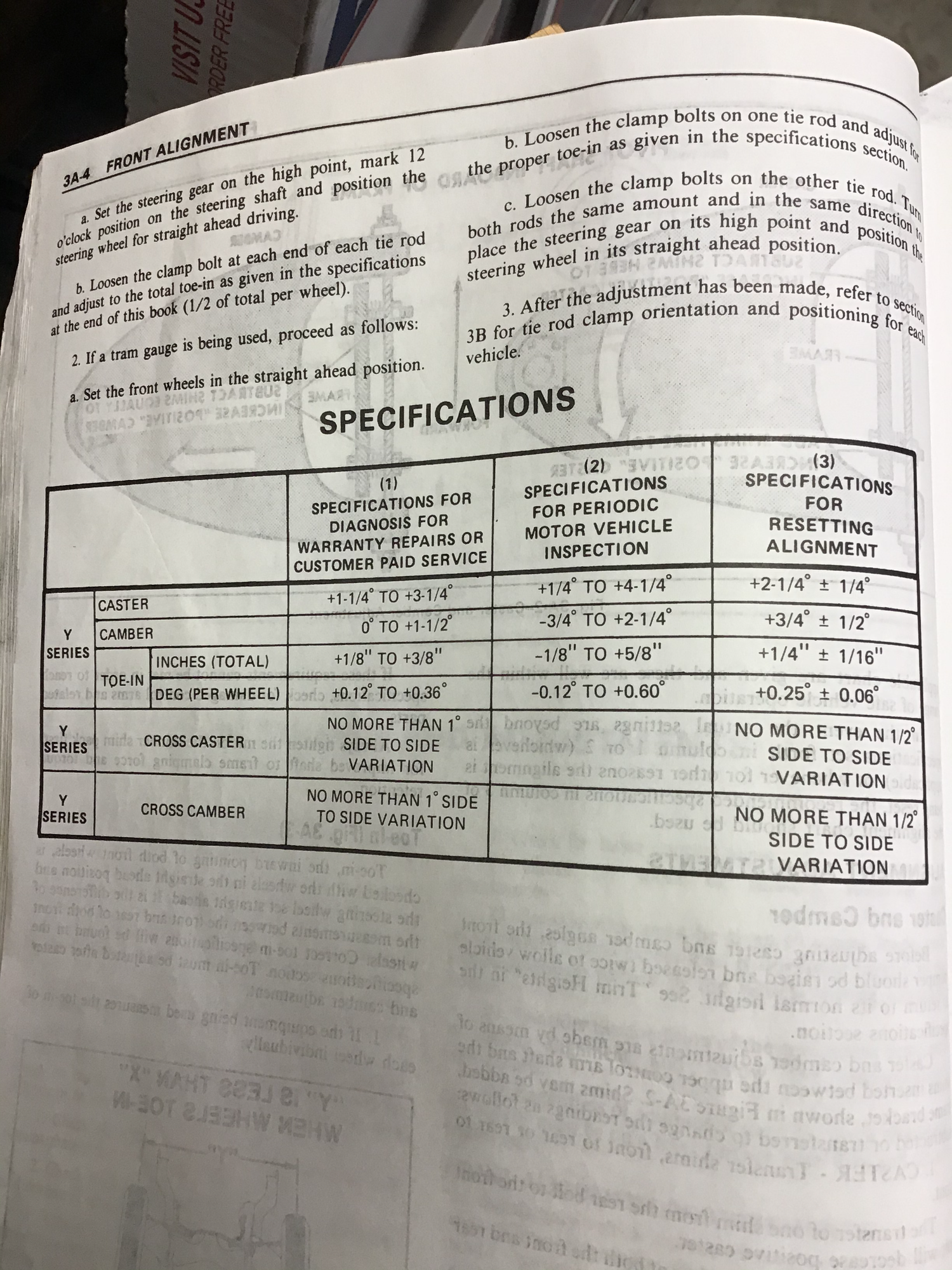

i will post 79 manual specs

"IF" he measured it correctly, that would mean a bent spindle. Or a completely dead wheel bearing.
If it is truly 10 degrees off you should be able to measure the spindle angle with your smartphone and confirm.
What concerns me is he did not make a big deal about it, or maybe did not understand it......

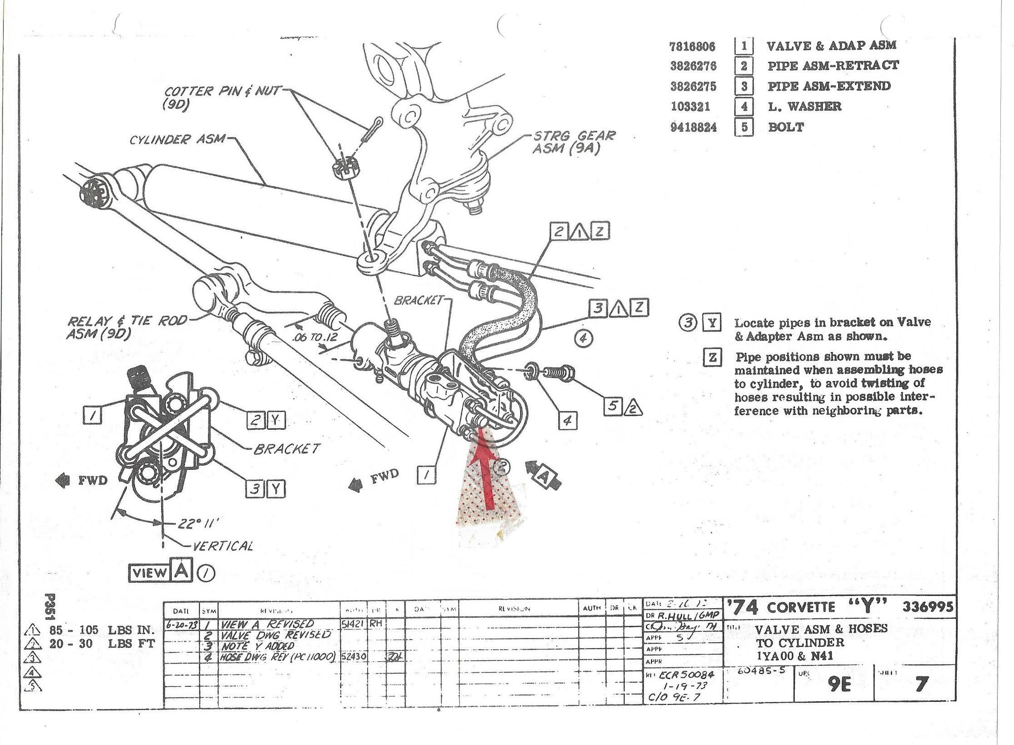

You might want to check that the power steering control valve is balanced properly.
You can do this test yourself, here's how:
The adjustment is under this cap:

I did just recently have the controls valve replaced. Maybe the mechanic did not balance it. Would that effect the SAI?

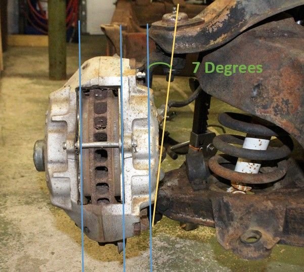

Sorry bent spindle. IF his measurement is right.
Otherwise bad technician.
Mine measured at 7 Degrees SAI.
Your 17 Degree one is off by a lot!!!

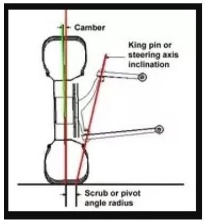

Your Camber is really good at 0.4 both sides. So it is easier to ignore vertical. Then it is pretty much the angle between the ball joints and the rotor. Same as kingpin angle.
Car Probably hit a curb at some point.
It should be really obvious if you pull the wheels.IF it's bad. The top edge of the triangle by the ball joint would have to open up to like 2 more inches to give you 17 degrees.
Take a look at your alignment shim stacks on both sides, they should be even.
It is so far off I feel like he did not measure or hook-up something right.
Just eyeball like I did. Do they look the same? Or does one side look way larger?
I'll bet you find the SAI looks & measures OK if you do it.
He managed to change the SAI 11 degrees on one side and 7 degrees on the other? Before/after.. And he said it wasn't adjustable?
I vote for Operator error.
Other than that alignment looks good, stock specs, but good.

thank you. So this is measured wheels off suspension hanging?

Sure. take a picture. draw lines between the 2 ball joints & parallel to the rotor.
Bet it's OK.
