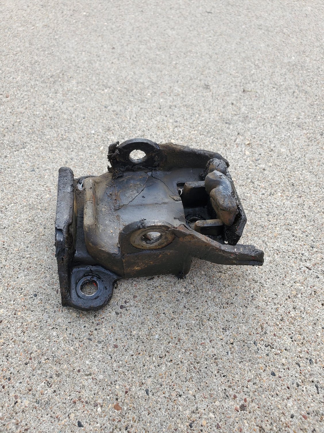

Hi all - having my small block rebuilt out of my 1970. While the motor is out, I'm looking at various things. I'm sorry for what is probably a dumb question...but how do I know if I should replace the motor mounts? Here are a couple pictures of one of mine...obviously if they need it, now is the time to do it! If you think they need replacement, any recommendations? Thanks all!! Hope you are staying healthy!

I've broken a couple of left ones. Those look fairly old. For what they cost. Just replace them. As per type, I just run the stock style ones like you have there. Available from all the Corvette vendors and most auto parts stores.

It's a crap shoot. They may last forever or they may break tomorrow.

No hard to replace with the motor in the car, but a no-brainer with the engine out. Get some good OEM or Energy Suspension mounts. If you have headers the the poly in the ES may be an issue, in that case use Moroso solids.

I had ES red poly mounts in our 75, they broke after some runs at the track and about 1000 miles. We went to solid mounts and never looked back. On my street car they have been ok. If I was to replace a set now I would go back to rubber factory type.

Get factory type rubber mounts from a local store. (If they don't look to be good quality, you can return them.)

I would only replace them if they are the 2 piece style.

How do you know if you should replace the mounts? Easy question. If they are old and GM its a no-brainer.
Some of the older folks will remember one of the largest recalls in automotive history. Chevy V8 rubber engine mounts. Thousands of them separated. In some cases the throttle was held open. Not good times.
Buy Moroso Solid mounts and use a drop of LockTite Blue on ARP bolts. Its the right choice and the right thing to do. (sounds like a commercial)
And never use solid tranny mounts, Something has to give a little with the torque. So let it be the trans rubber instead of a cracked tailshaft housing.

For primarily street cars:
All 'round stock rubber works just fine for most.
Keep in mind how mounts fail ... under gross tension; Not compression.
Driver Left side is tension (lifting) side ... Passenger Right is compression side.
If you demand solid on street ... use one solid on Left and rubber or poly on Right. And No solid under trans.
Poly often less heat-resistant than most rubber mounts
