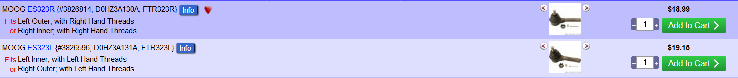

moog-es323l-inner-driver | Front Left Inner Tie Rod | Chevrolet Corvette | MOOG

i feel much better. 2 conflicting ways to install them. left hand treads to the right of the tie rod, or left hand threads to the outboard side of the tie rod.

The clamps, as pictured in post 10, are specific side to side (not the clamps themselves, but the orientation), so if you assemble everything off of the car, it will matter which assembly goes where. But right hand vs left hand is your own preference.

so i assume right handed threads are the insides on both sides of car and left handed threads are on the outside, right?
Old May 21, 2020 | 12:14 PM
Peterbuilt's Avatar
Peterbuilt
Joined: Aug 2006
Posts: 7,427
Likes: 1,560
From: mount holly NC
Default You got it!
Originally Posted by babypig
so i assume right-handed threads are the insides on both sides of the car and left-handed threads are on the outside, right?
yes!
