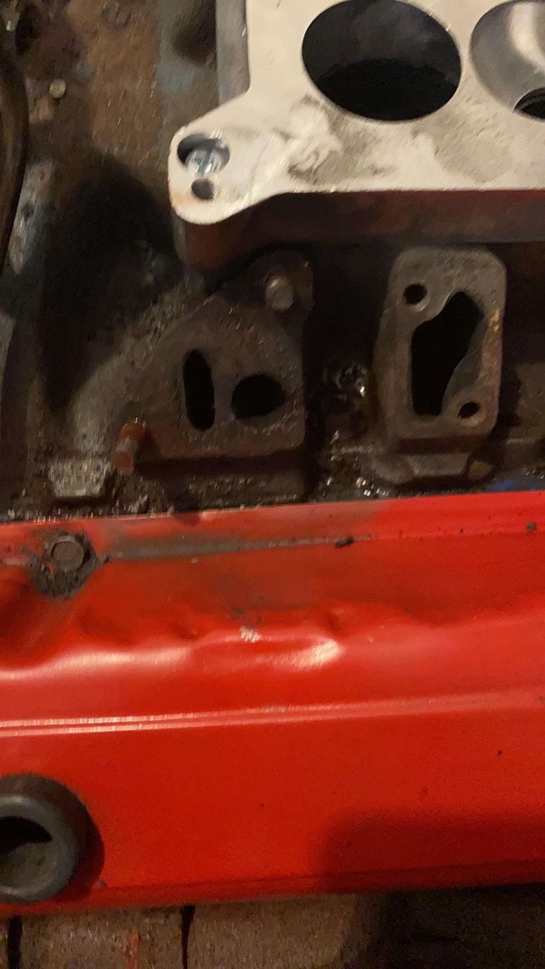

I recently put an Edlebrock AVS2 on my 79 c3 and blocked off the egr and choke diaphragm. Is it possible this would cause the intake to overheat/retain heat? Thought a bad thermostat was the problem but it seems to be something else.

What do you mean by choke diaphragm?
The carburetor uses an electric choke so exactly what did you do, a picture might help.

From the Quadrajet that was on there before. Had to block off these for the edelbrock to fit. Egr was on the left of the picture, choke diaphragm on the right.

On the right, that's where the heat stove goes. Before you get 800 more questions, can you confirm that your electric (?) choke is: 1. Electric, 2. Connected, and 3. Functioning properly (opening confirmed after warmup)?

The edelbock is a square bore carb and you need the metal spacer adapter or you'll get a really bad vacuum leak at the spread bore rear of the manifold. But it requires gaskets above and below...it won't change anything performance wise
