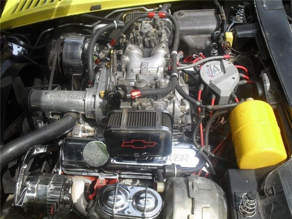

But superchargers just look cool and saying u have a supercharged vette is a good thing.. My B @ M supercharger with a side draft setup.Lots of HP and sounds good when it revs a bit

Are those delorto carbs or webers? What intake are you using? Very cool set up!
