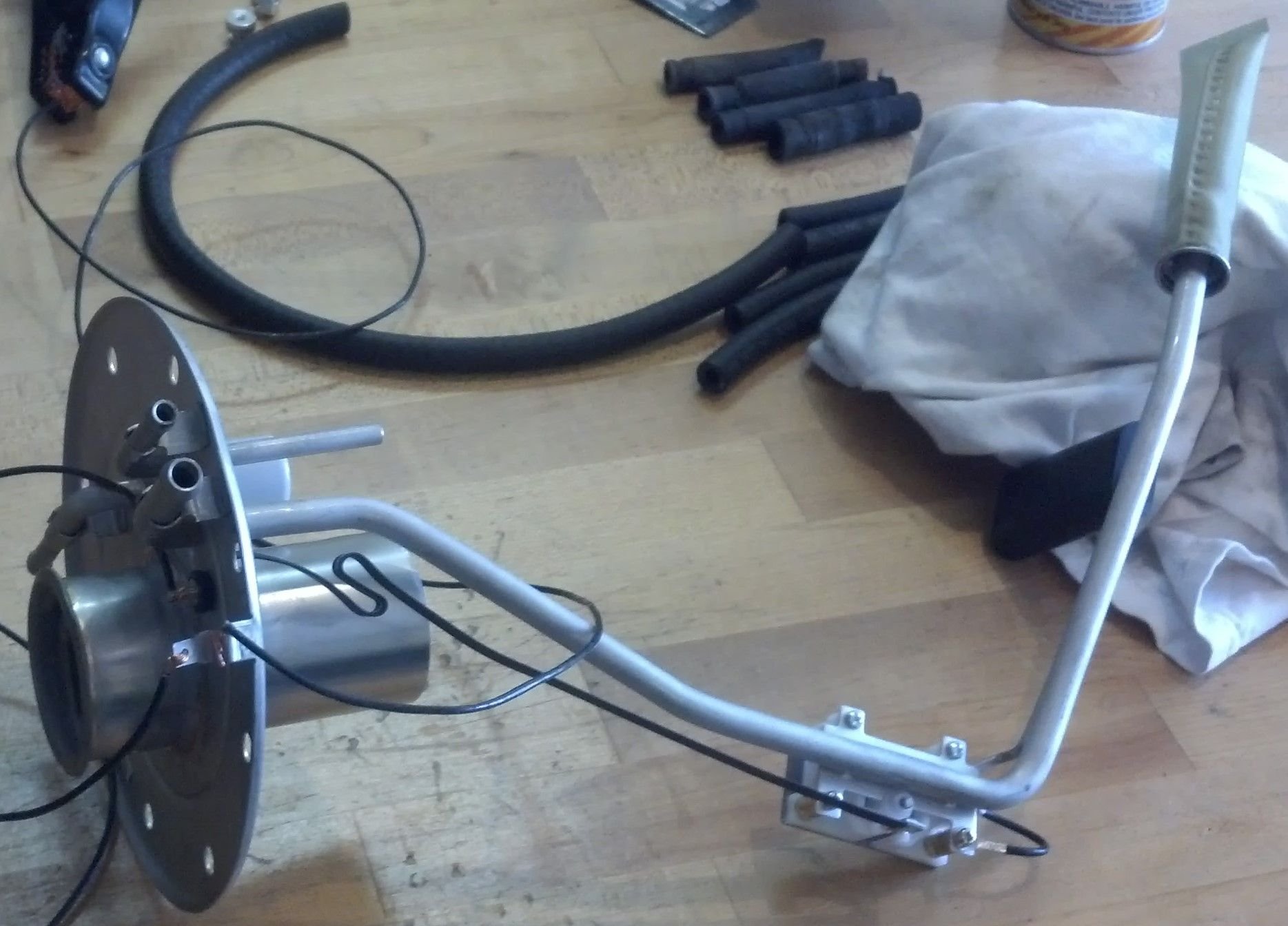

Context of question: I've removed my sender (and replaced) both with the tank in, and out. I currently have the tank completely drained but installed due to an EFI / fuel pump upgrade. The tank (unfortunately) has been sitting idle and drained for a couple of years. I've checked and validated my gauge is working fine on a 0-90 ohm scale. I've checked the cars wiring, that is fine. The sender is "sending" a resistance in the 50K ohm to 140K ohm level. I removed the sender (again), and at the output of the potentiometer, the reading is perfect. About 1-90 ohms. The problem is the "ribbon wire" that goes from the output of the potentiometer to the top of the filler cap. Now for the questions:
Can this wire be replaced / repaired?
Has anyone ever done this?
It's going to tick me off if I have to buy another sender. This one is new albeit its been sitting in air for a couple years in my tank. It worked when I installed it. I even validated that with pictures a couple of years ago.

Thanks, grounds are good. Everything is good - except the ribbon wire going from the potentiometer to the filler cap connection point. I'll add a picture. Can that ribbon wire be replaced / fixed? What is its design purpose? Other than not changing resistance in the circuit, what function does in provide?

I guess that is the crux of my inquiry. I know what is wrong, I want to know if anyone has replaced that ribbon wire, and if so, what did you use in its place?

Well, the problem is fixed. The problem was the ribbon wire - but specifically the connection at the top of the assembly where it connects to the terminal. There was a bunch of corrosion material built up between the wire and the terminal. So, I removed the ribbon wire, cleaned the ends, cleaned the lower terminal where it connects to the potentiometer, and the upper terminal where it connects to the bulkhead. I checked the ribbon wire for resistance, and it checked out at about .6 ohms. So it was good. Once the terminal was clean the sender worked like a champ again. The output once again reads 0-90 ohms.
Once I finished re-installing everything - I checked again. The output measured about an ohm or less, and the gauge immediately went to a hair below empty. Moving on to the next thing...
