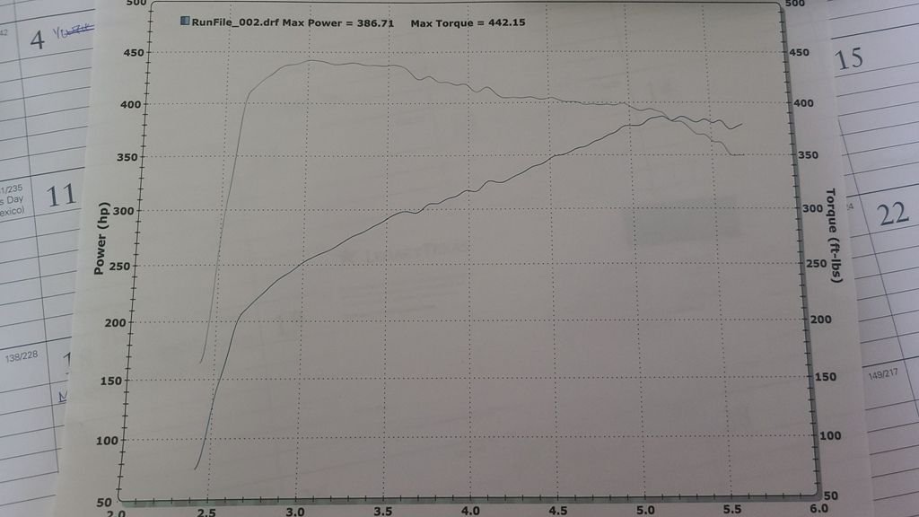

This is really just for healthy discussion for someone who is not nearly as familiar with carbs as late model EFI. So, I apologize from the get-go if this is just elementary stuff for a lot of you long-time, carb tuners. In my way of thinking, if the engine is getting proper fuel (based on A/F ratio) at WOT at peak HP/TQ, then its probably large enough. If that is wrong, please help with the education. Then I read a lot of these carb-sizing charts and formulas, based on BSFC, etc. Makes a lot of sense. Then there's information that says you can "over carb" the engine... something that really doesn't happen in the fuel injected world, as even very large injectors can be controlled rather easily with programming.
I have attached my dyno graph (chassis dyno... so it is rear-wheel numbers; best guess is ~470hp/520tq on an engine stand). I didn't build the engine in the car. I do believe it idles extremely well, has instant throttle response, and makes good, if not great, power... for what it is. Combo is a 468 BB, ~9.0+:1 CR, Pro Comp alum rect port heads, 240/250 duration, .570"/.570" lift, Herbert cams solid roller cam, LS6 low-rise intake, 2 1/4" Hooker primary long tube headers, with a custom 3" under-the-car exhaust all the way out back, topped by a Holley 750 mechanical carb. It has the choke tower, but no choke plate... the choke has been disabled... not a big deal for me down here in TX as far as cold starts.
I've been told the carb is too small, but then some of these formulas say with the rpms I'm turning (limited by the intake to some degree, for sure), I'm fine. Also, the WOT A/F ratio is very good (12.8:1... all the way across the rev-range). It's not running out of fuel, from what I can tell. For those who believe the carb is too small... would a larger carb help top-end power, even with the low-rise LS6 intake?
Just looking for opinions. The combo runs really well, and I'm most likely going to leave it alone until a) I build an engine for it someday, b) decide to get an L88 hood, run a high-rise manifold at which point I will strongly consider a new carb, and/or c) the carb needs a serious rebuild.

Maybe there isn't, and this is helpful. As you can see from the graph... the power levels out from 5200-5600rpm. I recognize this may be an ignorant question, but can a carb be too small and limit my top-end power production in the upper rpms? Sorry... I cut my teeth on late model EFI stuff... where throttle bodies and such could effectively limit airflow into the engine, and hurt power, regardless of whether the injectors are sized and tuned properly. That's kind of my angle behind the question.

Thank you for the reply, Lars. I certainly trust your advice. My thinking (from the EFI world) was in the right area... not fuel flow issue, but airflow restriction. And therefore was wondering if I'm limiting the airflow potential of my current combination based on the smaller carb size (we all know the intake manifold is not optimum, but its a stock BB hood). My gut was that the 750 is small, so it sounds like I might have guessed correctly... I guess a vacuum gauge run to the cockpit is in order.

I'm running an electric fuel pump. i need to check and see what it is (didn't build the combo). i may be wrong, but given a good, stable A/F ratio at WOT across the current rev-range, I felt it wasn't a fuel problem. Wouldn't it start to go lean on the top-end if I had a fuel supply issue?

Carb throttle plates are verified fully open. This was a chassis dyno run.
Engine dyno, my numbers would be ~460hp/520tq... which is not bad, considering the combo which is very streetable and pretty mild, IMHO. HP being flat from 5200-5600 with a good A/F ratio tells me it is an airflow issue. Cam (based on manufacturer specs) should make power to ~6200rpm, so peak HP could be obtained ~5800-5900rpm. Exhaust is not the issue. Heads are not what I would have chosen (I will swear by AFRs, and that is what will go on if/when I do a rebuild someday), but they should also not be a restriction at the rev-range where the cam operates. We all recognize the LS6 intake is a restriction. And so that brought me to the carb sizing question.
Probably not worth doing anything at all until/unless I take the plunge and install a new hood, hi-rise intake, along with a little bit larger carb.
