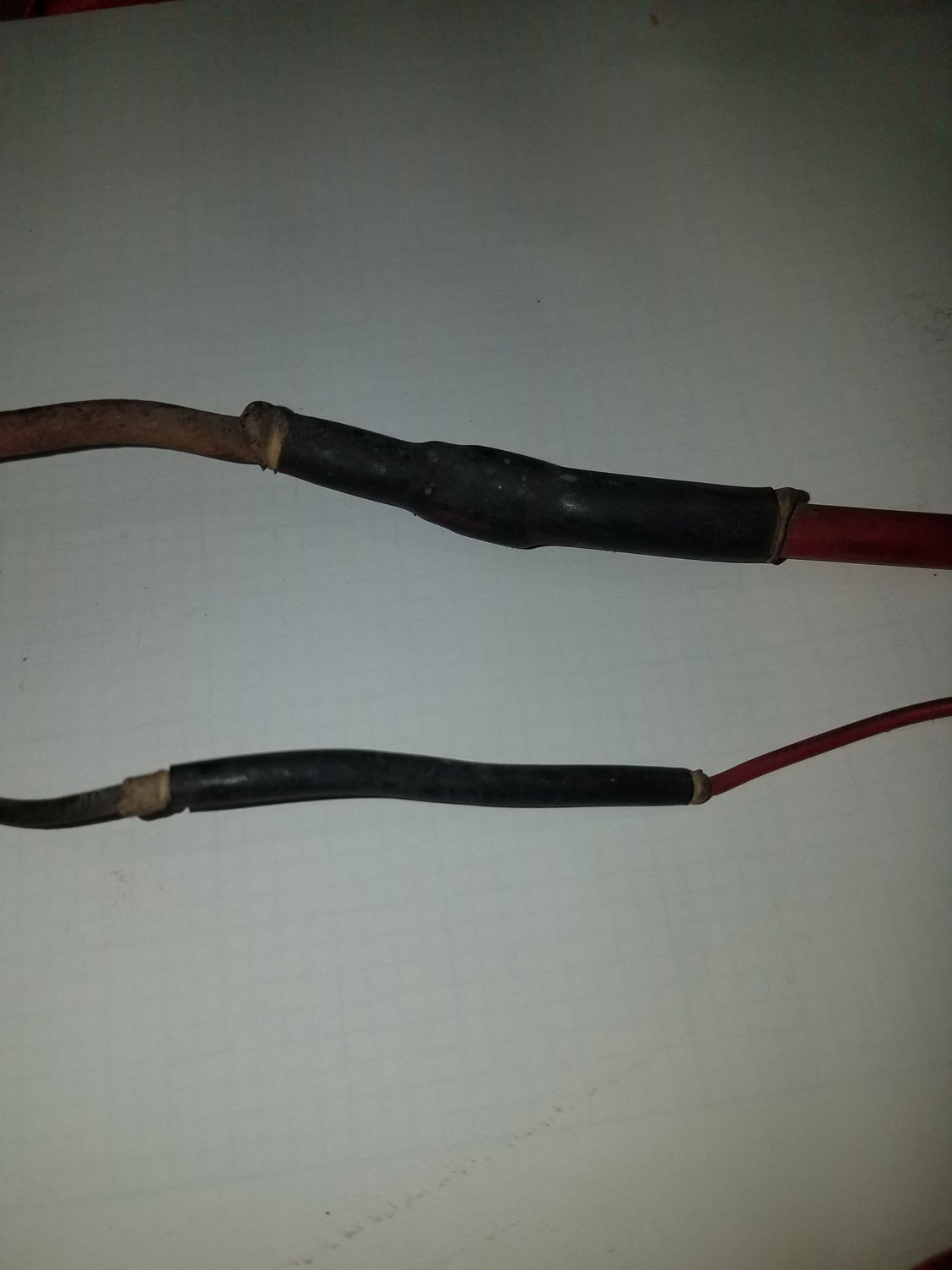

Old Jun 8, 2020 | 10:36 AM

Originally Posted by Big2Bird
Originally Posted by GordonR
How do you use your epoxy? This is new to me.
That picture is from a stock C5 harness I am repairing. There is a hard sealant under the shrink tube. I have no clue what it is, but I can see JB weld being okay for the application.
I imagine someone knows specifically what it is.

That heat shrink is glue lined to keep water out. If you don't have any of that shrink try brushing liquid tape on the splice and slide the heat shrink over it.
