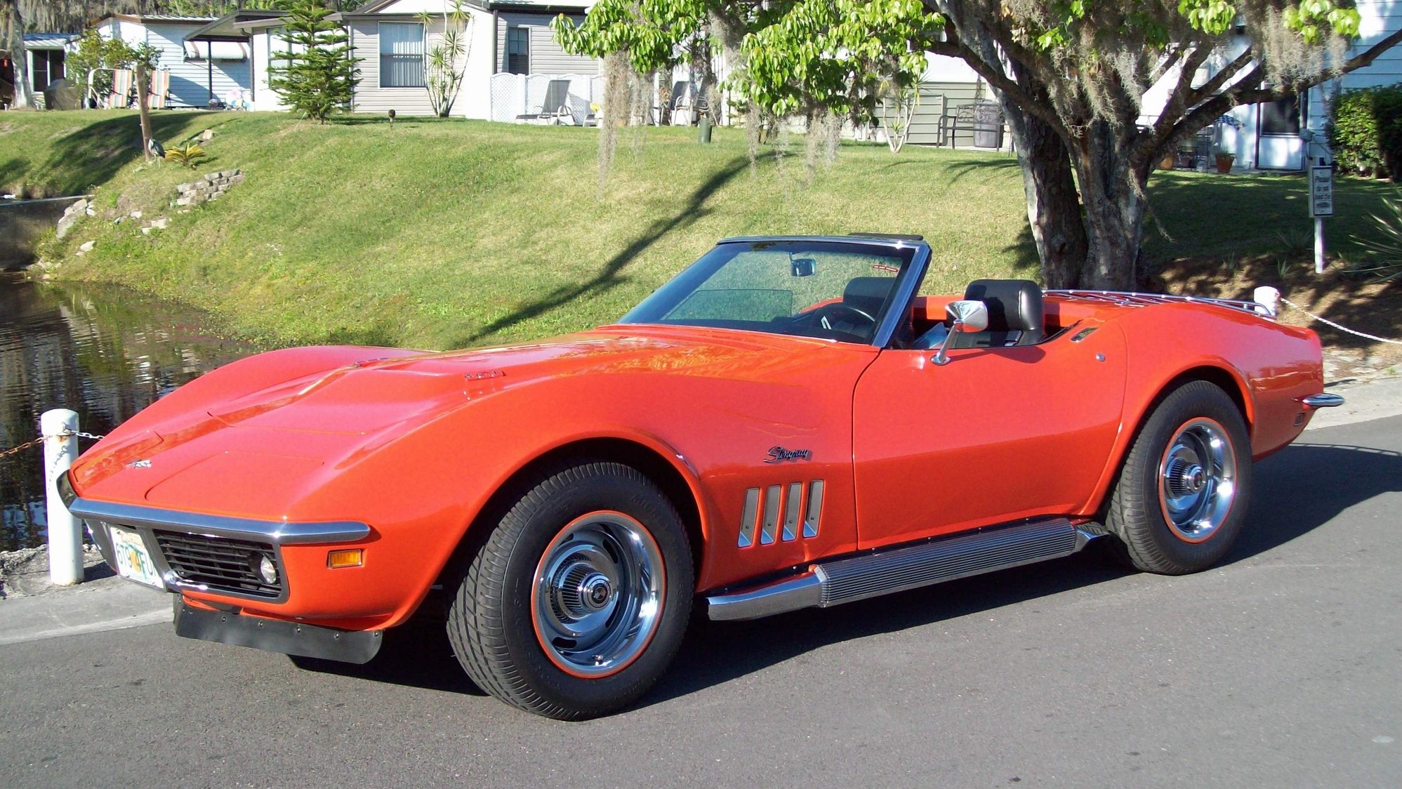

I run 245s front and 255s rear on my 69. I have shortened the TRW fiberglass spring by one inch each end to assure clearance. I am currently running Mickey Thomson street tires. I need to lower the frond end a bit now with all of the aluminum under the hood, the frond end is a little lighter. My car is very comfortable to drive and we use it for long trips when we can.
It does not have power steering so the wider the tires get on the front, the more effort it requires when slow speed maneuvering,

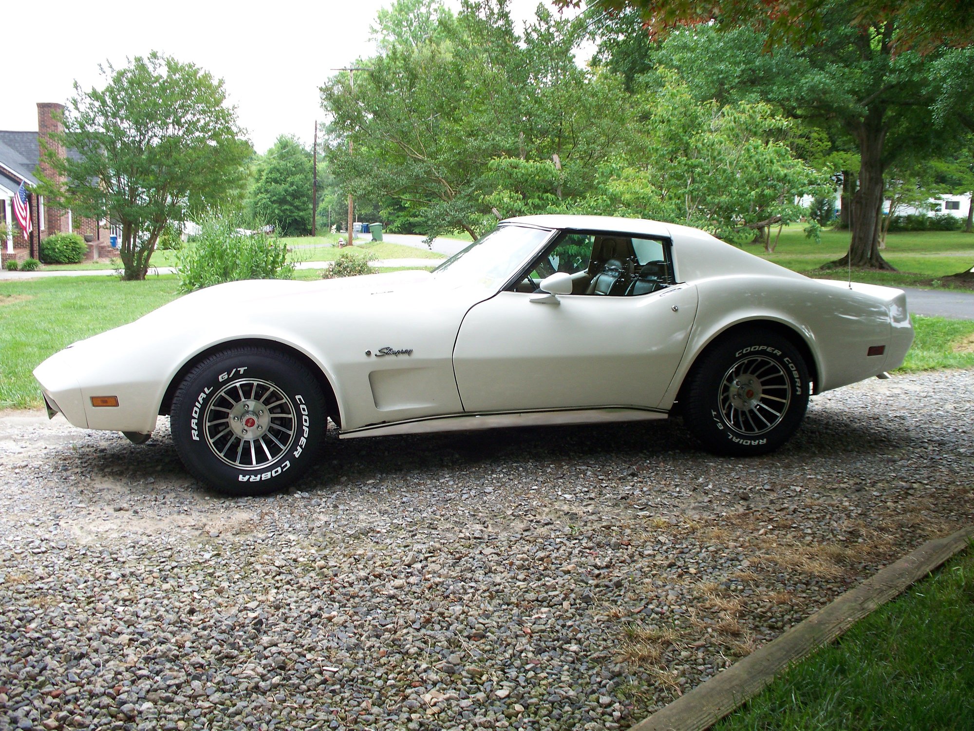

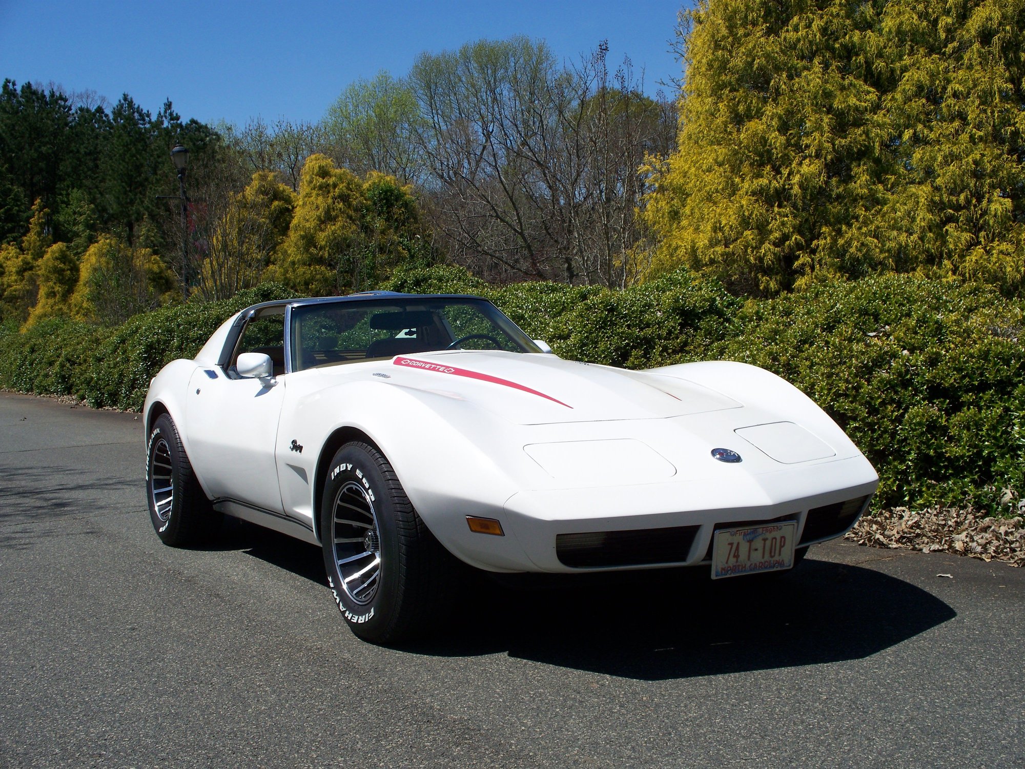

Just last week I bought 4 new Cooper tires.
I like my rims so I stayed with 235-70-15 upfront and 255-60-15 in the rear.
Firestone doesn't carry that size anymore and I like the RWL.
Before:
After:

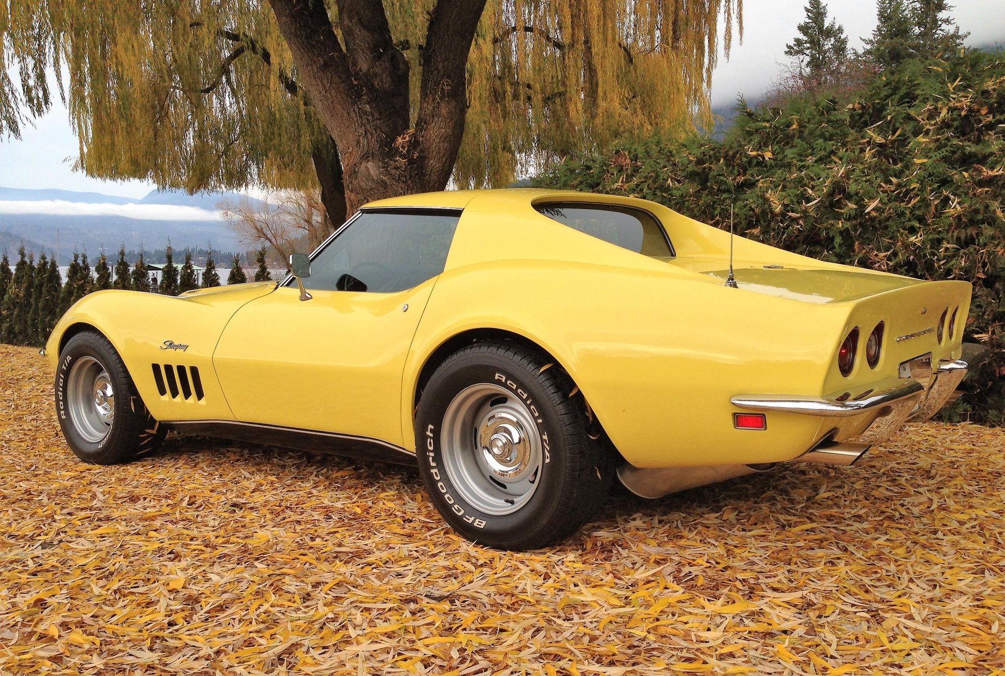

I run BFG 255's all the way around. All stock 69 suspension with no modifications and nothing rubs.
