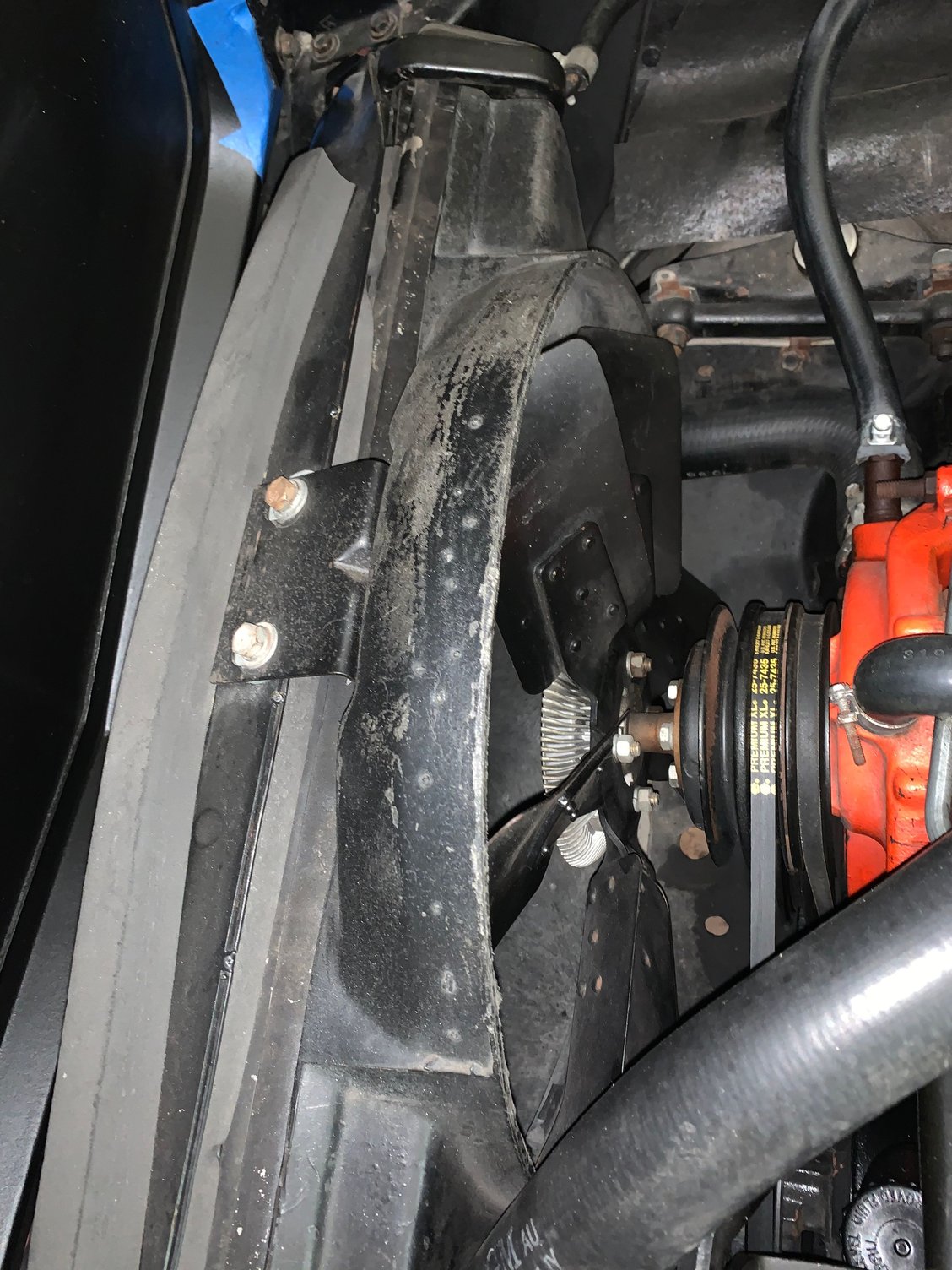

Has anyone used this product?
https://www.eastwood.com/ew-plastic-...k-aerosol.html
I would like to try and restore the fan shroud in my 69 coupe and wondering if this product or a similar one will work?

That looks like a matte black vinyl dye (paint with flex agent added). I would suggest that you clean the surfaces well with detergent/water, use ScotchBrite to scuff up the surface a bit (and remove any stuck-on crud), then wipe on a coat or two of polymer protectant (Nu-Vinyl, Formula 303, Meguiar's Protectant for plastics).
If that doesn't get the job done (and I think it will), go for the paint. Just be aware that all of that type glass/plastic came un-painted from the factory.
