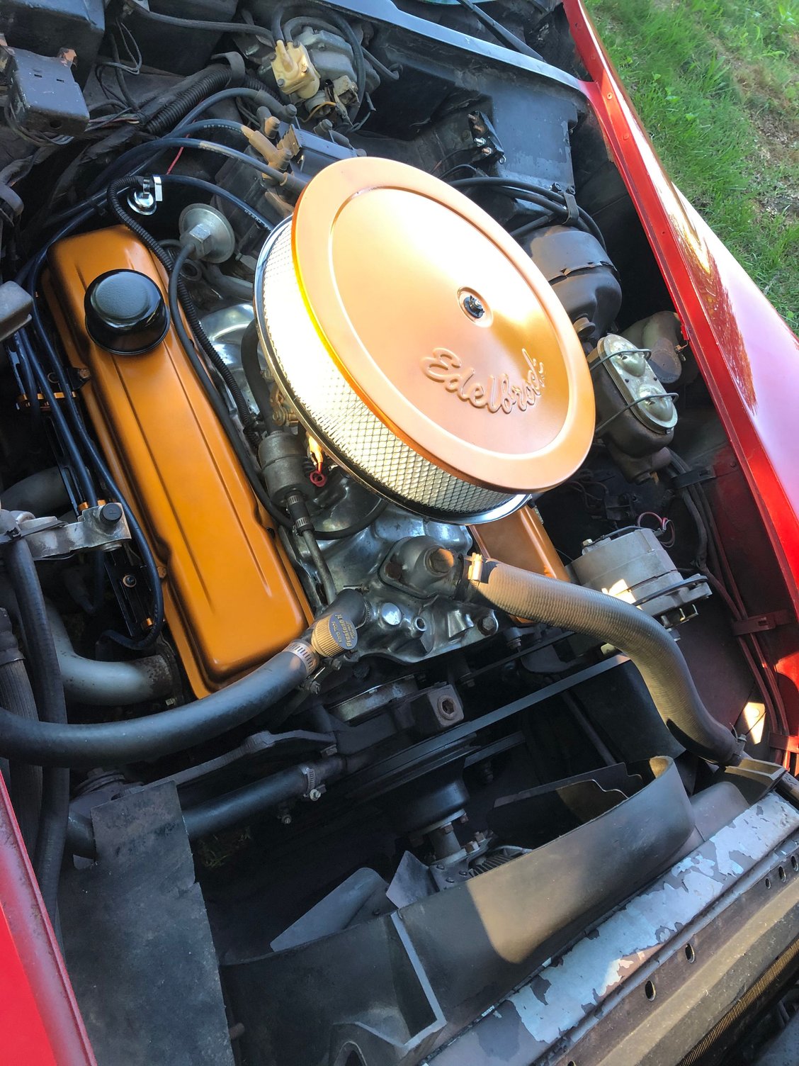

here is a pic, if you zoom in on the bottom left you can kinda see what I’m talking about.
I just painted my air filter housing and my valve covers. And they’re alittle darker in person.

Appears that you have an hei distributor so remember to ask for 1975 or later wires as the 74 and earlier engines had points distributors and different ignition wires.
