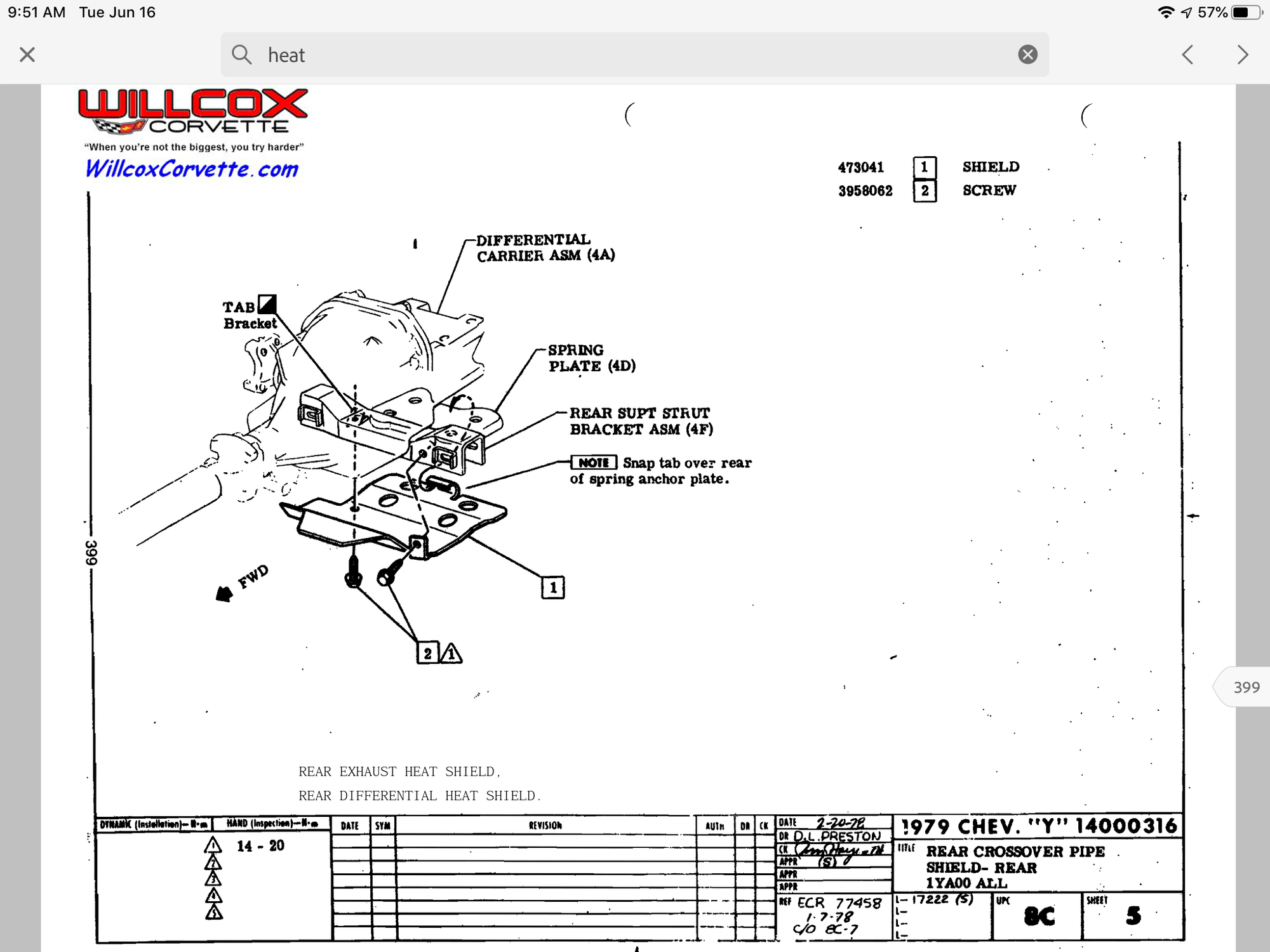

Old Jun 16, 2020 | 09:39 AM
HeadsU.P.'s Avatar
HeadsU.P.
Joined: Aug 2017
Posts: 8,336
Likes: 2,810
From: Cool Northern Michigan
I suppose its purpose would be to protect the rubber liners in between the leafs. And in a small way protects the strut bushings too.
Its a very disappointing piece of metal for a high-end car. But I guess it serves its purpose.

Heat shield..says exhaust 5/8 away..

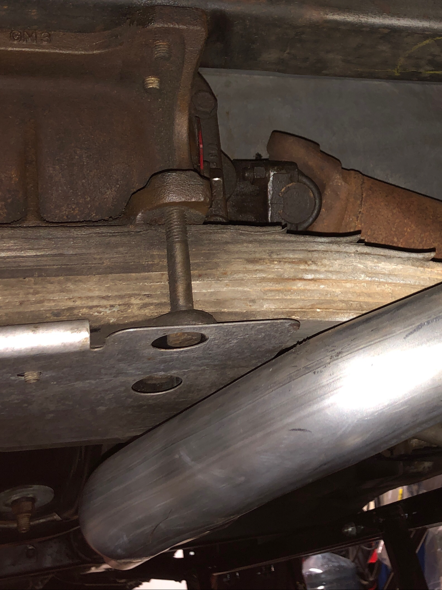

This is the shield on my car to protect the spring from the exhaust.
To Useless diff shield?
