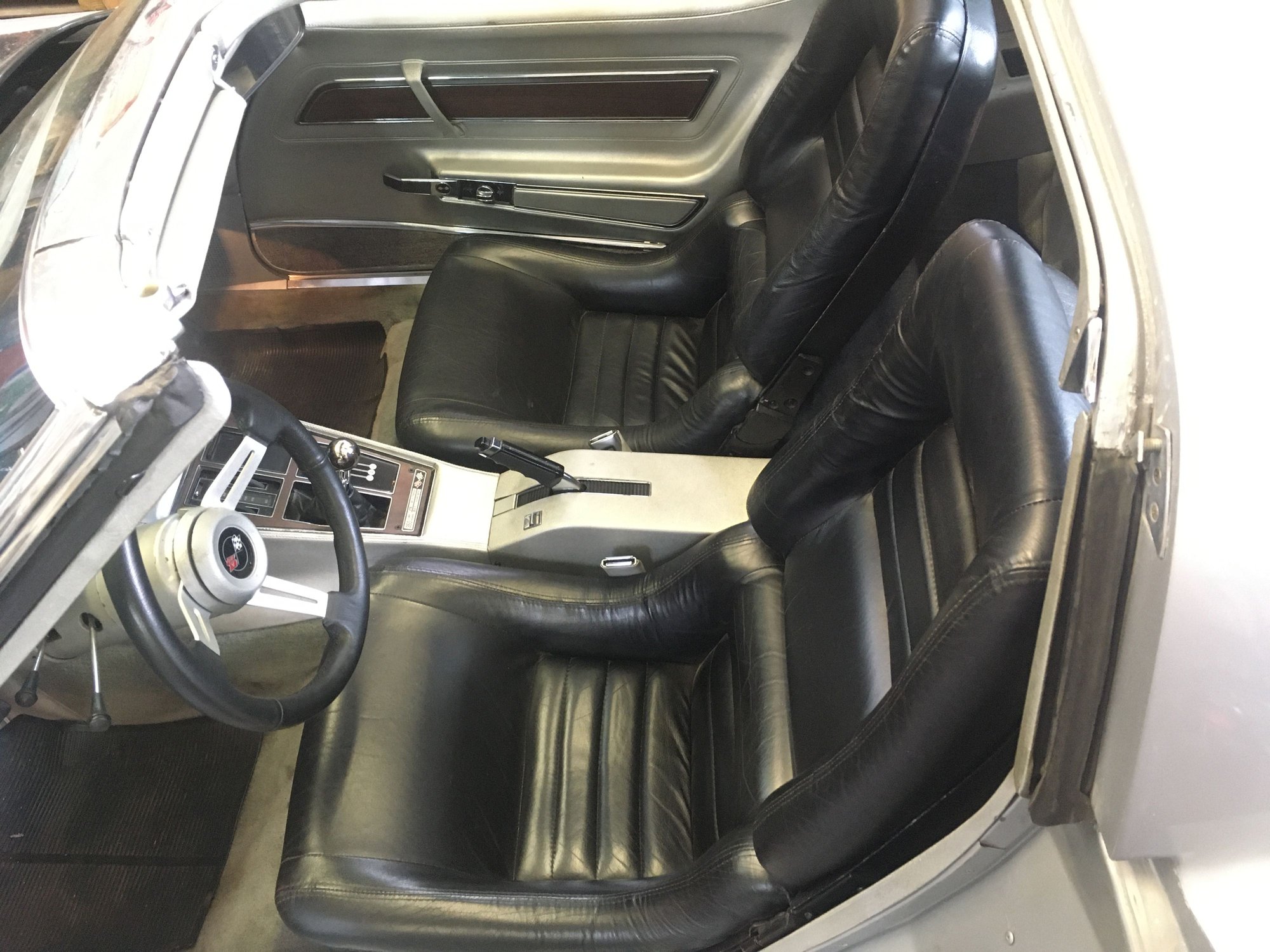

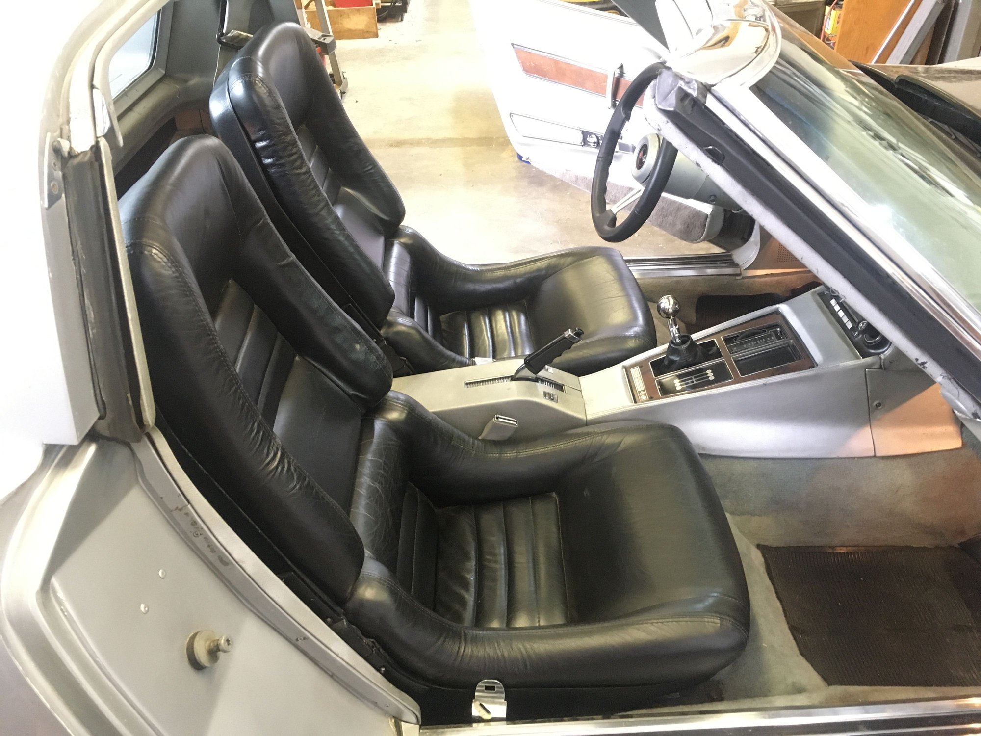

Finally! I have seats that I like. I hated the origInals and tried the Fiero swap. Those didn’t do it for me. Had an 81 for a short bit last year and loved the seats.
Found a redone set from a 79 that came with the rails. The 79 rails had been slightly modded at the rear pedestals so they could bolt into a 76. The seller felt they sat too high in his 76 so he went back to stock and sold me these.
I was also concerned about them being too high. I noticed the front feet of the 79 rails were noticeably taller than my 75 units. Of course using these rails would make them sit too high. Based on advice from others here I bolted my 75 rails to the clams. In order for the 75 rails to fit and still slide within the underside clam channels the front mounts needed spacers between the rails and the clam. I spaced it just enough (about 5/8”) so the rails would still operate.
Next challenge was how to make room so the 75 adjustment lever would fit and be operable without being jammed against the carpet. Hmmm. I stared at it a long time and wasn’t comfortable trimming that much of the bottom of the clam. Even if I hacked away and got room for the lever it was still going to foul on the carpet since I had the thinnest spacer possible to get my 75 rails to work on the 79 clams. So I got radical and just cut off the adjustment lever leaving about a 1” stub.
Then I drilled a small hole in the clam right above the stub. So now with the lower cushion removed one can insert a screwdriver in the hole and leverage off of it in order to move the lever/stub. Which is all moot for me since I don’t want them anywhere other than all the way back. The only time I’ll ever slide them is for removal/installation.
These babies are on the floor! When I was bolting them down you could feel/see the carpet compressing. There is just barely enough clearance that you can slide the seat with some effort. Hopefully I never lose anything under my seats since there is no chance of getting my hand under there lol.
Good lord getting those cushions clipped in was sheer pain. I learned new swear words.
Suddenly my tired original silver interior doesn’t look so bad lol.
