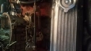

My 69 350/300hp engine came with a 73 carb (7043213). First question is, does this carb work well with this engine? After a drive, the garage always strongly smells of gas after I park it. Any thoughts on what could cause that strong gas smell afterwards? Secondly, is the throttle cable properly attached to the cable attachment bracket (doesn’t even look like proper 69-73 cable support bracket to me )? The AIM shows the cable flange sits in front of the hold down clamp, not behind it like I have. Any comments would be welcome. Just trying to get this straightened out..... Thanks.

The flange is in the proper location.
Gasoline smell is a leak.

MelWff.....Thanks for the info on the cable. I just didn’t think it looked like the AIM illustration, even tho I thought it was good, but just wanted to make sure. Regarding the gas smell, I think it comes from the engine area....there is no leaking gas anywhere as far as I can tell. I wonder if the carb is leaking gas into the manifold after it sits for a while?
