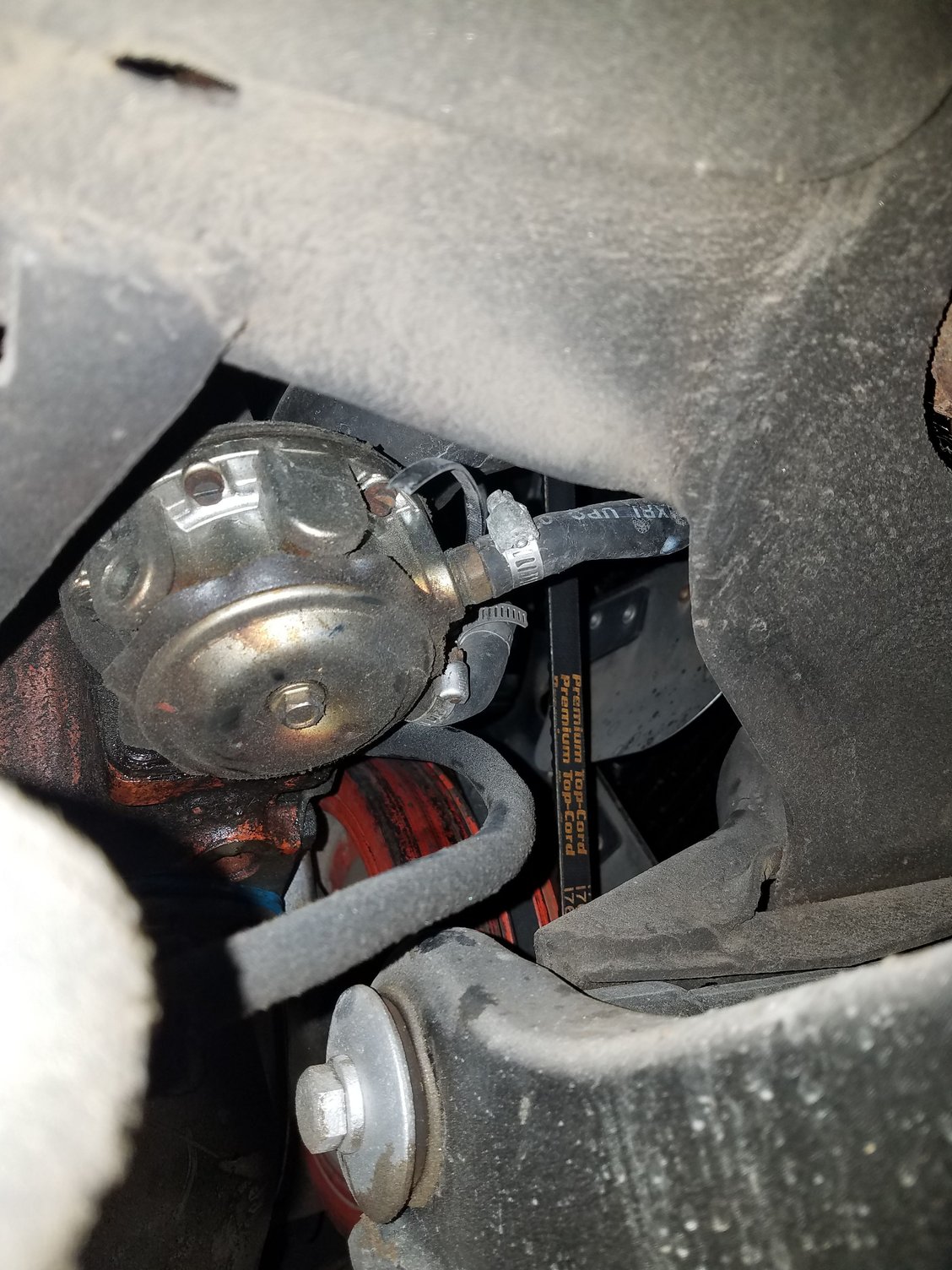

I have never seen a hard line going into a stock pump. Can you post a picture?

Hey Big2Bird, You are correct!!! There is a rubber hose on the inlet side. It is a molded hose coming from the hard line attached to the frame. Looks to be pretty new.
Sorry
