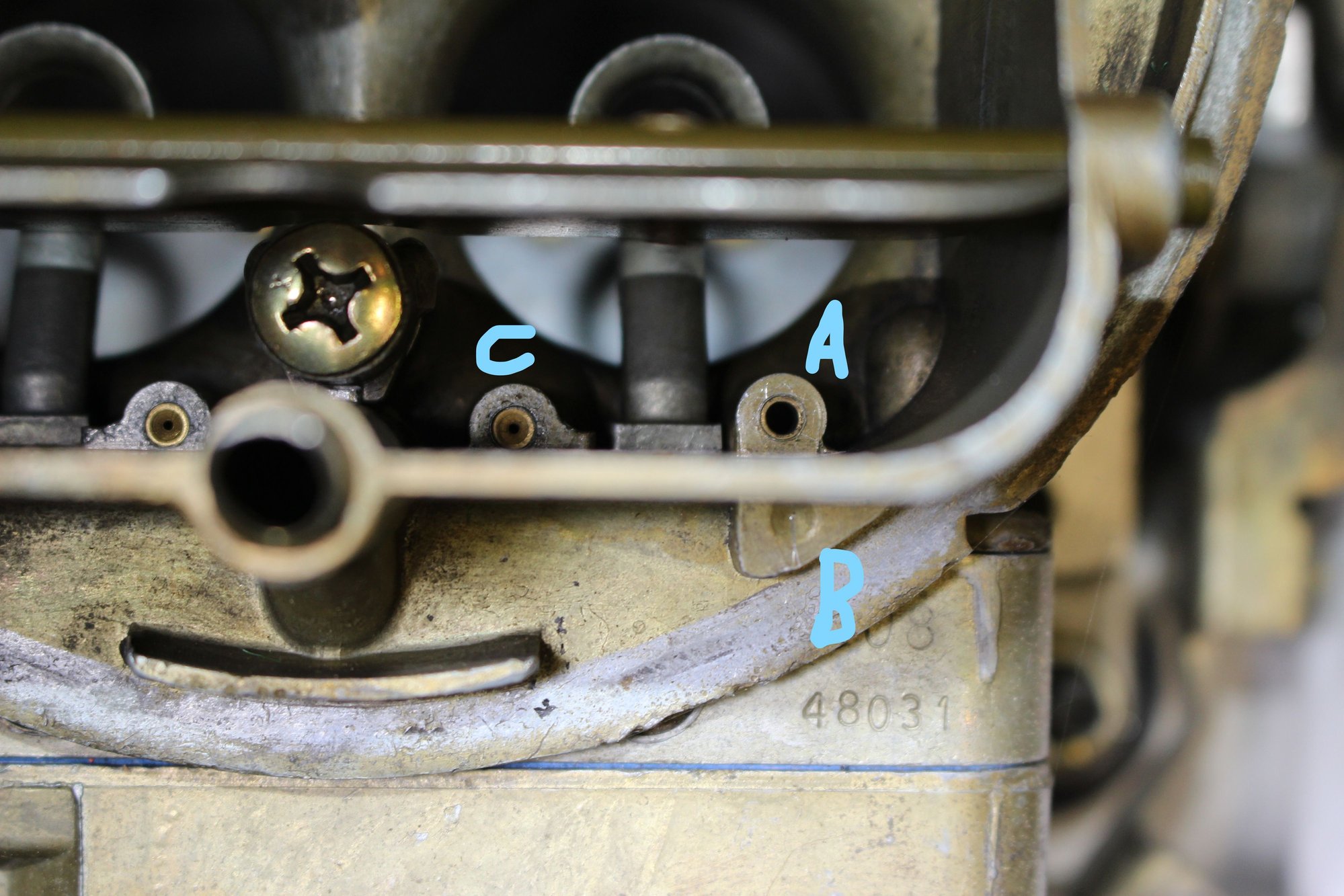

Second possibility:You could have the problem I had with my 70 LT-1 with the OEM Holley. After it was rebuilt and soaked the hidden adjustable air bleed screws moved, and the two idle mixture screws responded differently. They had to be uncovered and reset. Drove us crazy for a year til we found them. I finally would up sending it to Holley. Even the Holley techs could not find them until they checked the factory blue-prints. These screws are very rare. One was stripped and they had to supply me a new one. The screws are only on factory installed AIR pump equipped 70 & 71 Holleys. LT-1s, LS6s, & L78s. Not sure if it was ever used on anything else.
If the mixture screws do not respond the way you think they should, as above, or especially if they are uneven, dig further. Pics below.
Clue No. 1 This is my 1975 over the counter LS6 454 carb. It does not have the adjustable idle air bleeds. It was never factory installed. If you look closely at the indentation here, you can still see the machining marks from the pointed tool bit. A car with the factory adjustable air bleeds has a very tiny mixture screw installed in this spot, and it is sealed with a blob of "plumbers putty" I kid you not. If you look close on one of those you will see a small rounded indentation with no sharp point and no trace of machining marks
Same LS6 Holley with fixed air bleeds. C= High Speed air bleed. A=Idle and low speed air bleed B= spot where air bleed adjustment screw goes. This is a 454 engine so you can see how large of a diameter the idle air bleed is at "A" . The brass bushing is very thin. IIRC a normal Holley for a 350 has a smaller sized orifice in this spot. However Clue No. 2 for the adjustable idle air bleeds is NO ORIFICE AT ALL IN THIS SPOT! So how does that carb control idle air? The area at B is factory drilled out and tapped into the idle air bleed orifice channel. Something resembling a 50% sized idle mixture screw is inserted, it is brass, has a ROUNDED end, not pointed, because it is for air, and a small eyeglass sized screwdriver slot for adjustment. It's use was for fine tuning the emission levels on the AIR pumped equipped solid lifter engines. They are normally never seen because the plumbers putty both covers them and locks the screw into position.
The problem is that soaking the carbs during cleaning/rebuilding dries out the plumbers putty, and it becomes cracked or loose, and the screw starts moving around and screwing up your carb calibrations!!!!
I sold my LT-1 15 years ago so I have no pics.
SOMEONE WITH A 1970-71-72 LT-1 SHOULD TAKE PICTURES OF THEIR CARB IN THESE TWO SPOTS AND UPLOAD THEM HERE TO COMPARE WITH MINE AND HELP DOCUMENT THIS PITA ISSUE. I AM SURE IT WILL HELP SOMEONE.
These screws drove me nuts. The car would not idle well or run well. I almost trashed the OEM carb over this issue!
