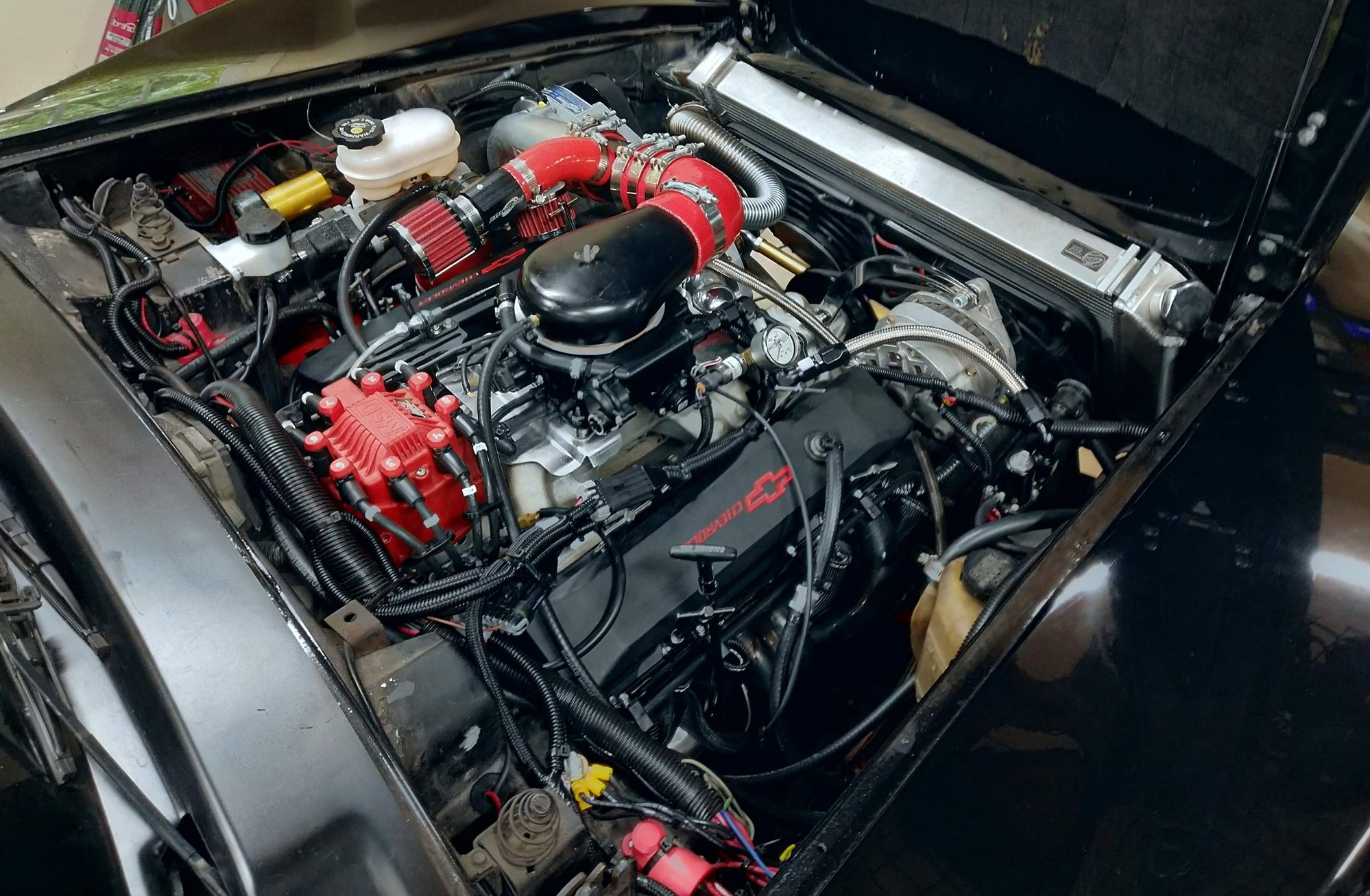

Mines is "hidden" under the pass side fender, floating on aluminum extensions. You can kinda see it here in the background

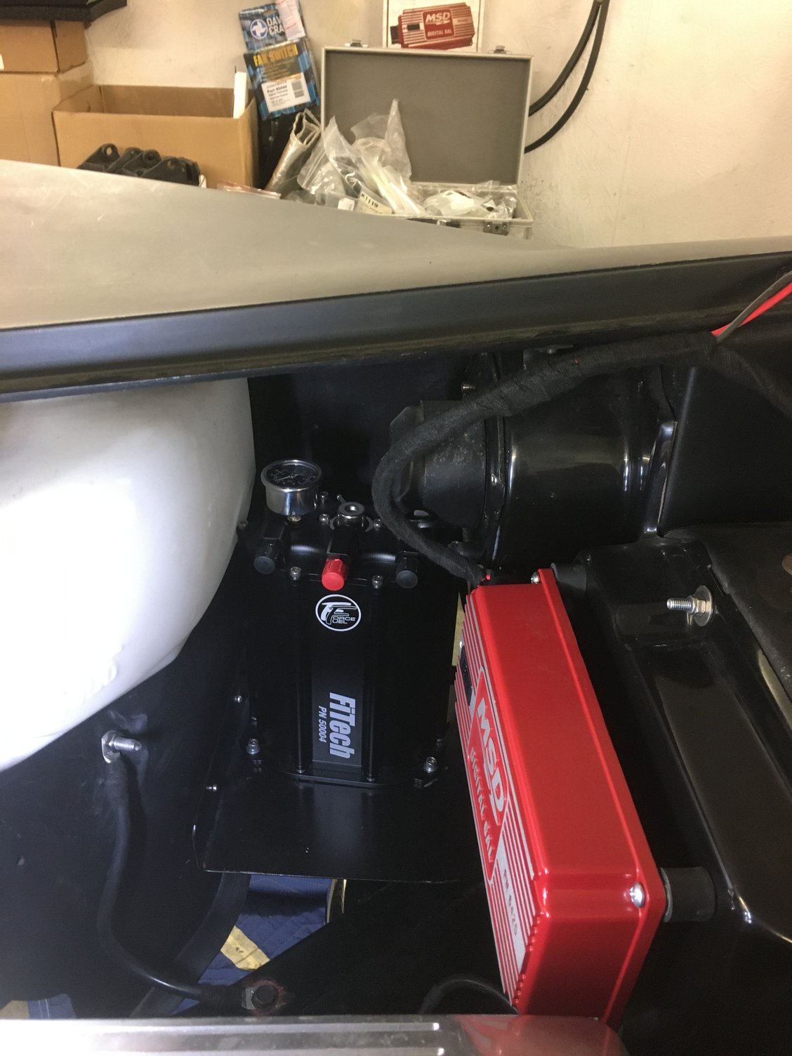

mines in the passenger compartment behind the passenger dash pad. THeres lots of room back there since i dont have a glove compartment

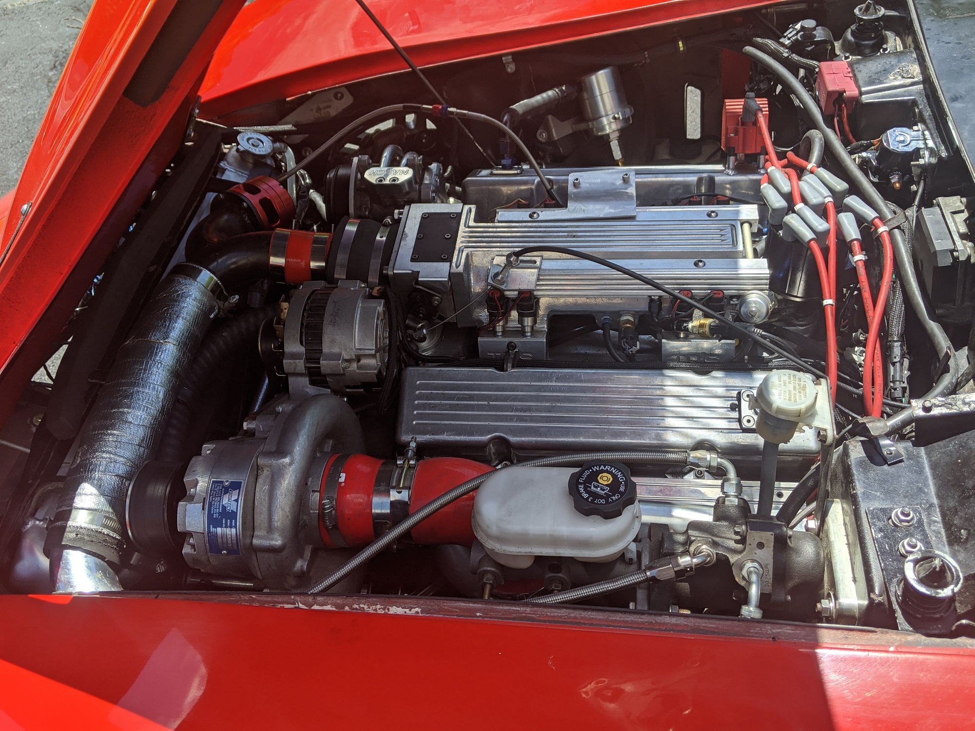

Not a good pic (I'm too lazy to go out and take a pic), but here's a crop of where I mounted my 6AL box at on my '72 using the rubber vibration feet.
The fender vent is below it so there is air movement to keep it cool.
It's been bullet proof for over 10 years. Be sure to follow MSD's instructions and power it straight off the battery.
I ran the hvy gauge wire down the trans tunnel up into the battery box.

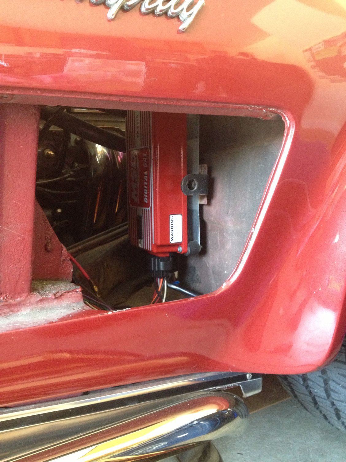

Default Behind front bumper
