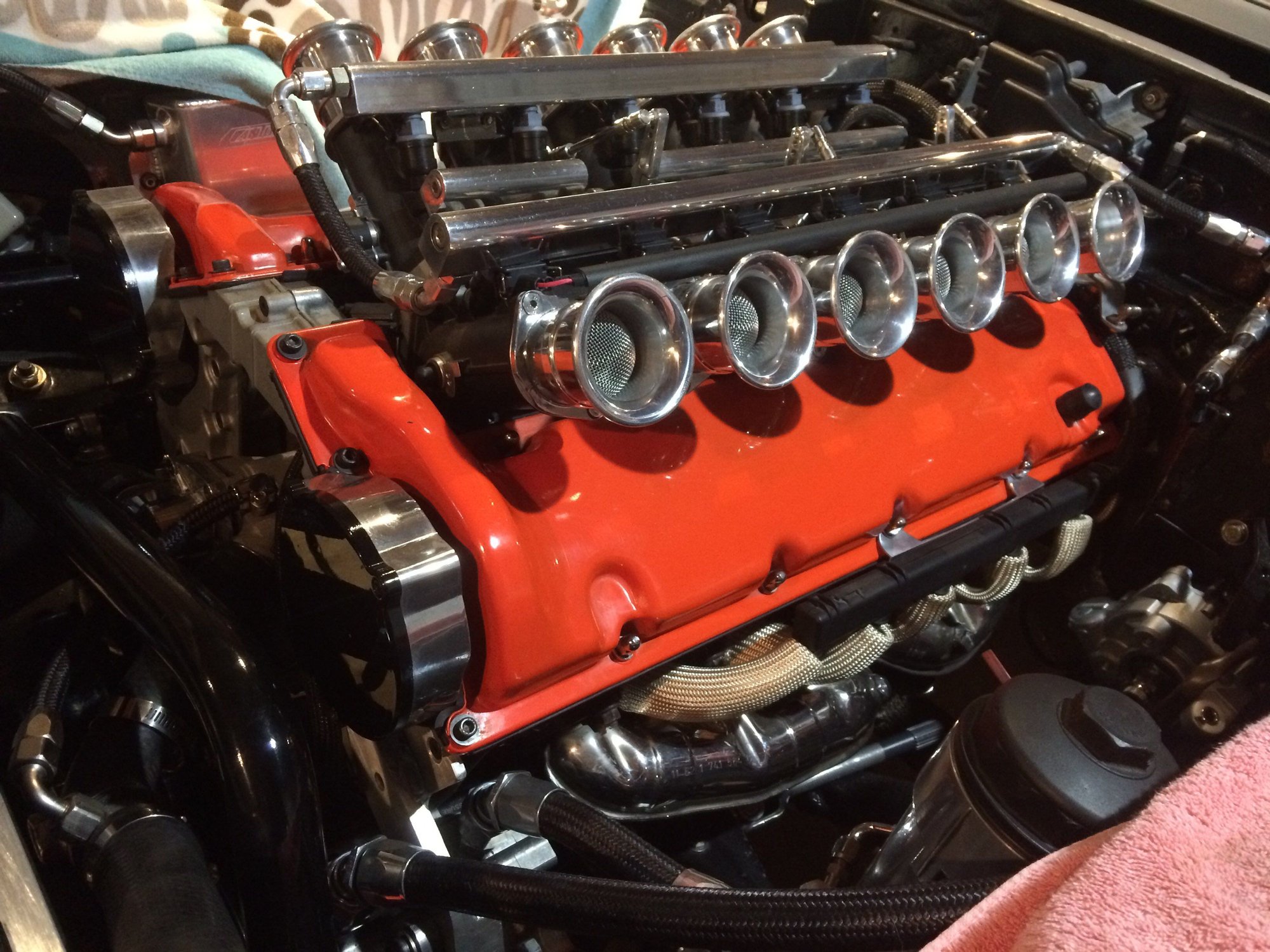

It will look exactly like this....rebuilt and painted by Lars a couple yrs ago. Looks and performs as good today as it did then !!
